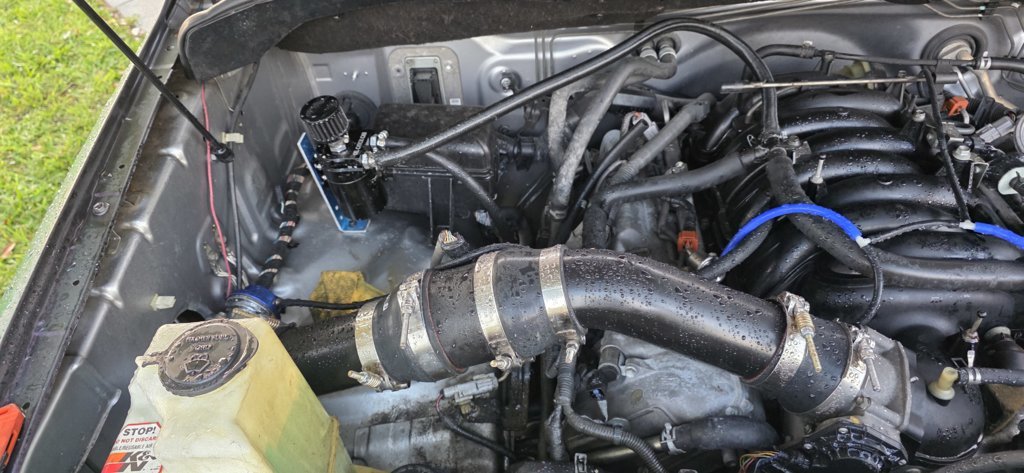

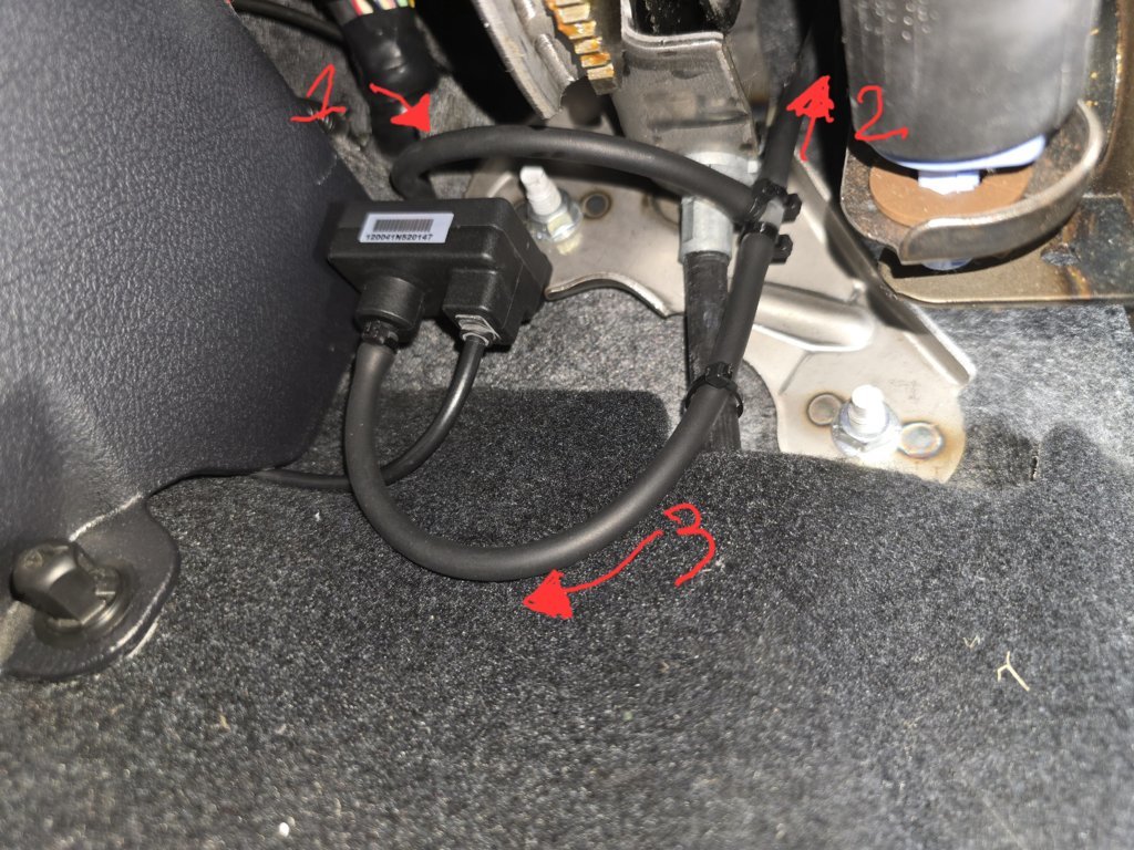

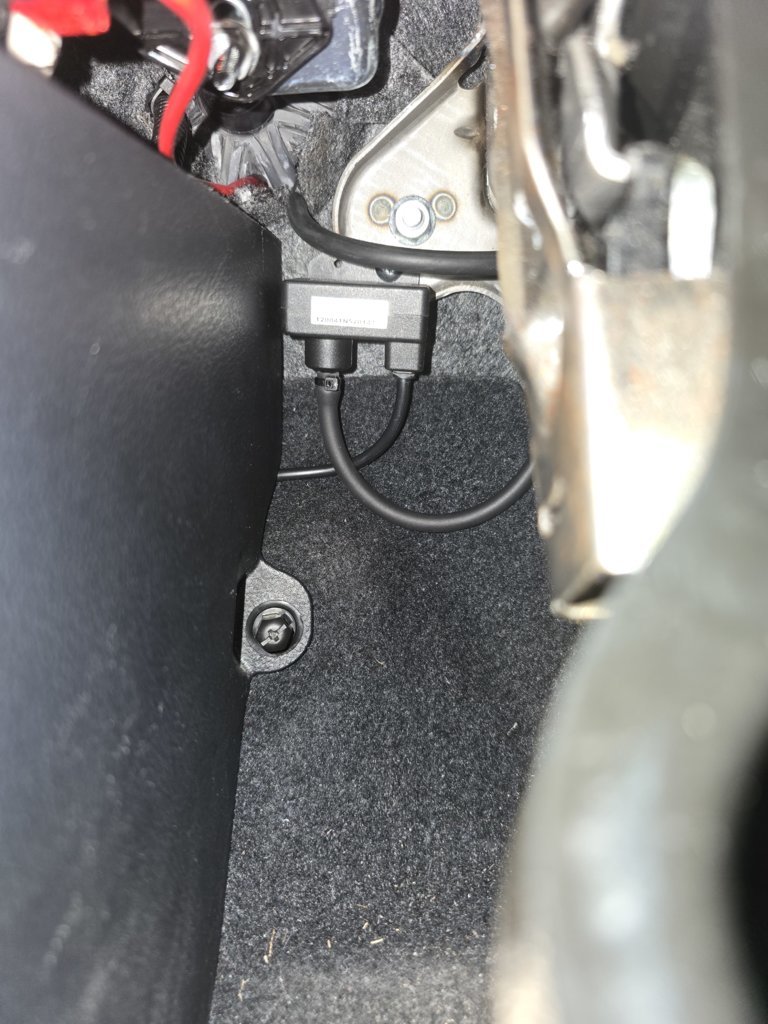

    After almost 2 hrs. looking for a good spot for the MAF sensor:
    1 from engine bay
    2 to AEM W/M controller
    3 to MAF sensor
  13. Aug 8, 2025 at 5:18 PM
    #2443
    centex
    centex New Member
    Nov 27, 2022
    #87464
    2,225
    I put mine in the glovebox next to the water meth controller.

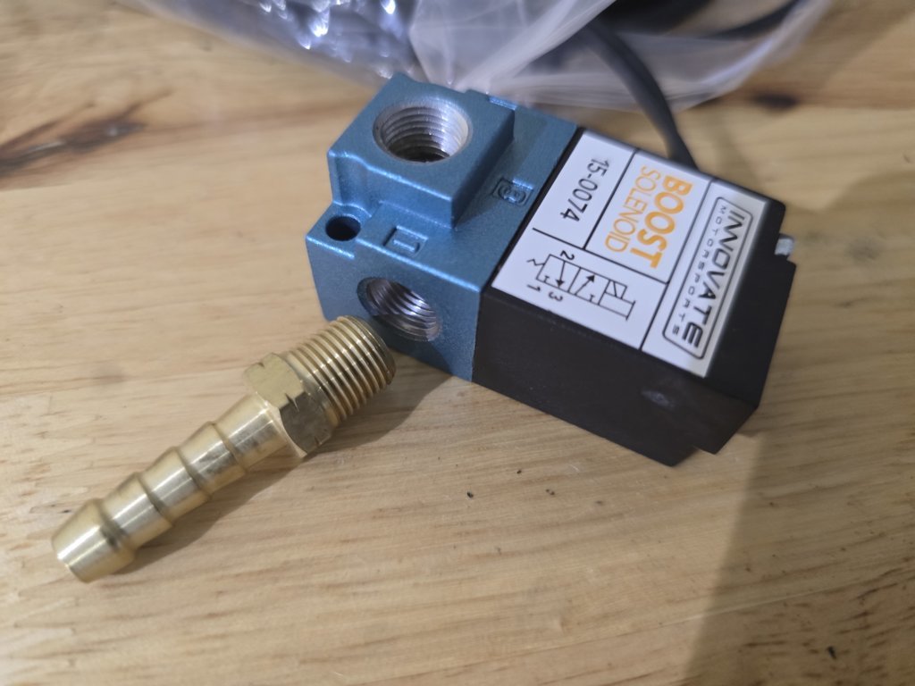

    What thread sealant is good for solenoid fittings?
    HulkSmurf14 likes this.
  15. Aug 8, 2025 at 7:23 PM
    #2445
    centex
    centex New Member
    Nov 27, 2022
    #87464
    2,225
    Pipe tape. They are npt and shouldn’t need any but better safe than sorry.
