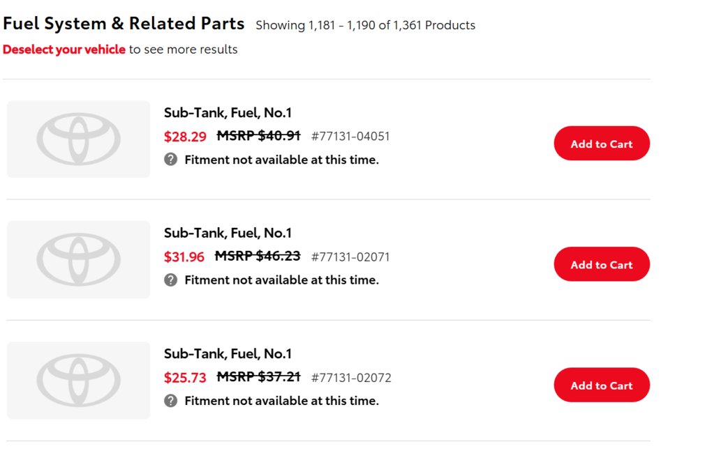

    for discussion:
    I believe we are talking about sub tank sub-assembly No 1, based on threads I've seen and Prospeed's install instructions. If all we need is the lower basket from a FFV, then I think it is going to be one of these three. I'm going to call Fred Anderson to discuss.
    Edit: Photo of part numbers deleted. Baskets are not sold separately from Toyota.

    Per Fred Anderson, baskets are not sold individually from Toyota. They confirmed we would need 77020-0C170

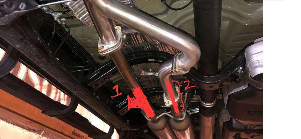

    I am asking because replacing the actual muffler with a shorter one is one of the options I was considering to make space for the cutout valves.
    Got the following pic. from the installation guide to see the final setup and added a draw of where I want to add the cutout valves.
    In #2 there is no space sufficient without eliminating the flange connection.
    In summary the options are:
    1. Replace the flange connection by the cutout valve. Not sure if this is a good practice.
    2. Mod the curved section. Making it shorter will result in a longer flat pipe area.
    3. Replace the muffler by a shorter muffler. If I am not wrong the actual is 23 in. long. But want to keep the same or similar sound.

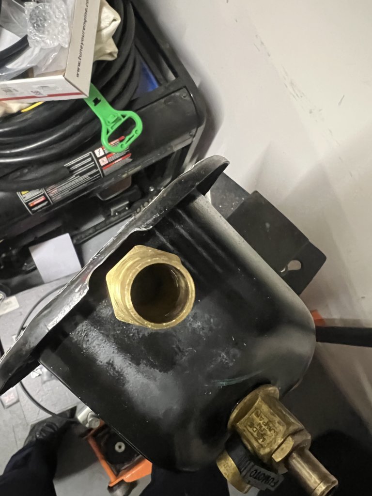

    Where are you guys routing the oil returns line too? Oil pan seems stupid small to do it there.
  23. Aug 6, 2025 at 12:52 PM
    #2423
    bflooks
    bflooks [OP] New Member
    May 9, 2020
    #46273
    2,288
    Metrowest MA
    to the top of the pan. it's a tight fit like everything else, but it works.

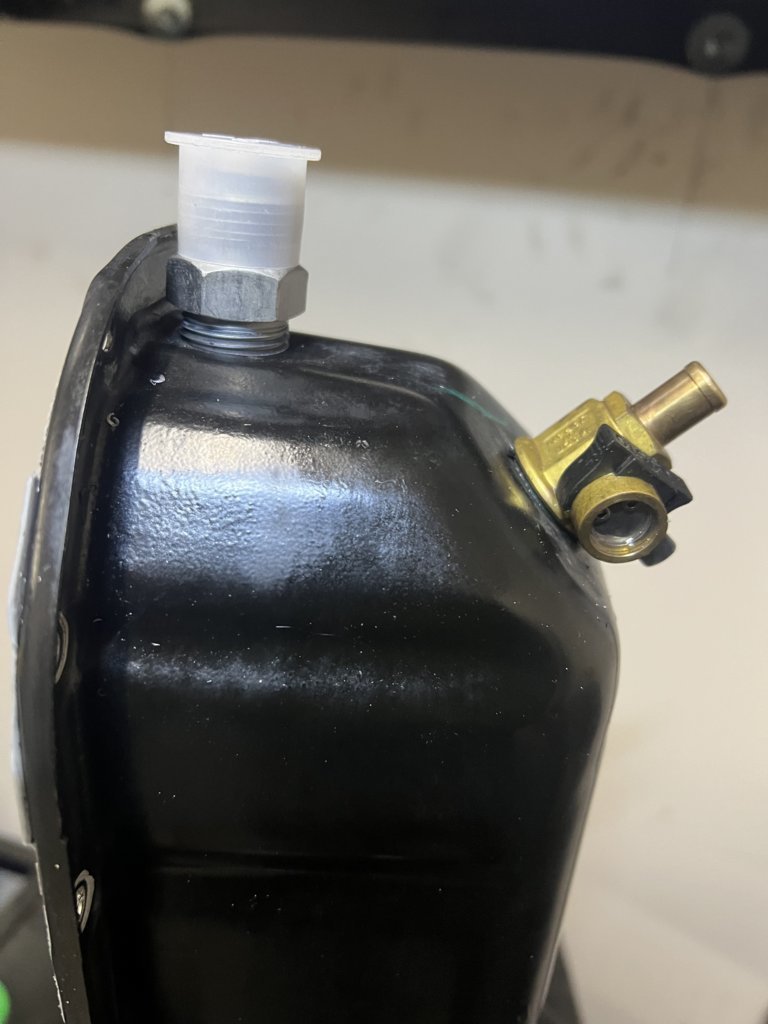

    In the very begining, after reading in few places that the oil return should be above the oil level, I was considering to tap the upper oil pan in the following spot:
    Maybe I am wrong, but after reading different opinions looks like it really depends on how high is the turbo relative to the oil level. In our case the turbo is really high and that probably helps.
    I decided to tap the lower oil pan as Jesse, Bflooks, and Centex did, after all the combined miles of testing it has without issues.
