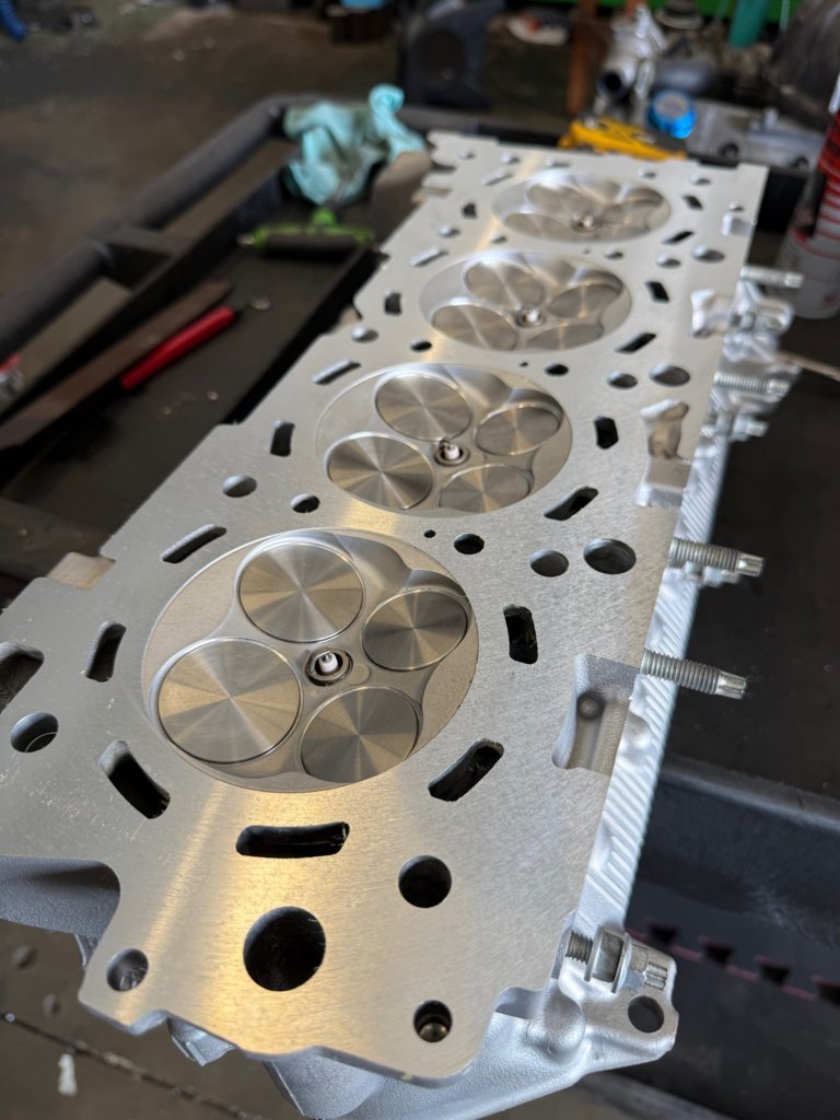

    #2371
    bflooks
    bflooks [OP] New Member
    May 9, 2020
    #46273
    2,363
    Metrowest MA
    Good call! Done.

    Calling truck porn!!! :crapstorm::crapstorm:
    bflooks[QUOTED][OP] likes this.

    But in all honestly, that's the cleanest/shiny block I have seen to date.... I mean, it is so naked.....lol
    So what WHP are you aim for with this new block? Stage 3 750 WHP?

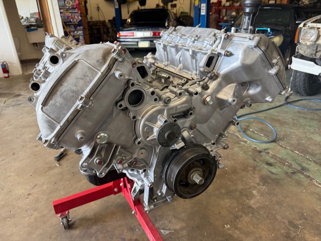

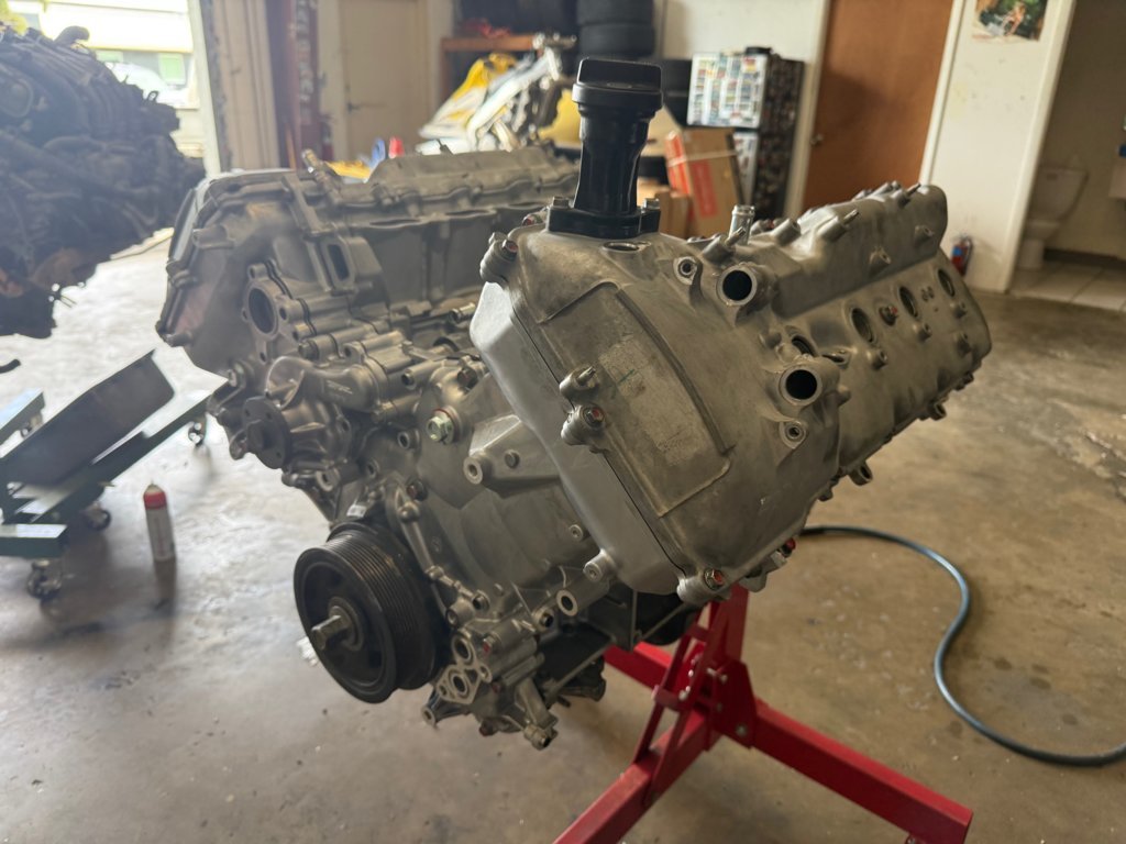

  10. Jul 18, 2025 at 10:53 AM
    #2380
    bflooks
    May 9, 2020
    #46273
    2,363
    Metrowest MA

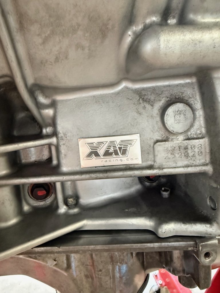

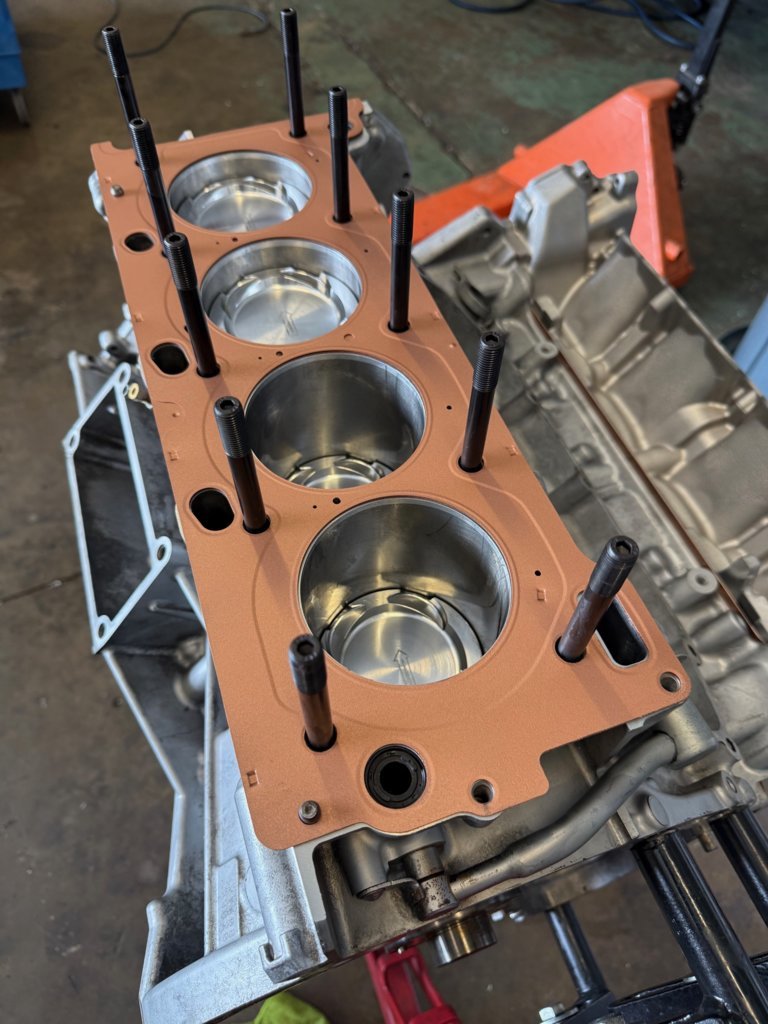

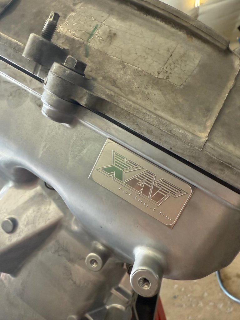

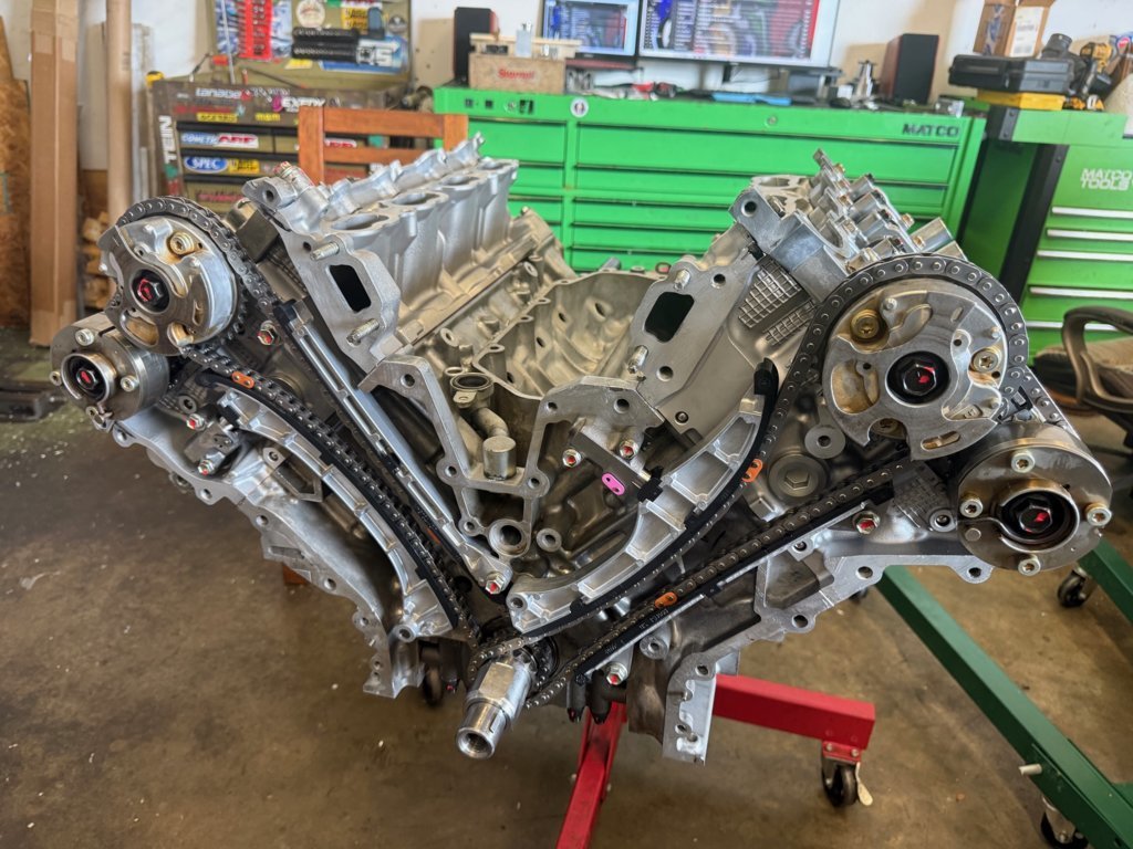

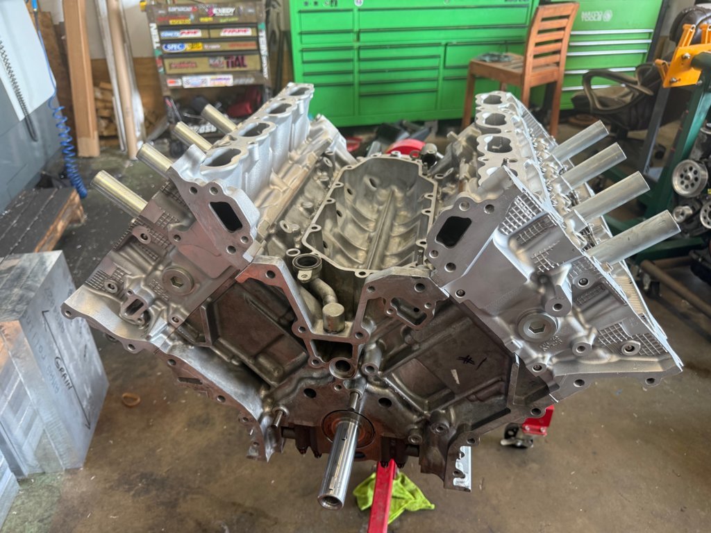

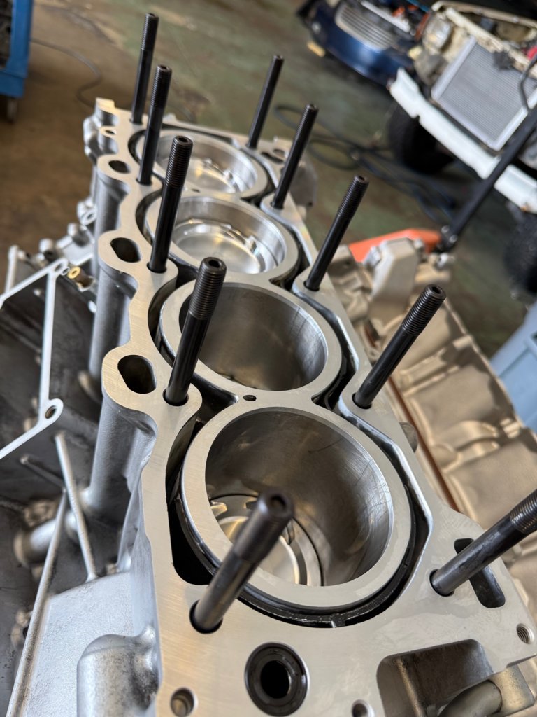

    All buttoned up, getting ready for shipping.

    So the trans is next....
    Looks like whatever you got stock is the frame, and body paint, right? RIGHT?!
    I honestly think if we hit 750-800 WHP with original trans I would be happy, I mean, this crap is what? 6000 lbs+ heavy, it's hurling a brick through the most un-aerodynamic shit ever.....
    I tow maybe once or twice a year, and possibly 200 miles round trip (I know, baby steps compared to you) so most of that WHP will be playing on the highways....
    Wife had a minor accident a few weeks back, she called me about it, and I was racing to her (she had the oldest with her in the car) and even though I was hitting 106 on the highway, I wanted it to go faster, I was at least good 30 mins away and was able to make in under 20. While being worried (it end up being minor fender body bender, but still, you don't know until you see it), having that full throttle V8 sing is something pretty sweet....
    Maybe I should not do FI.... that's just too much fun..... Wife did mention a sports car, we will see.... that one I have no issue going all the way for 1000+ WHP.....:rofl:

    It's kind of wild, actually. Even with the cost of the turbo kit, the engine, and likely the trans, I'll be barely breaking even with the cost of a pretty mild Supra, which I guess would be fun in itself, it another garage bay, it's more insurance, and it's just not as cool as a sleeper that can work and play as hard as I want it to. It's a fantastic platform.
