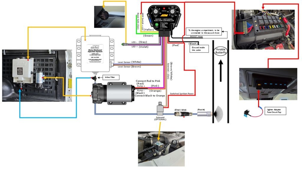

    Quick update:
    The water/meth kit is installed and tested. Ready to be integrated with the turbo kit. This is the diagram from the installation guide, but I've added images of the components and wiring connections in my current setup. Thanks @bflooks for the suggestion to create this diagram.
    Also, here's a video in case anyone wants to see all the installation details. I hope this helps!

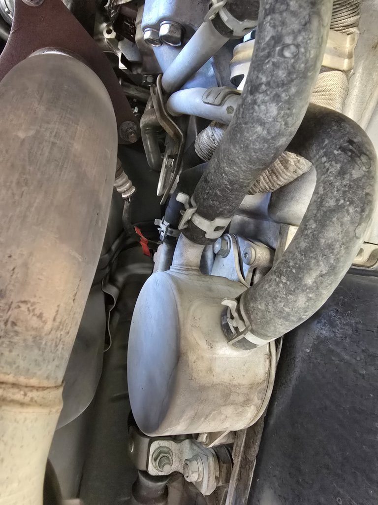

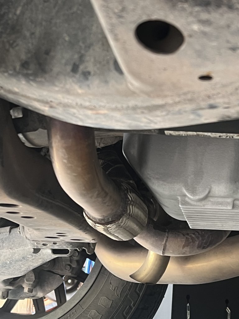

    Can’t remember if it’s been posted or not but the crossover pipe clears the deeper transmission pan with ease.

    I had done some rough measurements when my pan arrived, but seeing is believing! Probably worthy of a wrap with the heat mat across that section of crossover.

    There’s a solid inch of air gap. I’m not worried about it.

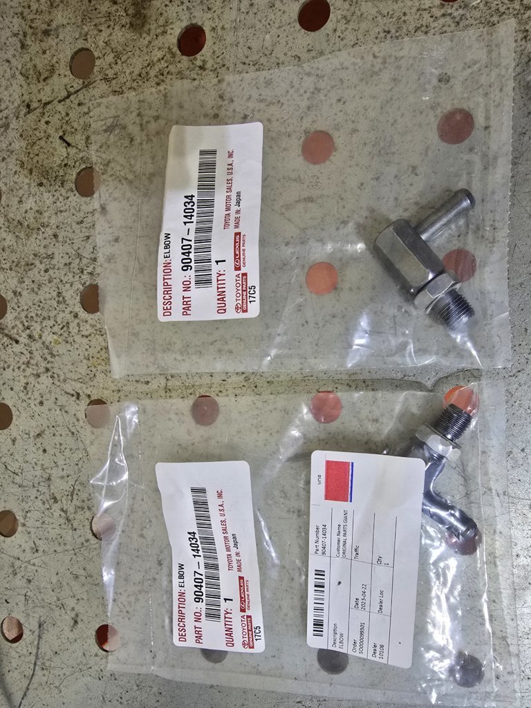

    Waiting for the O-rings to remove/bypass the trans. warming puck / thermostat.

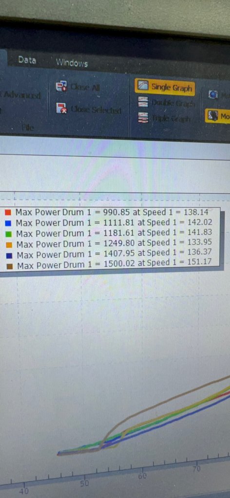

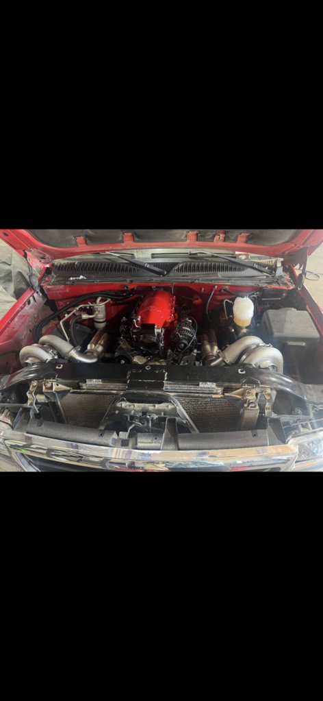

    Not a tundra but still a lot of funzies!!!
    06 4x4 single cab with twin 78s (big)!!!!
    1500 HP!! Insanity!!!
    427 Dart Block LS

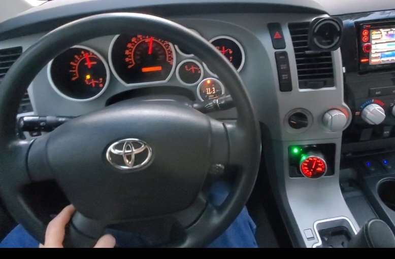

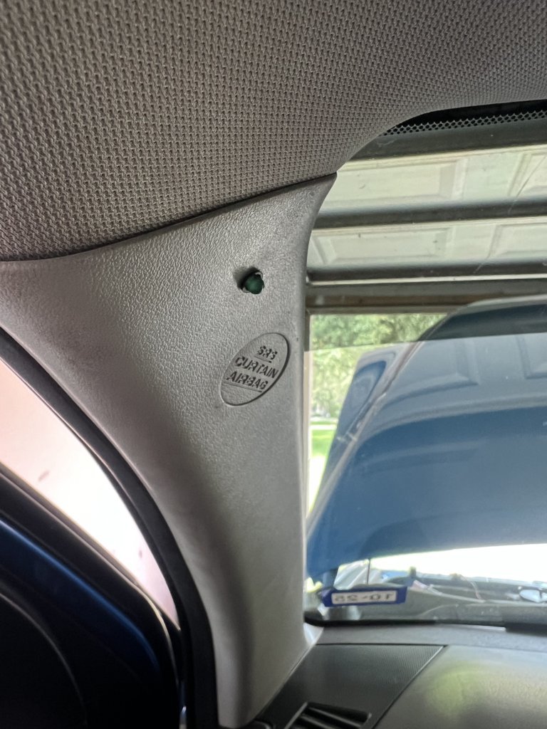

    Finally mounted the light for my meth system.
    TurboKits, M3Tundra-JK and Jego like this.
  18. Jun 9, 2025 at 10:06 AM
    #2238
    Jego
    Jego New Member
    Jan 17, 2021
    #57757
    354
    Orlando
    PR
    2018 Tundra 1794
    Nice. Simple, clean, and easy to see while driving.
    Tripleconpanna likes this.
  19. Jun 9, 2025 at 10:20 AM
    #2239
    centex
    centex New Member
    Nov 27, 2022
    #87464
    2,226
    We’ll see. I may swap it out for a red light instead of the green. Something brighter.

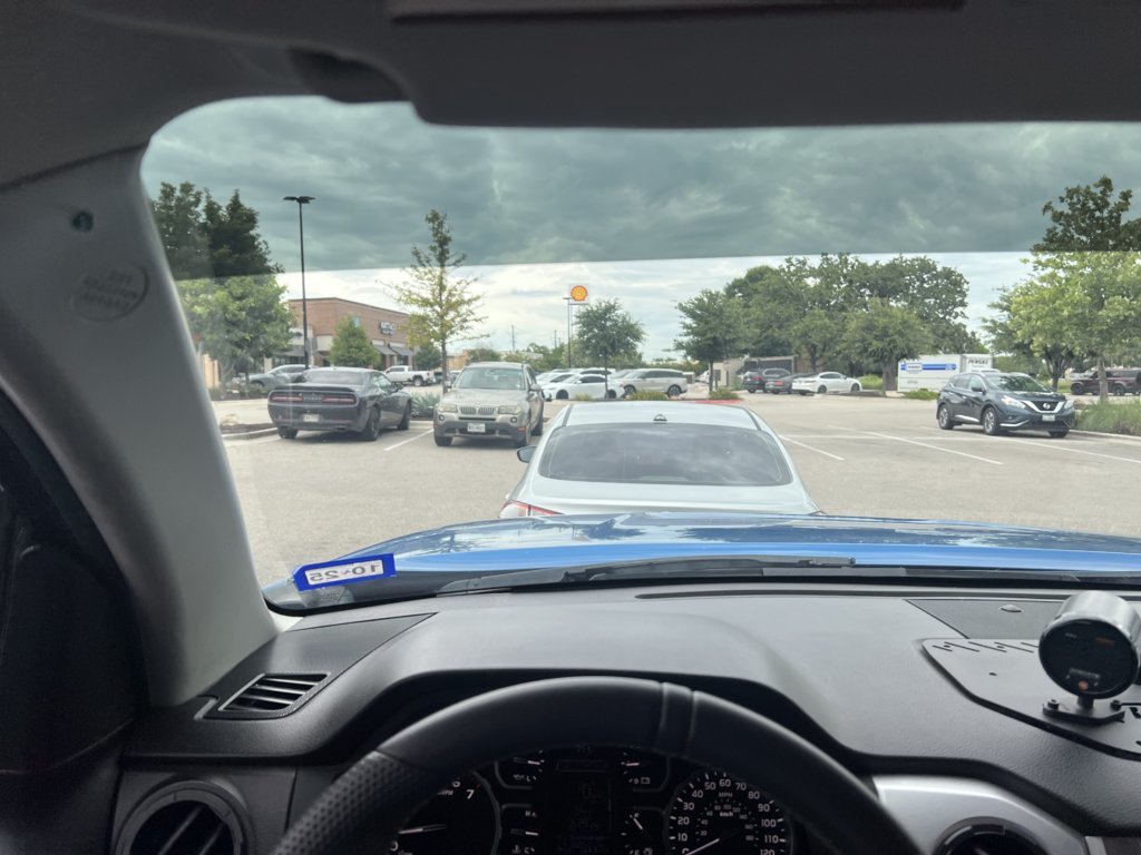

    My biggest issue so far with the LED has been becoming desensitized to it. I wish there was a way to have an audible alarm instead for the critical sounds (such as low fluid level) which would have probably saved my ass. With it constantly being on, off, and/or flashing, it is almost like the BSM relocation for the tow mirrors. Curious if you notice the same thing

    Haven't noticed it but it's always been out of my field of vision.

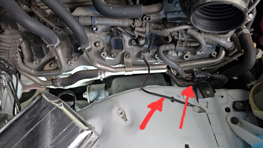

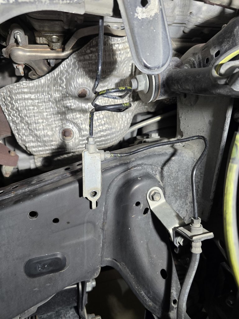

    • ABS Harness Relocation
    • Engine GND Cable Relocation
    • More wires relocation
    • Brake line relocation (WIP) Mental block trying to figure out the best approach lol. Thanks to @bflooks, @centex, and @TurboKits for the support on this matter.
    • Uploaded a new video about the ABS harness relocation:
    https://youtu.be/W4-piJxkdSM
    Wires relocation:
    Before:
    After:
    Brake line
    Before:
    After: WIP

    I have my green led just below my steering wheel. It's bright enough to let me know what's going on. You could wire in a buzzer or some tone that's triggered by the light too.

    If I get bored enough I’m gonna print out a gauge holder for the scg1 with a spot for the LED so they are both in one spot. But for right now it’s not bad. LED on my left and SCG on my right.

    Is your wideband just flush mounted to the cluster surround? There's room behind there for that? I like that!!

    It's not flush. I have an Autometer 15 degree ring on painted to match. It's an older AEM failsafe afr/boost gauge. Just enough room for mount/ wiring in back. Some newer gauges are thin mount.
