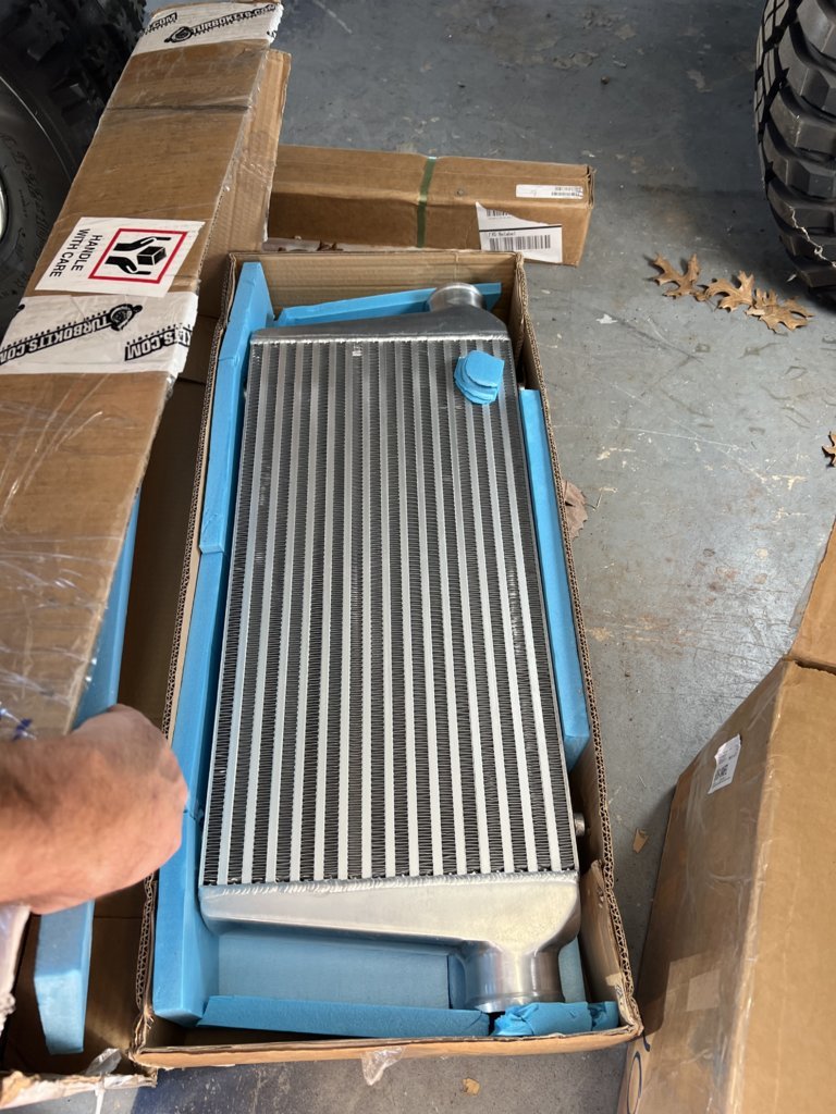

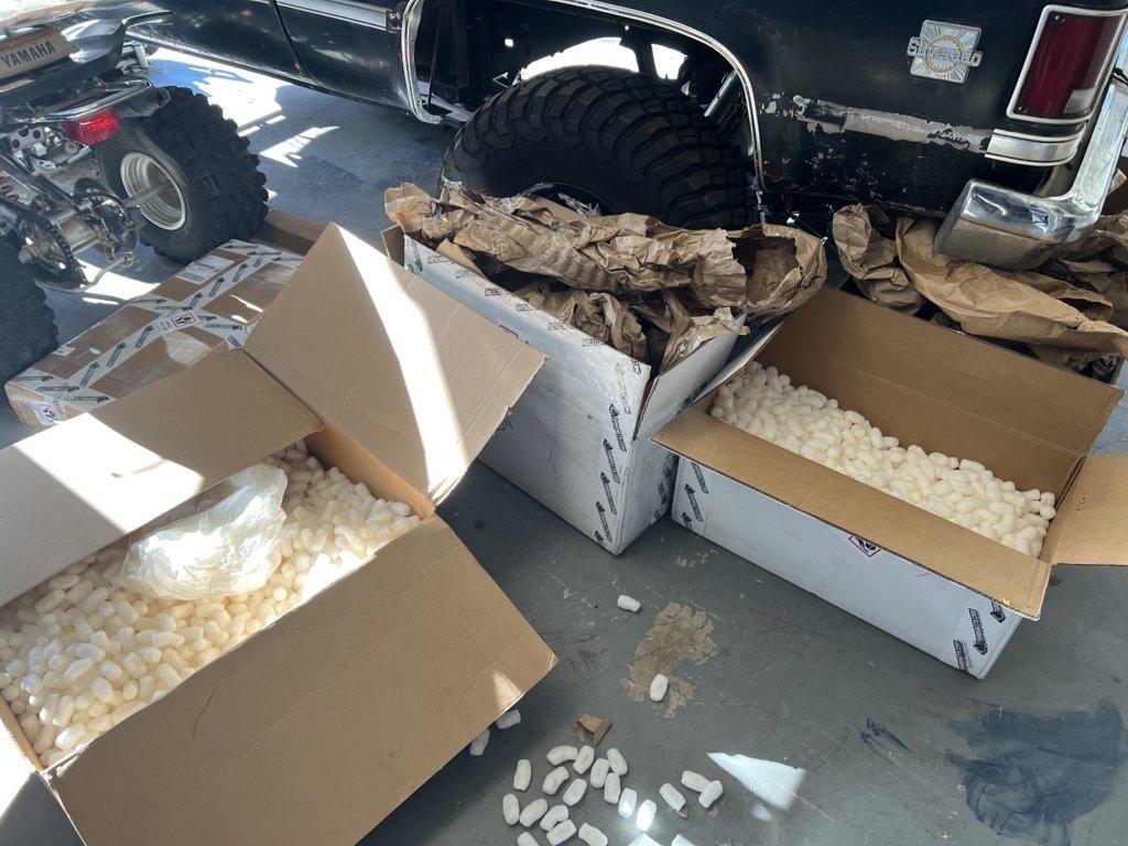

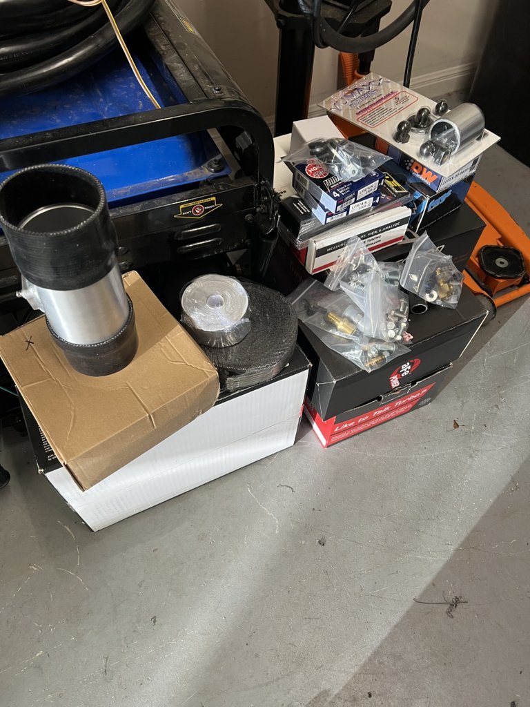

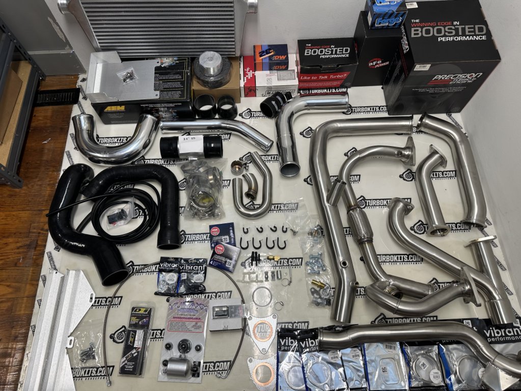

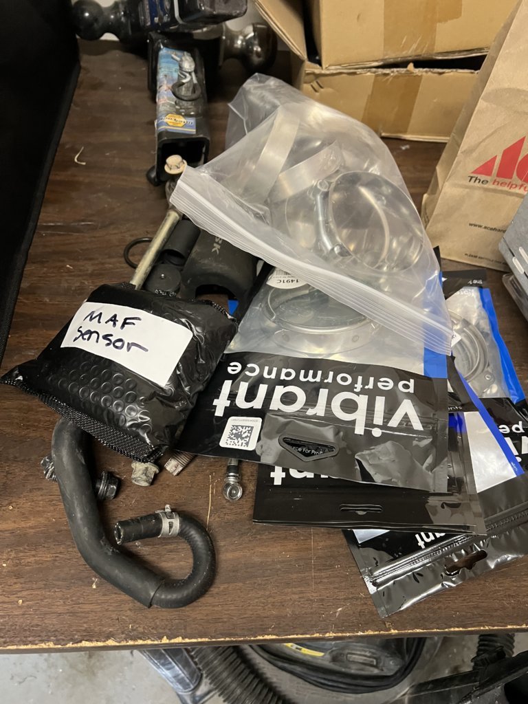

    Unboxed everything today and first thing I’ll say is that if FedEx manages to damage anything in these boxes, they did it on purpose. I unpacked 2 55gal trash bags worth of packing peanuts not counting the various other wrapping methods.
    On that note, be very diligent when going through the peanuts. Lots of little parts that are easily missed. As I was scooping the boxes out I found the meth solenoid and nozzles hiding in a box that I had rummaged through multiple times.
    There’s a lot to go through and now I gotta start planning things out.
