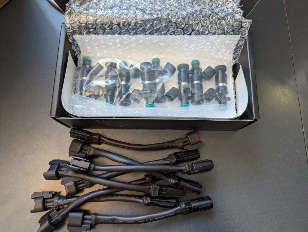

    Apr 23, 2018
    #14693
    922
    Oscar
    SouthEast, TX
    2017 TRD PRO Barcelona Red
    a few
  3. Jan 2, 2025 at 3:33 PM
    #1473
    TurboKits
    TurboKits New Member
    Nov 11, 2022
    #86522
    537
    Yes and no, we do have to adapt the pigtails, but we preinstall them and have them professionally potted as well, so yes they are plug n play, but there is an adapter for the connector, we just take care of it all before they ship out :)
  4. Jan 2, 2025 at 3:59 PM
    #1474
    M3Tundra-JK
    M3Tundra-JK New Member
    May 3, 2022
    #77930
    2,782
    Scott
    2005 GX470
    How long are the adapters? If I remember right, PS's are like 5ish inches or more(?) But I think the rub with theirs are that some parts of the connector is manually shaved down, inconsistently
    snivilous, TurboKits[QUOTED] and Ryuu like this.
  5. Jan 3, 2025 at 6:17 AM
    #1475
    TurboKits
    Nov 11, 2022
    #86522
    537
    The connectors have to be shaved down, there aren't any true performance aftermarket injectors that have small enough connectors and there is 0 room under the rail. However, the way we do it is to solder the connector extensions onto the injector pins and then pot them. That way, its 100% all weather safe and you don't have to fight to make a connector fit under the rail, just run the extension up and out of the way and connect them :) I looked through our injector pictures folder and I must not have taken a final picture when they were 100% done. Next set we build/sell, I'll make sure we do!
