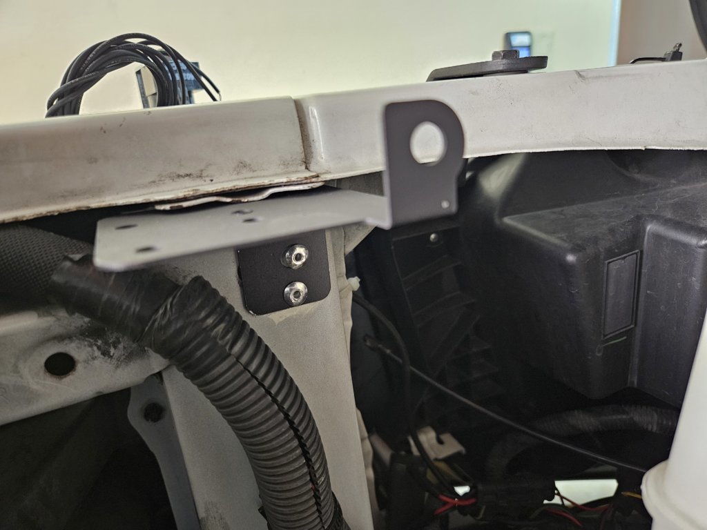

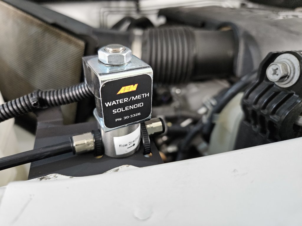

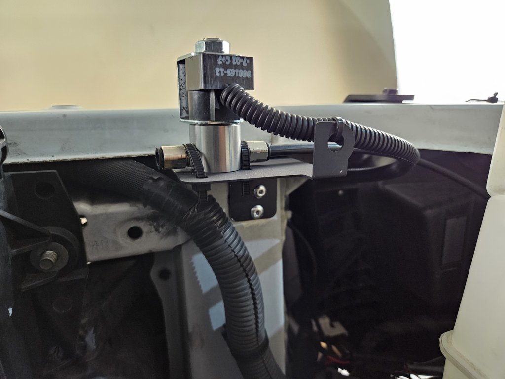

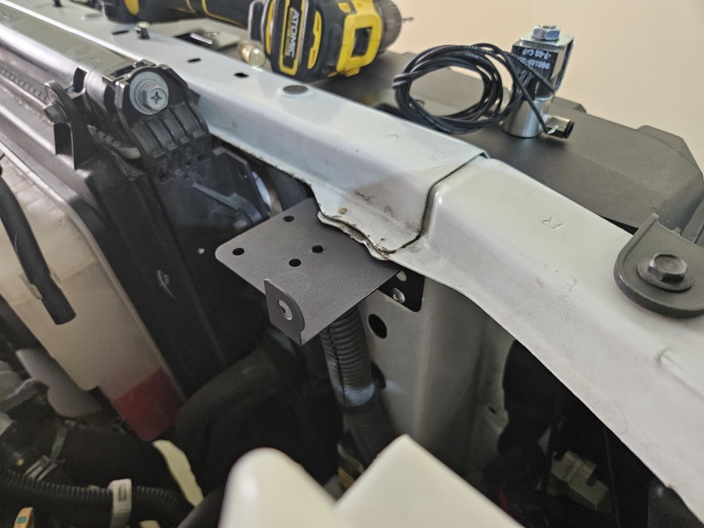

  17. Oct 18, 2024 at 7:20 PM
    #1367
    Jego
    Jego New Member
    Jan 17, 2021
    #57757
    359
    Orlando
    PR
    2018 Tundra 1794
    Update: Here is where I installed the water/meth. solenoid. Nice spot considering the stage 2 nozzle location. Used a bracket that came with an old radio I had and 2 rivets to install it.
    TurboKits, bflooks[OP] and AZTundra like this.

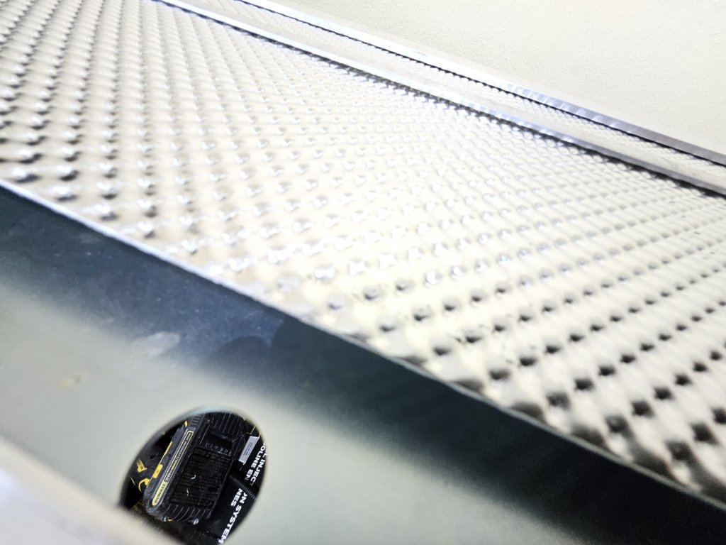

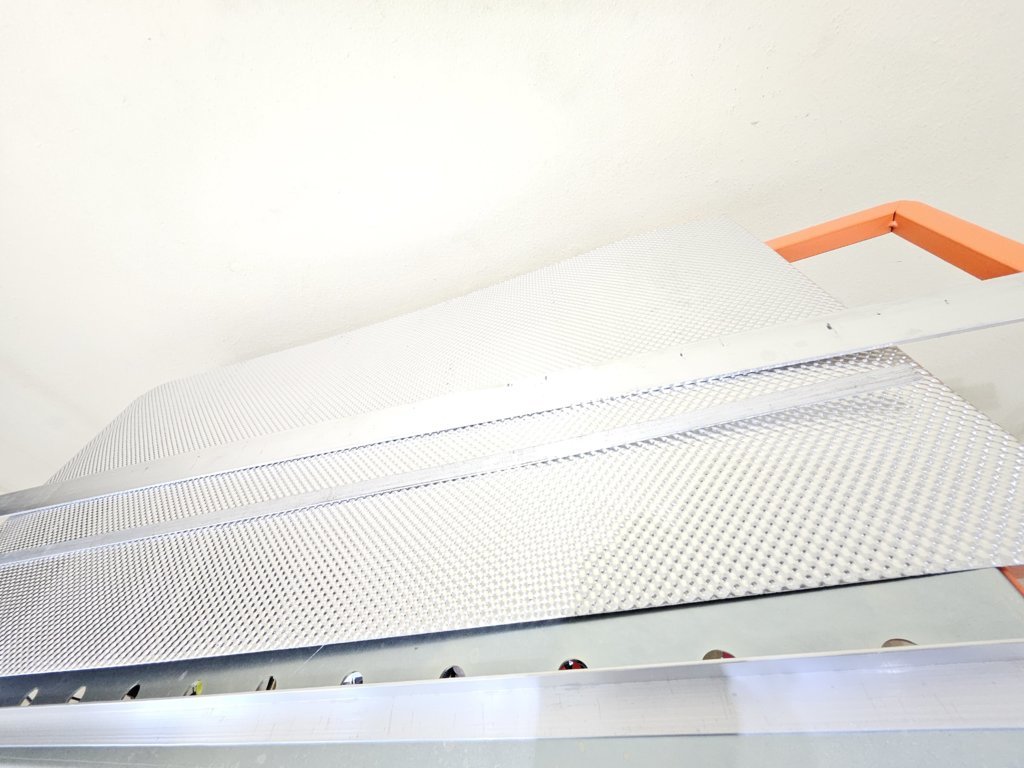

  28. Oct 23, 2024 at 7:08 AM
    #1378
    Jego
    Jego New Member
    Jan 17, 2021
    #57757
    359
    Orlando
    PR
    2018 Tundra 1794
    Awesome! Thank you both @bflooks / @TurboKits for such a great data, for this and all you are doing! I love the idea to make things a 200% better if possible. I will follow you on this! :)
    I am not sure if I am going to do it, but I got an embossed aluminum heat shield and some aluminum bars with the intention to make like a heat shield between the firewall and pipes to protect the break lines there. Also, to make another heat shield between the engine and the turbo/pipes. The idea is to make some aluminum brakets with the bars I got to hold the shield separated from both areas, using rivets to attach the shield to the brakets and existing bolts to hold the brakets.
  29. Oct 23, 2024 at 7:14 AM
    #1379
    bflooks
    bflooks [OP] New Member
    May 9, 2020
    #46273
    2,302
    Metrowest MA
    I saw those heat shields on a much earlier photo posted up here. I really like how clean it was to protect the wiring and coil packs. Staying tuned! Please document the heck out of the dimensions for the brackets (or make 2 sets... one for a distant friend LOL)
    TurboKits and Jego[QUOTED] like this.
