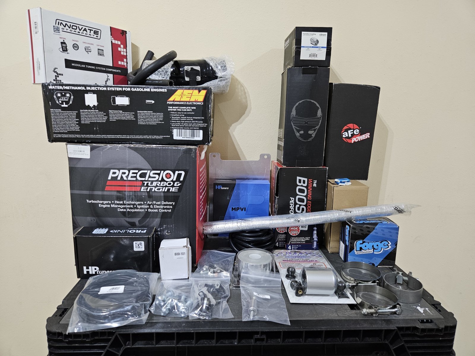

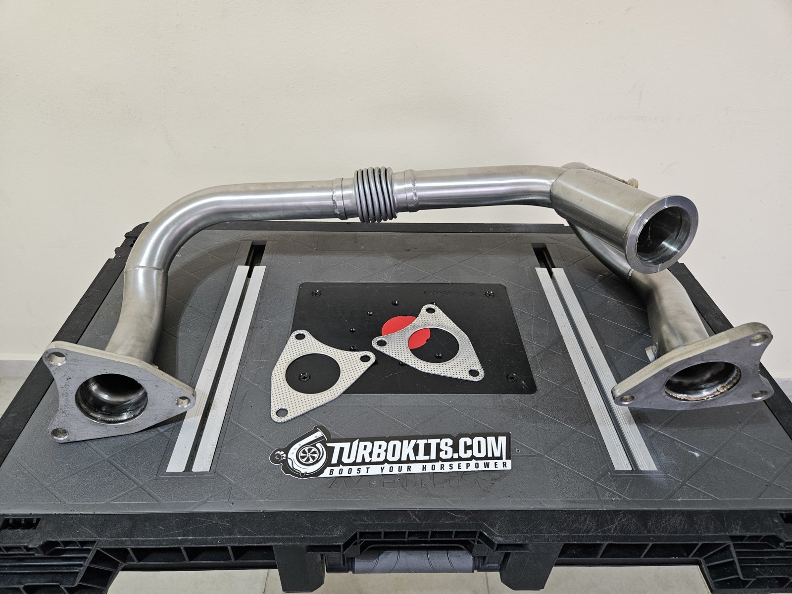

    The only remaining item associated to the lift kit install is a replacement of a damaged bolt on the sway bar link. Not a big deal. I have to wait for the ordered bolt to arrive, but this is not critical for the Turbo kit. Finally, today I started to focus on the Turbo kit install after cleaning and organizing my garage. It was messy after the lift kit install.

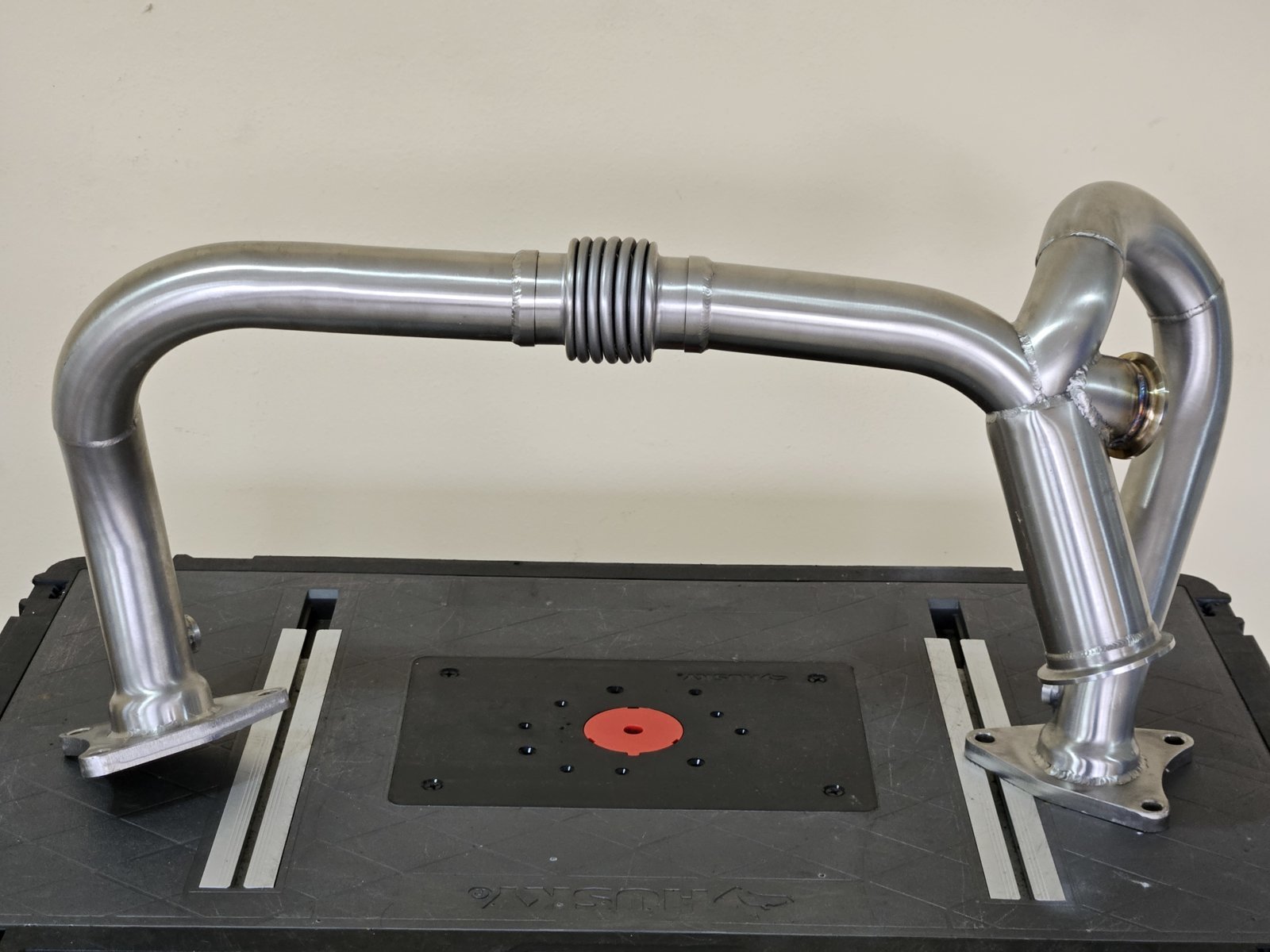

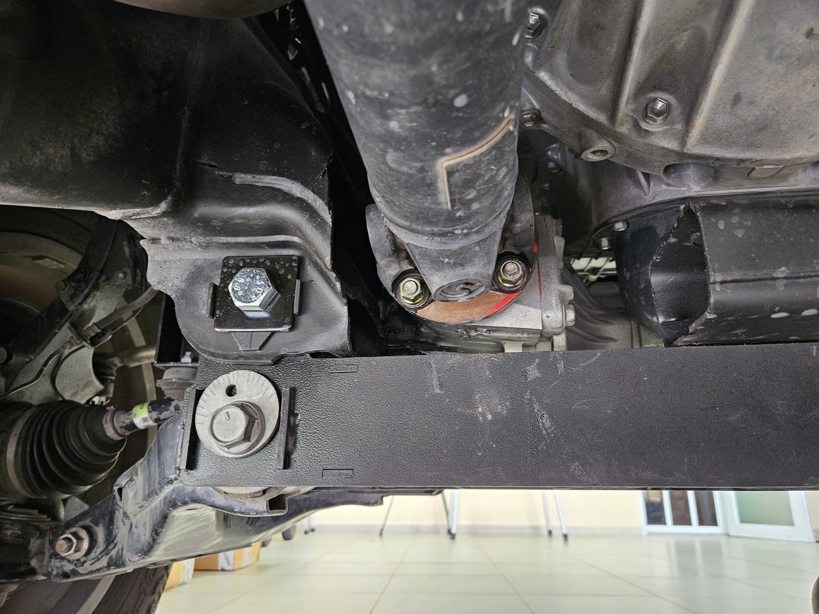

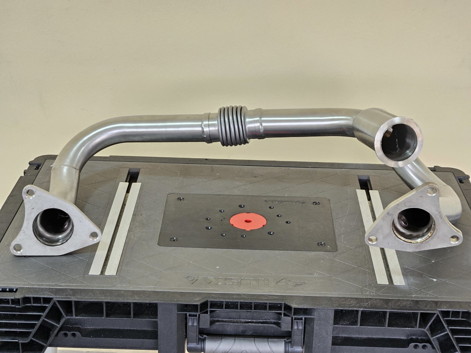

    It's official now, I started today. I opened the cross pipe box and spent sometime figuring out how to modify it. I was impressed! It really looks like a masterpiece. Unfortunately I have to modify it to fit my Tundra which has a 6 inch lift kit. This is something I already knew before so I'm fine with it and super excited. We'll see how it turns out.
    I will be working on this after work anytime possible on a daily basis. There are a lot stuff here so here are my next action items for the next 2 or 3 days.
    • Open the remaining box in order to familiarize with all parts.
    • Send the factory map to Jesse.
    • Make an assessment for anything else required in preparation for the full install.
    • Visit a local Dyno to have the stock performance for comparison purposes.
    • Get stock logs for later references.
    • Start the cross pipe mod including upgrading to the 6” flex section
    I will be taking videos about the whole process and will do my best to edit and post videos by phase. Of course I will be posting pictures and updates here as well :).
    And of course some photos taken today....

    Nice! And I feel you on the garage. I don't know that mine has fully recovered yet.
    I'll be curious to see how much modification is really required of the crossover pipe. That one photo with the new cross member doesn't look like it changes the location forward or back, but I'm just trying to compare against the front driveshaft location. I can see downpipe.#2 being more of a problem, potentially, but that is a far easier pipe to rework. Good luck and looking forward to following along. 80-90% of the project is 10mm and 12mm. Mark those for easy identification. Lol
    TurboKits likes this.

    Looks like is not much mod required :fingerscrossed:. As you said no forward or back changes. Is just mater to drop the driver side like 2 or 3 inches maybe. Let's see. But for sure I am not going to touch the right or passenger side section of the cross pipe because that will required the rest of the pipes to be modified as well. I will mark those 10/12 mm Thanks! Let's see what happens now on! :)

    Yes, looking at the pictures, the passenger side will hard mount and locate the uppipe to the turbo and downpipe. So don't adjust it there, as it will throw off the rest of the piping. Hard mount that side and connect the uppipe and turbine housing, then cut and drop the driver side, come over 90*, straight shot to the passenger side section and then up to the merge. That way you're only really modifying the single piping section and not having to mess with the merge.
    Jego[QUOTED] and Wynnded like this.
