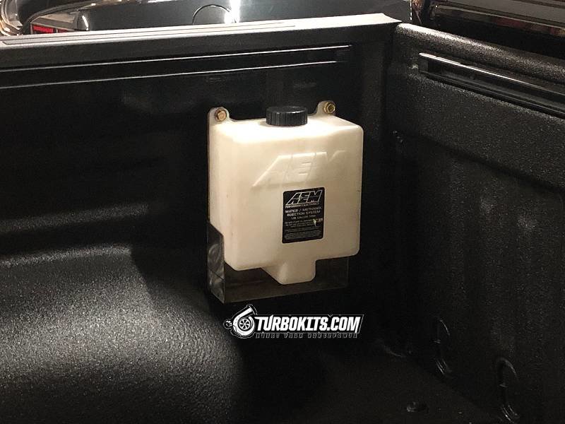

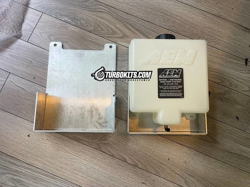

    More progress! We received our production samples in for the water meth mounting bracket. As mentioned in a previous post. We were able to make a compact, bed mounted bracket which does not require ANY cutting into the bed. Simple Nutsert into a factory hole on the inside driver side of the bed and you do not have to cut the bed to run the level sensor wire and hose. It's a super clean install :)

    Looks great this is next on my list of items to add. The AEM kit is sweet

    Absolutely, we have used the AEM Water Meth systems in our turbo kits going on almost 15 years now. They are awesome. Keeps charge air cool, adds to the detonation protection, is equivalent to running 100oct, but ONLY when you need it (in boost), among other benefits. Cheap insurance if you ask us!

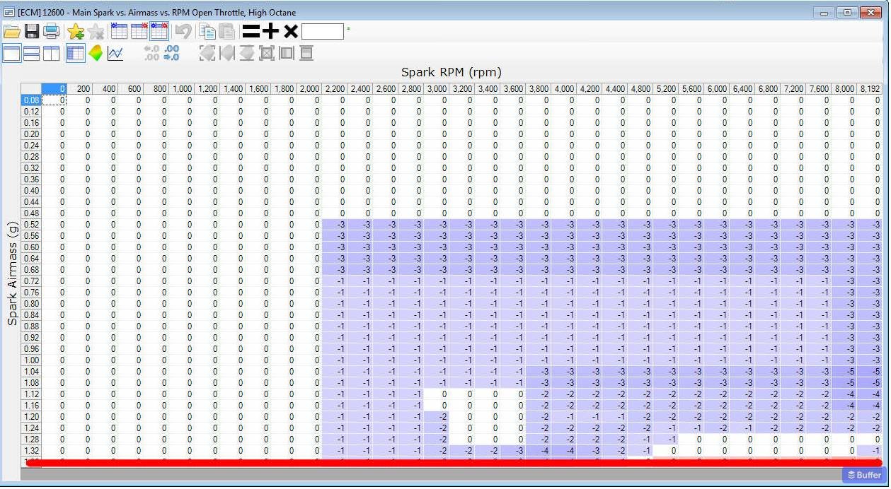

    Yeah, the issue with running on the top line (MAXING THE MAF OUT) is that it gives no room in the tune. Cold night, slightly higher boost, more fuel needed, can't fuel it, hot day, lower boost, less fuel needed, can't adjust for it. So essentially, you're either always changing the tune for different conditions, or staying somewhere in the middle, not ideal for either scenario. But yes, agreed, this would be a game changer for the Tundra market.

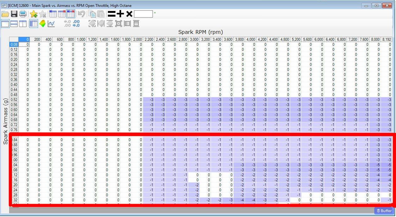

    From our research and it's been thorough, there isn't anything that will work. There are plenty of voltage clamps, but the issue isn't going over voltage, as we can just turn off the CEL for the MAF code and then ride the top volt max in the mapping. The issue is you can't go over 5v. Once you are at 5v, you're taking a xx by xx map and basically only using the 1 top line to tune. The sensor we are working on, will give us way more upside before we hit 5v. It looks, mounts and connects exactly like the stock sensor, but has more head room for the same MAF tube size. So instead of hitting 5v at 500HP, we'll hit 5v at 650HP. So when tuning for 500 or 600HP, we are able to use the full X & Y axis of the mapping to adjust for all variables.
    Here is a (crude) visual representation of the issue:
    Stock MAF, hitting 5v MAX *this is how much adjustability you have in the tune once you hit 5v. Since you are at the MAX
    Upgraded MAF, which doesn't hit 5v until higher air flow, now you gain all of this mapping capability above your old MAX.
