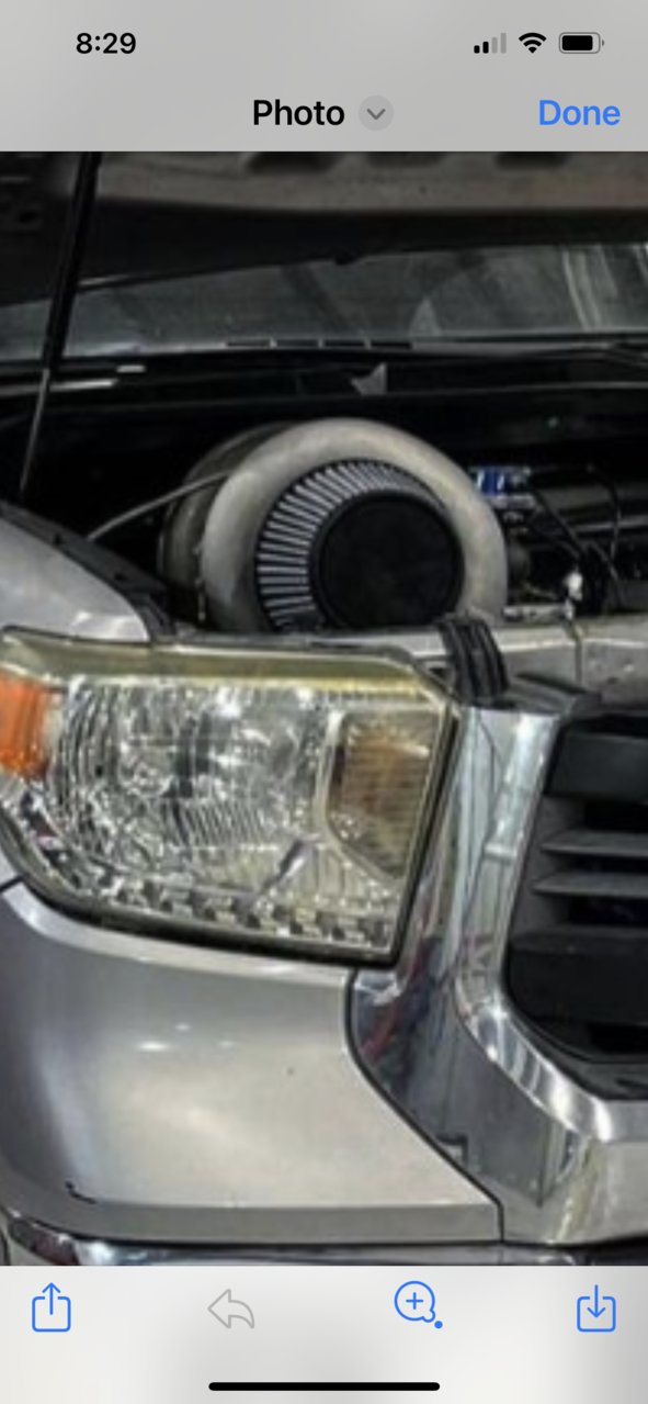

    Please note that the Stage 1 is probably off the truck already or soon will be. The final stages of this will be a Stage 2 and has been since the beginning. One to show how easy it is to go to the Stage 2 and (2). because it is twice as cool as the 1!!:)
    I understand the basics of the Turbo charged vehicle but this is a first for me and new for the Tundra kind of at least around here.
    The intake where the filter is I am going to suggest that it is piped down and come out under the bumper with a wide oval opening. Then screen said opening. Doing something like that will give fresh ambient air coming into the turbo and being that there will be a steep up turn it will prevent any water coming in. I think a wide oval opening underneath will not hamper anything as this is not an off-road vehicle. I saw this application in a Camaro but it was plumbed into the bumper,,, our bumper has to much going on in there for that to work therefore my idea is to put it under.????
    I will ask the crew if they could do this or if it is even necessary. Jesse has had this same system on his truck for years now and has not been gentle with it and has not had any troubles/issues. Plus it is a high mileage Tundra. Like I said this has been addressed (Heat) at the beginning of this run.

    I just saw part of a video and I am disappointed. But I do not have the facts. Let me say this differently. I saw a picture of the truck at the dyno, I can not open it to run the video. I do not have the facts yet nor know anything that took place during the video.
    But I saw a picture of the hood open and fans in front of the truck.
    I am hoping that this was for the wastegate dump run but we shall see.

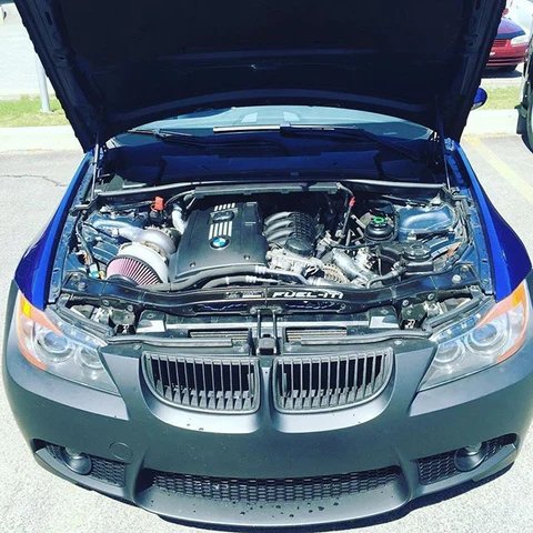

    Look at this BMW now that is a tight fit DOC Race BMW

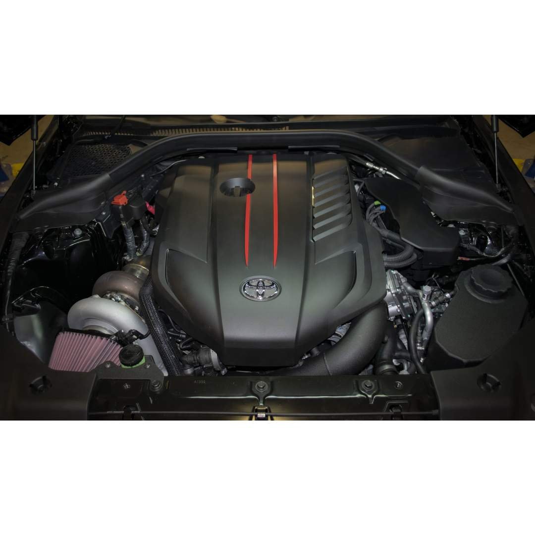

    Supra kit

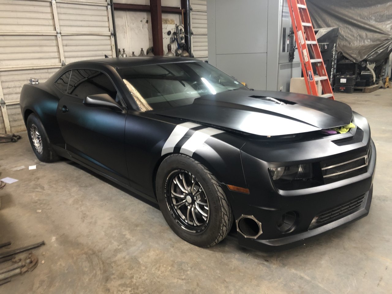

    09B7C419-448A-43A3-A3C2-7BC5C66EDA38.jpg This is the Camaro that gave me the idea to put a cold air scope under or on the bumper. This is his wastegate dump if I remember correctly. Anywhos I found out it really wasn’t necessary so I will let the guy that knows turbos handle things like he has been. Yay for Stage 2 :)
    And this was the first time I saw those expensive Titanium lug nuts!!!:)

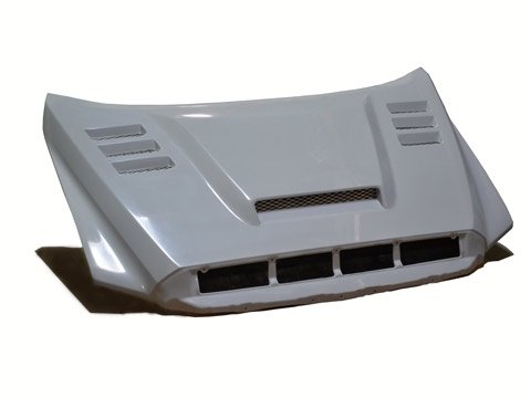

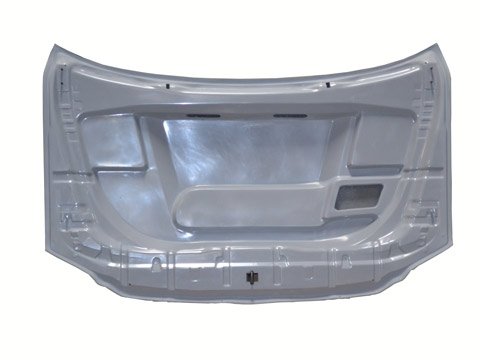

    I think you'll be fine. And and if anything, that hood I linked would probably solve any temperature issues that would arise. Plus it'd look badass!

    I thought I read they were really heavy. Not sure what that means as far as real numbers but I was just told all fiberglass is heavy

    Also no that hood should be roughly the same weight as stock, but I haven't looked into them in depth on the Tundras. You can get them in carbon fiber, which would be lighter and stiffer. I've had a vented carbon fiber hood for my M3 on backorder for 13 months now though!
