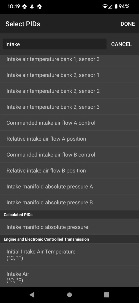

    What PID are you guys using for IAT in ODB Fusion?

    It's listed as intake air temperature I believe.

    Guessing that one down at the bottom? Just wanted to make sure I get the right one

    Yea I believe so. I'll have to confirm in the truck
