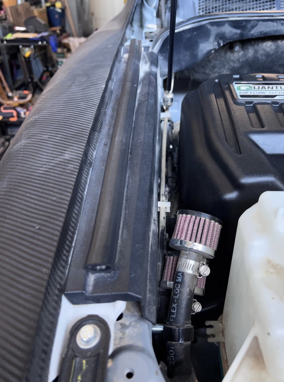

    I spent some time and used all the stock door and hood seals on the glass fenders. Fits surprisingly well, used the original clips etc.. It’s always dirty, if I wash it then something breaks. Lol
