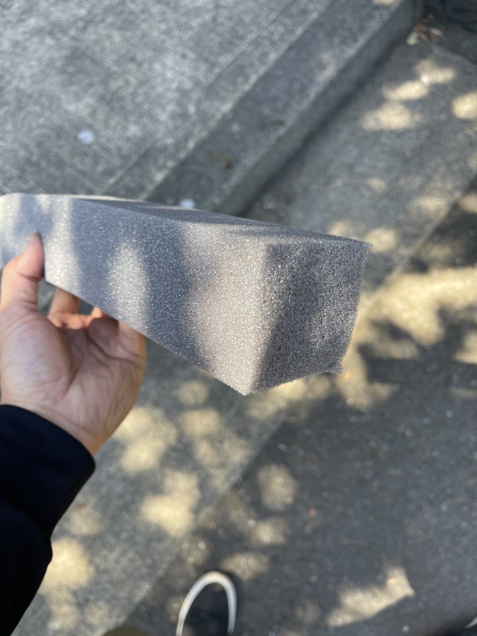

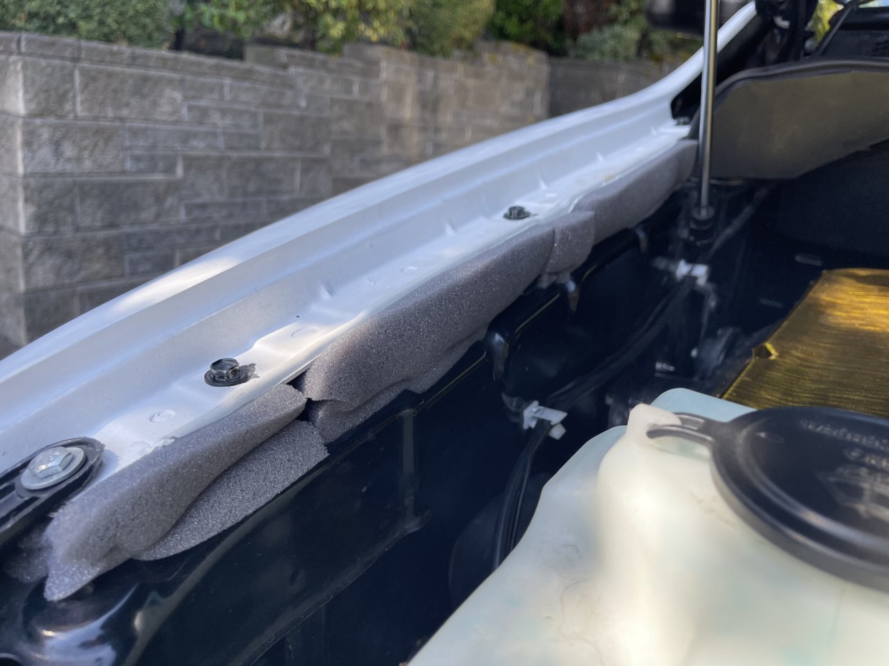

    Ok gang. So I’ve been talkin to the old man about IAT temps and we’ve potentially found another culprit. There’s a large gap from where the fender bolts to the body. That gap is open to the fender well area and the intake ports. We think that this is dumping hot engine air into the fenderwell cavity thus sucking hot air. Since I don’t have liners this isn’t much of a problem yet.
    But for him we couldn’t figure out how the hell temps would rise so much in such a short distance. Conclusion is that the air in the area is hot from that gap and other things. So pics attached and we’ll see the outcome of the data.
    This is a temp solution but I’ll probably make some sort of L shaped metal piece to block this area etc. He’ll be doing testing since he’s got liners. More to come
