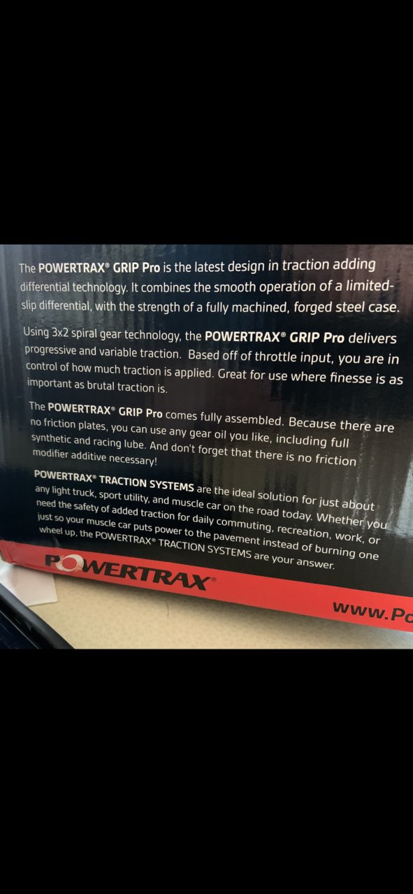

    Got my powertrax LSD delivered today. I know this was touched on earlier, but I find it amusing how on the box it says use whatever oil you want including synthetics. Then I scroll through the manual and it’s says synthetic oil is not recommended. I feel like I’m reading a White House press briefing.

    Marketing vs Engineering.
    I'm running stock fluid, it's the quietest and I haven't had any issues, you will love how taking off at turn just go, instead of traction control light kicks in.
    Are you doing gears at the same time?

    I’m very excited to have it installed for sure. I am not 100% decided on gears but I’m leaning toward not unless you guys with 5.29s prove to be significantly faster than me with the Dragy. I’m only running 33s and don’t feel the need to go larger at this time, granted I constantly change my mind on 2 things….tire size and exhaust.

    That's probably because most Synthetics have some kind of friction additive. I run Motul Sythentic gear oil it's the only synthetic that you can get with zero friction additives, love it and have had great results with both my ARB lockers and my Powertrax
