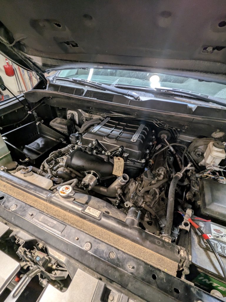

    I filled the system and when I cycled the pump the level didn't change.
    HulkSmurf14, Mdl and Wynnded[QUOTED] like this.
  4. Sep 11, 2025 at 5:41 PM
    Danimal86
    Aug 29, 2017
    #9321
    5,079
    Daniel
    Sacramento, CA
    2017 White Tundra SR5
    I'm wondering if I'm having a hard time purging the air because I'm on an incline.
    How bad of an idea is to turn on the engine and back it onto the street?
    I haven't flashed the tune yet.
    Mdl likes this.

    You can as long as you don't get into boost and double check connections. Especially look at fuel injectors etc.

    Gotcha. I might try backing it out of the driveway to see.
    The ic lines feel soft with the pump running.

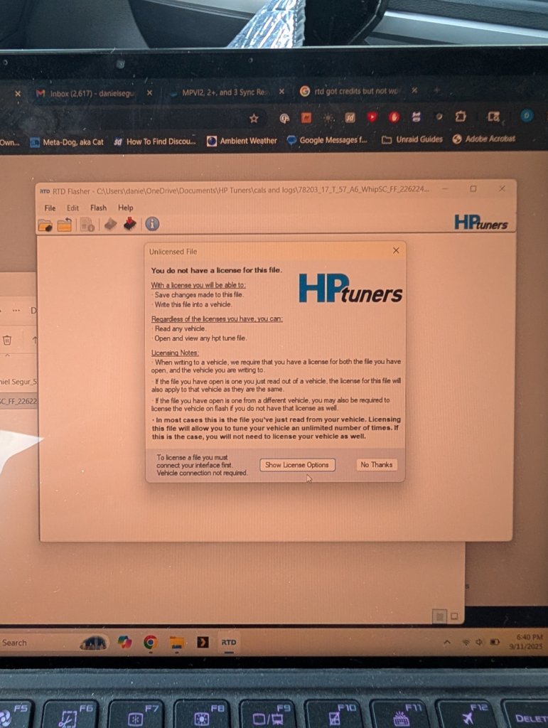

    Anyone with the Whipple rtd tune have issues? I'm following the instructions, got the credits applied but when I try to write it it says it's and unlicensed file

    In hpt documents the license.dat file may be deleted. Sometimes it prevents a write.

    I would not be worried at all about the level of the intercooler system. It is completely stand alone from the blower and engine. Even if there was no coolant at all you would be fine, especially if you're not in boost. I would fill it up as much as possible then go drive around and don't think about it, then just check the fluid level every day and top it off until it starts holding steady. If there's no fluid at all, the worst that happens is the intercooler pump runs dry which I'm sure isn't ideal, but since it's at the bottom that shouldn't really happen ever.

    I gave that a try. Deleted the license and rebooted. Didn't change anything.

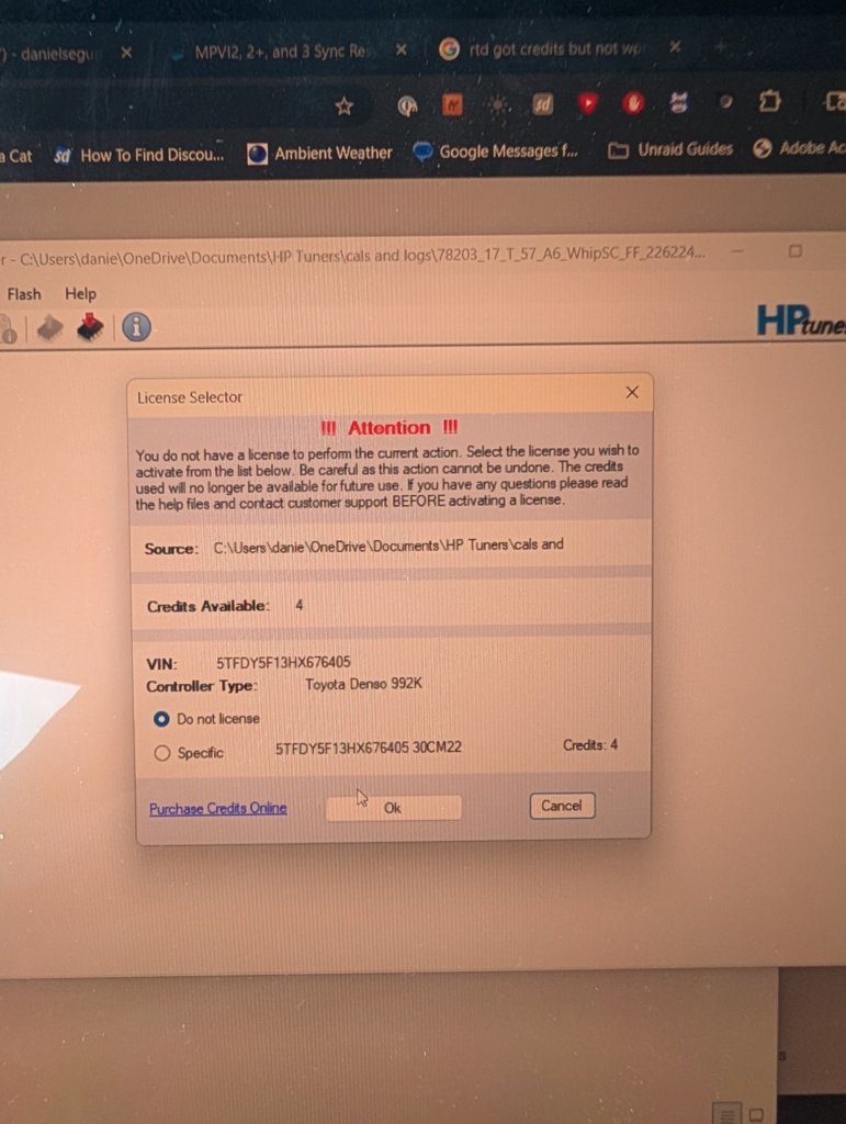

    Ohh maybe I need to apply the credits.
    Here's what it says
    When I click show license options it says this

    I backed it out of the driveway and got it flat on the street. The IC reservoir dropped a little but not much. Hoses are soft for the ic.

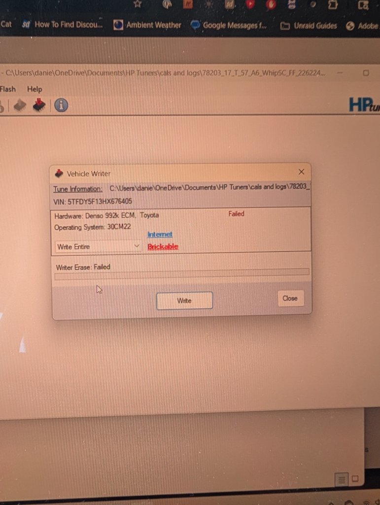

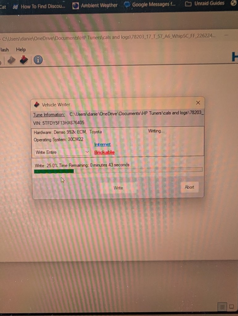

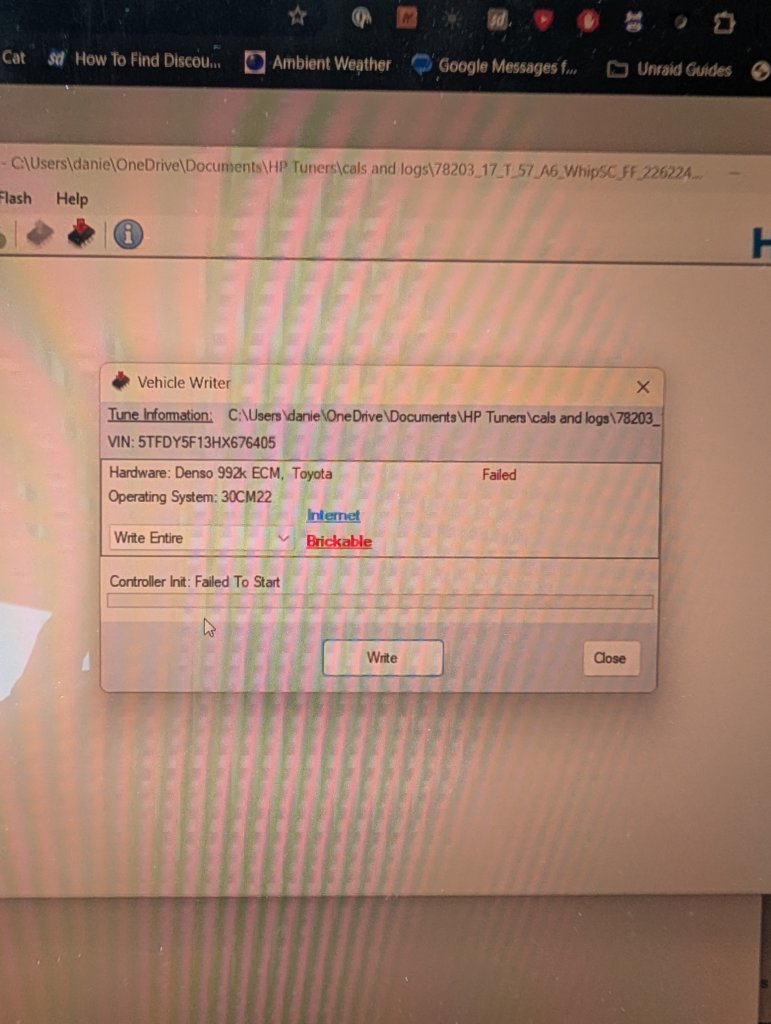

    Tried to write it twice.
    mustang67408 and Mdl like this.
  29. Sep 11, 2025 at 6:59 PM
    Mdl
    Mdl Hey there...
    Jun 14, 2023
    #98638
    3,654
    PNW, WA
    2007 TRD SC'd
    JBA Longtubes, Snivs 2.0 SC pulley, ASP crank overdrive pulley 6.71 in, DD Full 3inch dual exhaust, IPT valve body, Airbox mod, 4.5inch intake, Denso 750, 450 Walbro, W/M injection, GM 95mm TB, SABM, Camburg UCA, Icon shocks, Speedmaster LSD, Motive 5.29 Gears, Mickey Thompson Baja Legend EXP 35's, Solid Offroad engine and transmission mounts, DIY Traction Bars, Tuning by Snivspeedshop.com
    Try a Lan cable from router to computer if your wifi connection is low. Sometimes happens.
    mustang67408 and HulkSmurf14 like this.

    Hoses will always be soft, it's not a high pressure system. Don't sweat the intercooler system, I think it's fine.
