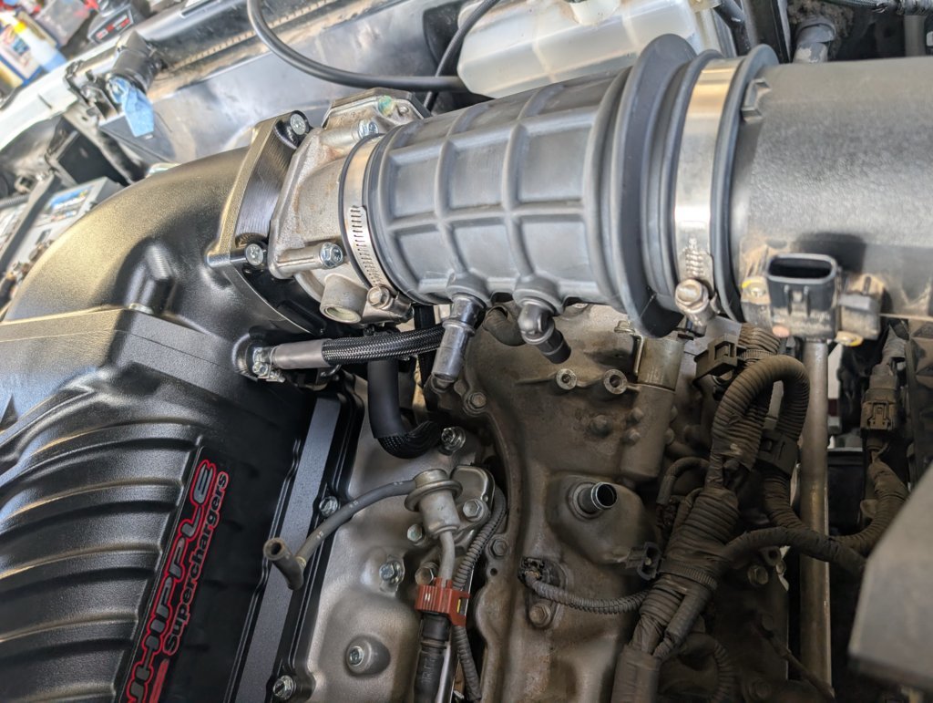

    Another hiccup on Whipple's part.
    Instructions show 3 ports on the silicone coupler between the air box and throttle body.
    New one only has 2 so I have no idea where the 5/32 hose from the fuel pressure regulator goes.

    Does it say for the fuel regulator to be boost referenced. I thought they recommended it?

    #80740
    3,404
    Hook up the FPR to one of the ports in the blower, not the air intake. That way it is boost referenced, not atmosphere referenced. I asked Whipple about doing this on the old setup and they said it absolutely should be boost referenced. There are a few ports on the blower manifold that can be used. Lemme see if I can find a pic.

    Instructions say ATM reference, Whipple Tech said boost reference.

    Volume wise I’d imagine that my 3” catted SPD midpipes got me 75%+ of the volume gain I’d get from catted longtubes. It’s quite a bit louder and more aggressive with the same 2 catbacks I’ve tried with the stock midpipes and the SPD back to back. Performance is hard to say the gains it seems, but it appears it’s sort of minimal with a SC. That said, if my stock manifolds failed it would be hard to not pull the trigger on LTs if going through the hassle of replacing the manifolds.
    As the others said, I’d just tee it in with wherever you’re hooking up your boost gauge.

    #80740
    3,404
    I used this port: there were a few brass nipples included in the old kit that allow you to use that port rather than block it off. There are similar ports on the driver side that can also be used.

    Thanks @blenton
    I see that port you circled on mine. It's right next to the fpr so it'll be easy.
    No spare 5/32 barbs were included. Argh
    Edit: I did find a 1/8 npt to 1/4" barb. Might be able to stretch it over the line if it's the right threads

    2017 Tundra Platnium
    Too many mods to come
    The online whipple pdf shows boost referenced. So only two ports on the intake tube.

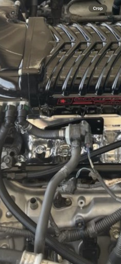

    The vsv valve.....I'm lost. Is that something that was included in the kit or was it factory? It's step 72
    My Comcast is down so I'm having a hard time posting pictures

    #80740
    3,404
    I believe they are referring to the Vacuum Switching Valve, which is a factory part for the charcoal canister or emissions. Are you getting ready to drop the tank? Beyond that, I’m not in the know..

    Sacramento, CA
    2017 White Tundra SR5
    The vsv valve looks like it connects to the bracket on the side of the blower where the intercooler reservoir mounts to, then it hooks to the back one of the 3 nipples off the side of the blower.
    After the belt it's the tank, but I'm still working in the engine bay
    You wanted this lol
    factory part

    Sacramento, CA
    Fuck. I just found it attached to the intake manifold (it was sitting upside down so I didn't see it)
