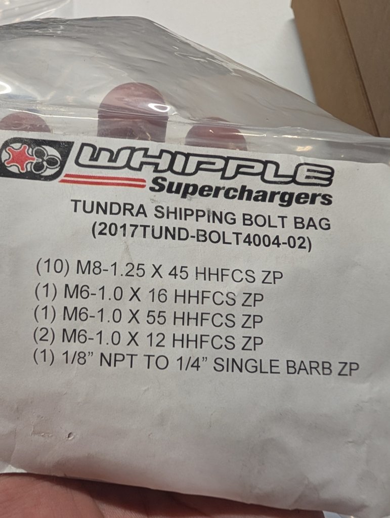

    Well I'll be damned.....glad i'm not loosing my mind about that spacer. I'll reach out to whipple.
    I had a sneaking suspicion that it was the reservoir cap.
    My kit had the 2017TUND-BOLT4004-02 bag in it, but that isn't the one with the step spacer in it. Is that what you meant?

    Yup. I couldn't tell who's writing was who's on the sheets, but noticed that the parts sheet had the -01 circled and -02 red lettered to the side. Mine didn't have the red letter, just the different numbers on the parts bag.

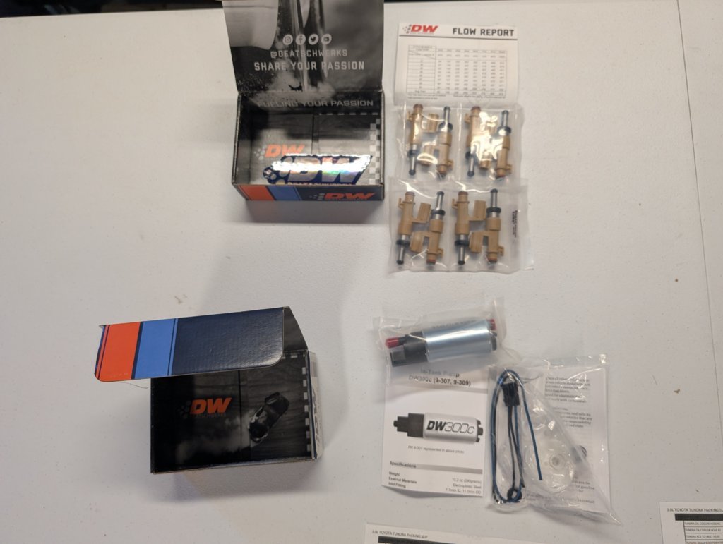

    Anything in black ink on the pack slip was whipple. I wrote in red and highlighter.
    Yeah it came with injectors

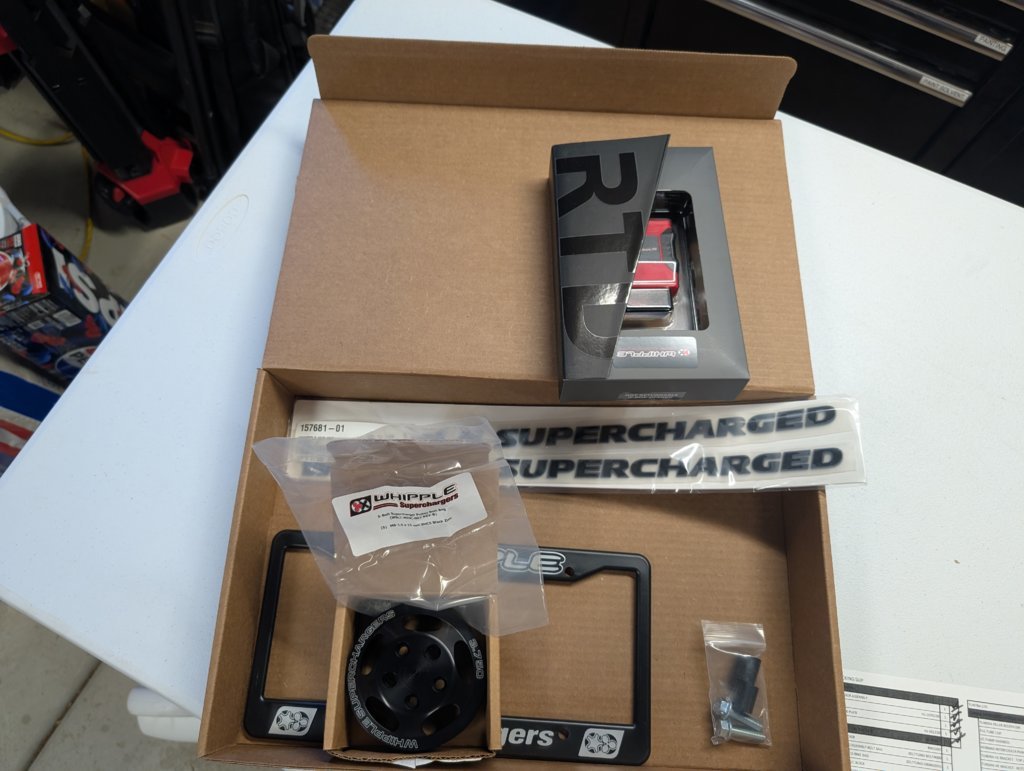

    Another question. Anyone know what the spacer/bolts are for in the bottom right of the box?

    I think the spacers are the intake box spacers. They were different on the 2.9 kit, but at some point you needed to the tilt the bottom half of the air filter box upwards to give a straighter shot at the throttle body. I know the intake tube changed from the 2.9 to 3.0, but I still think you need to elevate the box. But they may be for something else..

    They weren't on the packlist for that box. Some random bolts/spacers, lol.....that'll give me some nice stress when i try to figure out where they go.
    I'll have to go back through the instructions....I dont remember reading anything about that...but makes some sense.

    That was just my supposition after puzzling over the spacers as well. The 2.9 kit had some C shaped 1/8"x 1/2" steel flat bar for the air box spacers. And, like I said, the intake tube changed so maybe the spacers are no longer needed. Let us know what you figure out :)

    when i hear back from whipple, i'll ask them about random bolts/spacers.

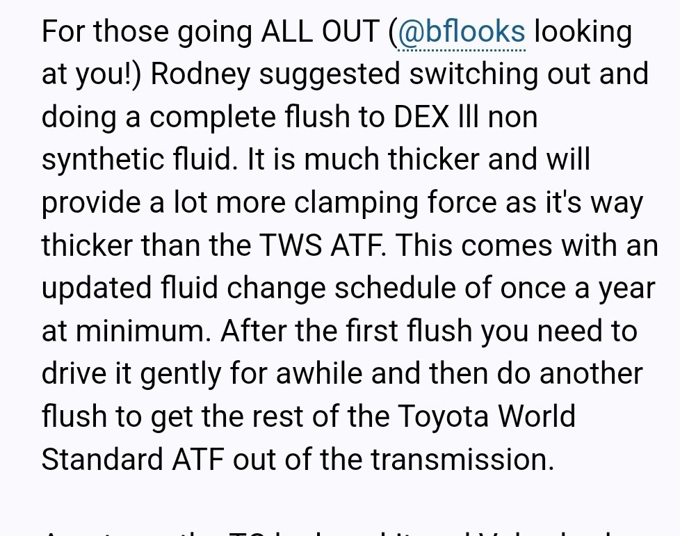

    Dex III now and I plan on 30k drain and fills (just one round), is that sufficient in your mind? I have the nomad valve body with OE pan and I'm pleased with the firm shifts.

    I believe WAT mentioned complete yearly exchange of fluid. Followed by a drain and fill as getting all the fluid from torque converter is not 100%.
    From post #21892:
    Edit: @Jowett mentioned the Idemitsu TLS type 4 fluid was similar to Dex3 with a WS additive pack. The TLS type 4 has similar viscosity to Dex3 but is a synthetic blend.
    Too many decisions... I ran it for a few months before my transmission went out. Had issues way before fluid swap.

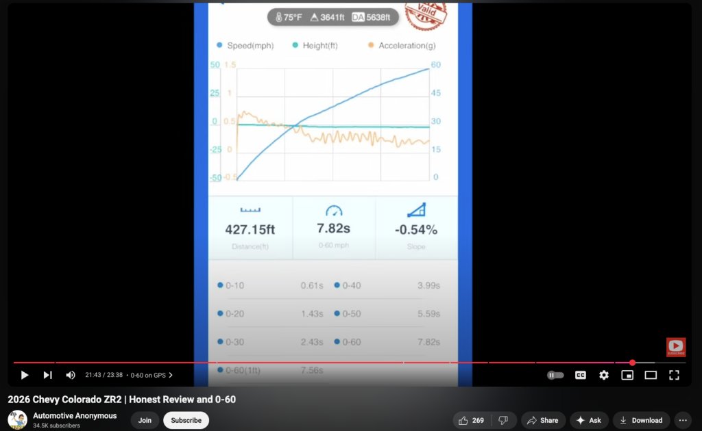

    Sooo we know I'm significantly faster than 7.82 because I just killed an angry young man 2x by 3+ car lengths.
    I didn't do a dragy but sniv has the log. lol
    Thought I posted the link, that is at 21:40
    https://youtu.be/VvgYOb4SmR4?feature=shared

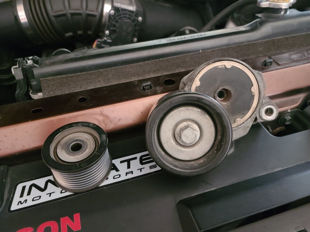

    Changed out tensioner and idler pulley since I'm exactly at 90k miles. Surprisingly neither had any play whatsoever. Oh well fresh ones are on.
