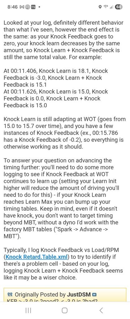

    After every tune i do my truck runs rich as shit. If i wot and hold down the throttle it will throw a code and start misfiring. Ive learned to get some miles in. Tune always starts to lean out and settle after 100+ miles. Figured it was the KCL and knock doing it's thing until it settles. Now is that right and should it take that long to learn up, I don't know. Just my situation after every tune. What air/fuel do you see when going into limp mode?
    Here is a good read on the hp repository about learn up from SlowNstock for anyone curious also
