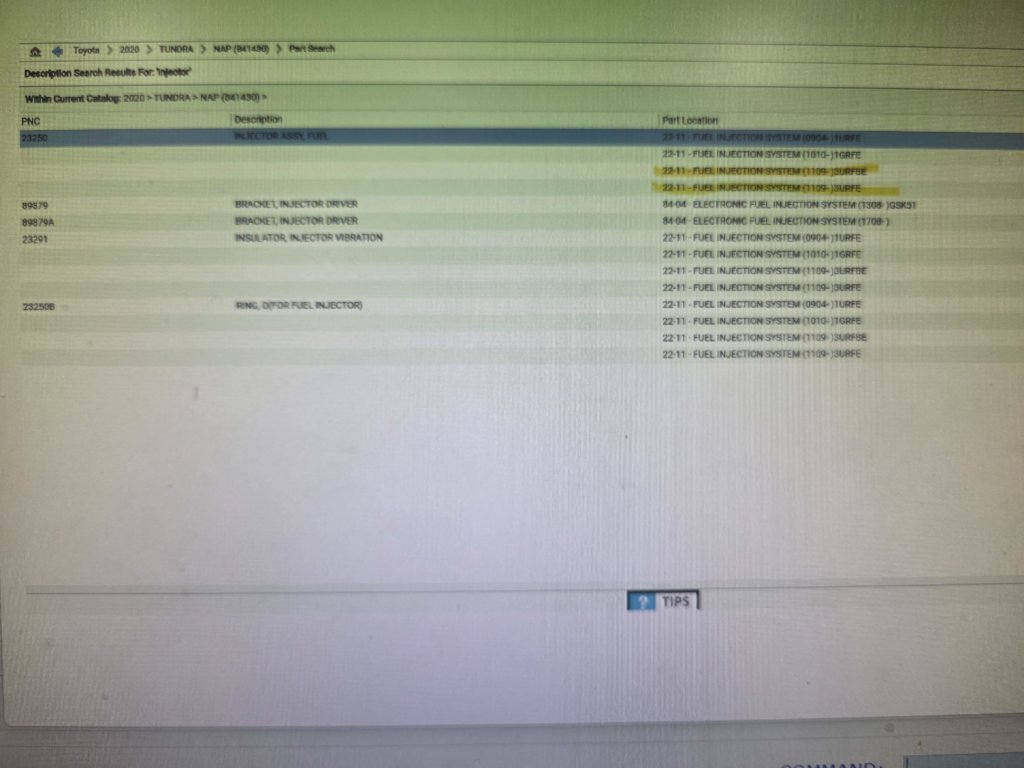

    This is the first time I've heard of this. My 2019 is indeed NOT a flex fuel truck. I would be pissed. What are the smoking over there lately?

    I looked up the injectors for flex fuel and they start at 03/09 and change part numbers along the way until the TTV6 arrived.
    You can get FF 3URFBE or non FF 3URFE All the way up until they stopped making the 5.7
    I totally agree with you, they are smoking something
