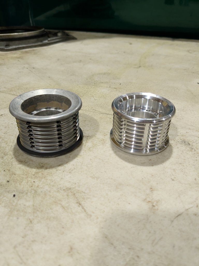

    I have achieved uncharted territory! The 1.880" pulley is here :D
    Originally ViktorG had a custom 2.0" pulley made, so when I very originally designed my pulley I intentionally left a little room so if I one day wanted to push it further I could, and after Mikes request here we are!
    My truck has a new upgrade for the first time in awhile, and that OG pulley that is now 3 years and 26000+ miles old will go on the memorabilia wall. It's pretty neat too since all the pulleys I've made are backwards compatible, so this new 1.880" that showed up yesterday and has some tweaks and newer aesthetics to it bolts right up to the very first hub I ever had made. The pulley setup is just so cool I think :rofl:
    We'll see if this makes any actual difference, it's a minor step down in size, and it's 90+ degrees out so doesn't seem to feel much different besides maybe hitting a bit earlier in the throttle. We'll see if I can move a few places down in the dragy boards once it cools down a bit.

    Yes!!

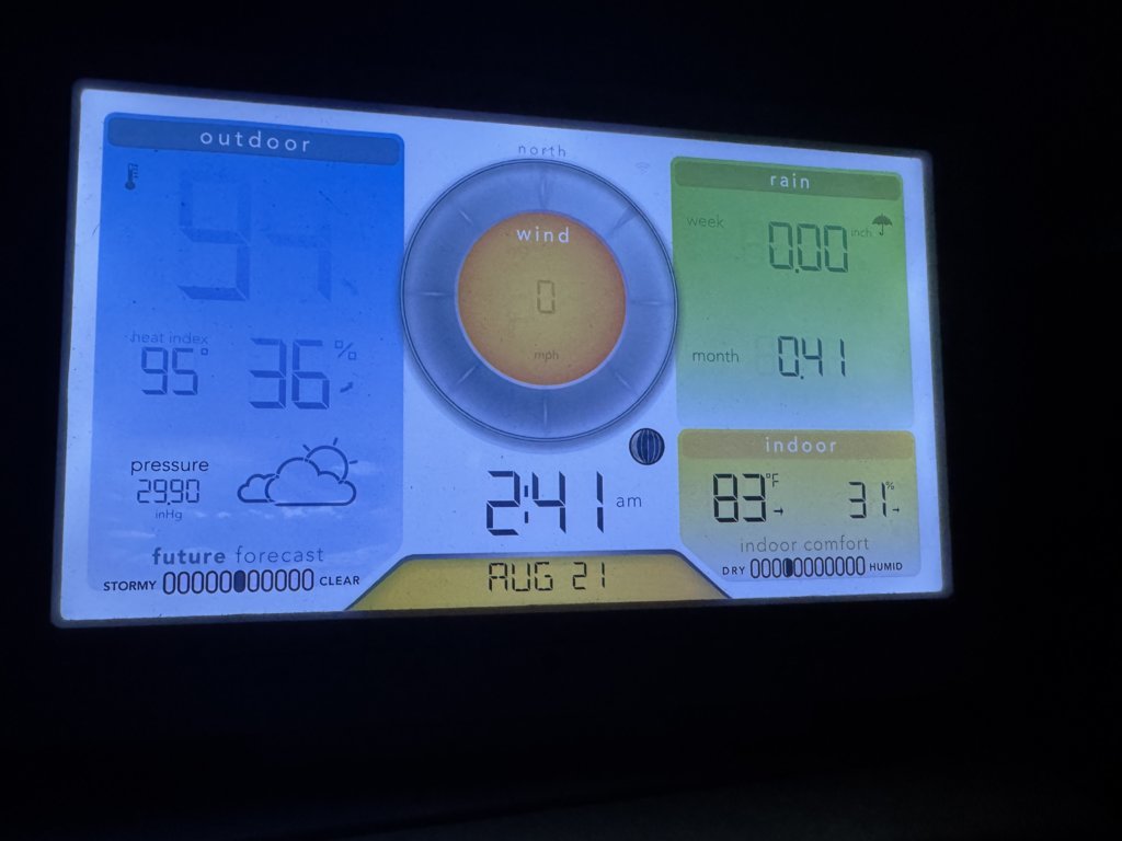

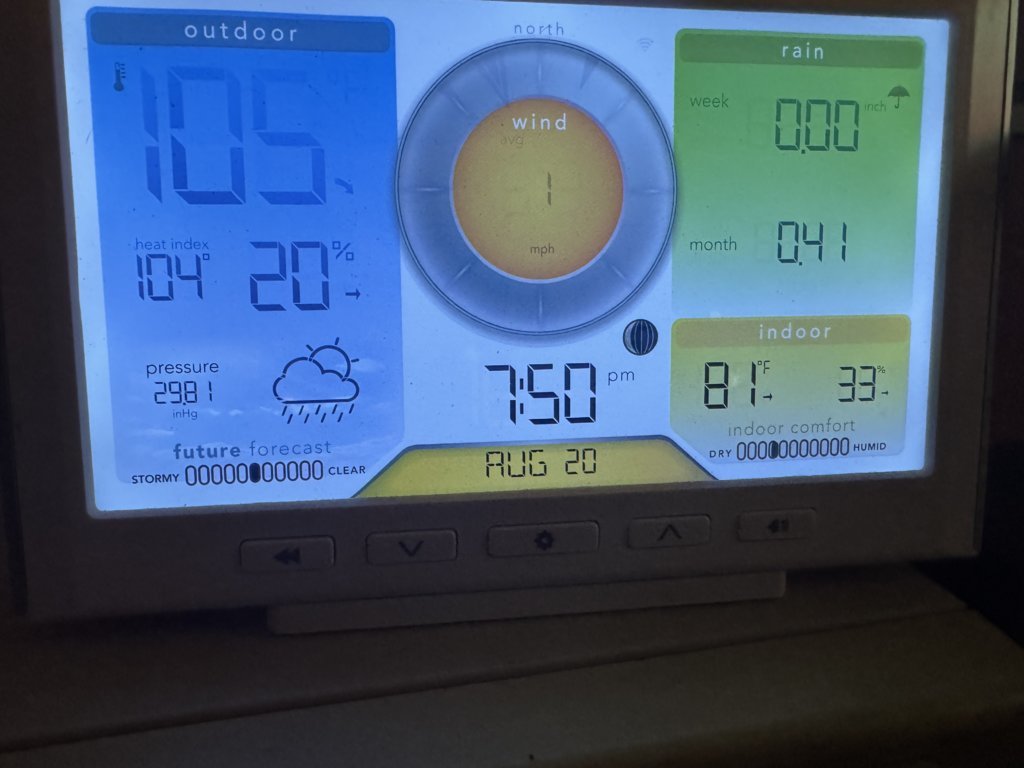

    90? That's adorable!
    122 was the high, 89 the low at 4am.
    Looks like it's not going under 90 today.

    Well, thank you for indulging me! Except when you called it the widow maker...I'm at sea level and should be fun.:eek2:

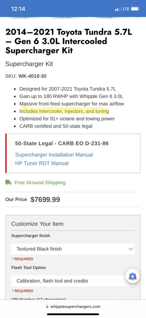

    From Whipples site:

    I'd be referring them to their site and asking for my injectors.
    I'd also give them the option of return and refund (whether I wanted to return it or not)
    That's some serious bullshit.
