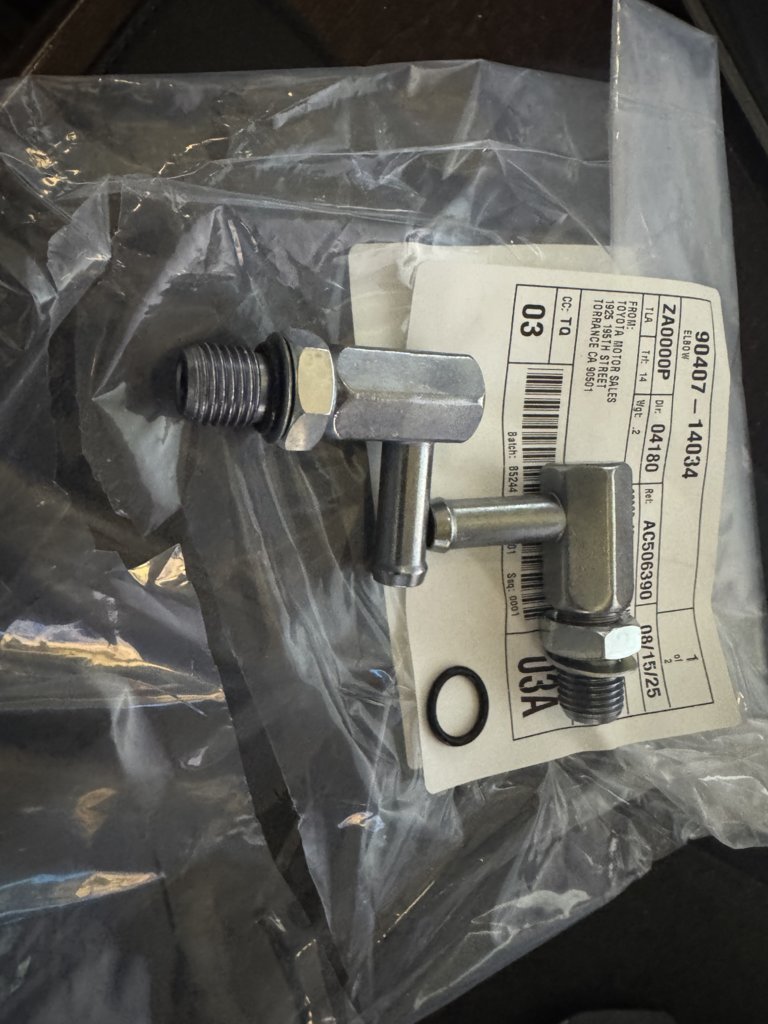

    Thanks mdl! Fittings came.
    I have a 143k working when it came out but I didn't want to deal with the r&r if it failed in 2k miles tq converter if you want it

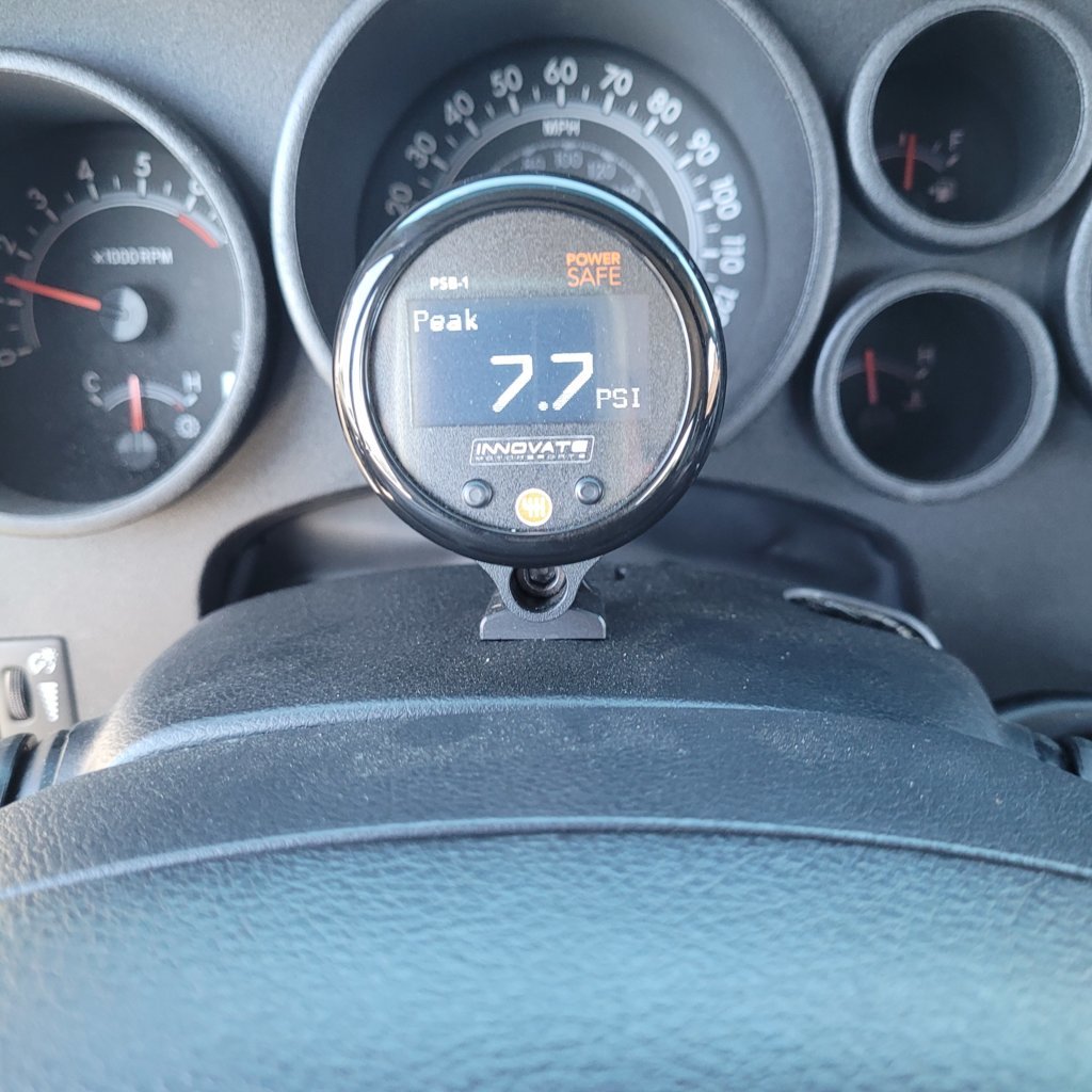

    I would say something is out of sorts.^
    Although I don't have a reference for a tune other than stock, my truck has been running well with the Whipple tune and appears to be adequately safe in the a/f department from what I've been monitoring.
    My latest/highest boost number I've seen.

    What makes you think something is out of sorts? Stock pulley etc that’s not out of normal psi stock range. Have you checked the bypass valve is also working correctly we noticed many installers etc overlook this is clear and not caught on anything

    I was meaning to say compared to @nags buddy my Whipple canned tune has been good too me so far. So, something must be out of sorts with their install of the tune or file they received.

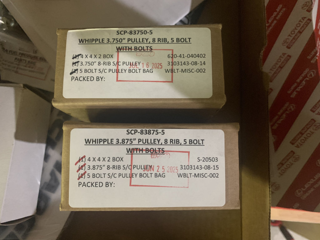

    Alright @LILTRD and @nags and @Danimal86 - what size stock pulley did whipple ship with your SC? My replacement blower came with a 3.75" pulley, but I'm told 3.875" is the standard size for an off the shelf kit. I had pulleyed down my 2.9 due to higher elevation and told whipple as much when I filled out their RMA forms. So now I'm curious which size is standard..

    The 3.0 comes with a larger pulley than the 2.9 did. 3.625 was stock on the 2.9.

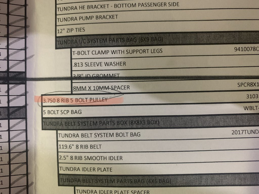

    Right, I'm just wondering which size is stock with the 3.0. (wondering if they sent me a smaller pulley knowing I was running a smaller pulley on my setup).
  20. Aug 19, 2025 at 10:22 PM
    blenton
    blenton New Member
    Jul 15, 2022
    #80740
    3,317
    Never mind. Figured it out.. 3.750” it is.

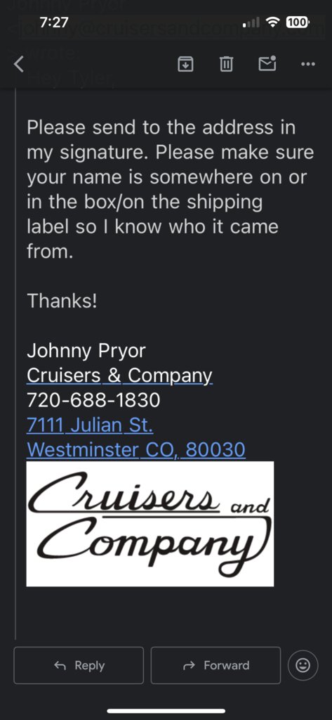

    I never received documentation on where to ship my stock valve to for core return. Anyone care to share where to ship the core?
    4 drain and fills complete and trans shifts quick and feels great. Next up install boost gauge/afr combo and traction bars, then maybe just maybe it's 76mm pulley time!
  22. Aug 20, 2025 at 5:13 AM
    bflooks
    bflooks New Member
    May 9, 2020
    #46273
    2,346
    Metrowest MA
    Just ship it back to Johnny at Cruisers
    Label it with your order number or last name so he can track who it belongs to

    Can confirm. This is what Johnny had me do.
