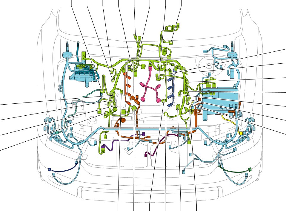

    All of your electrical gremlins are on the green harness pictured below, MAF, SAIS, O2, Trans...
    Check the connections in the driver's side relay/fuse box as well as the connections in the passenger side junction box (pull connectors out and visually inspect pins for damage or debris)
    Check any other connections along the harness (pull connectors out and visually inspect pins for damage or debris)
    While you are doing that, look for any damage to the harness that could indicate a problem.

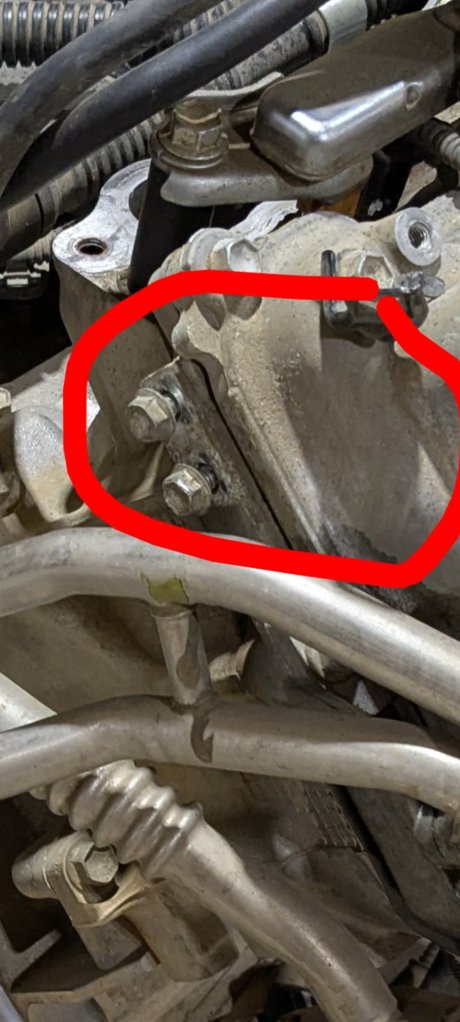

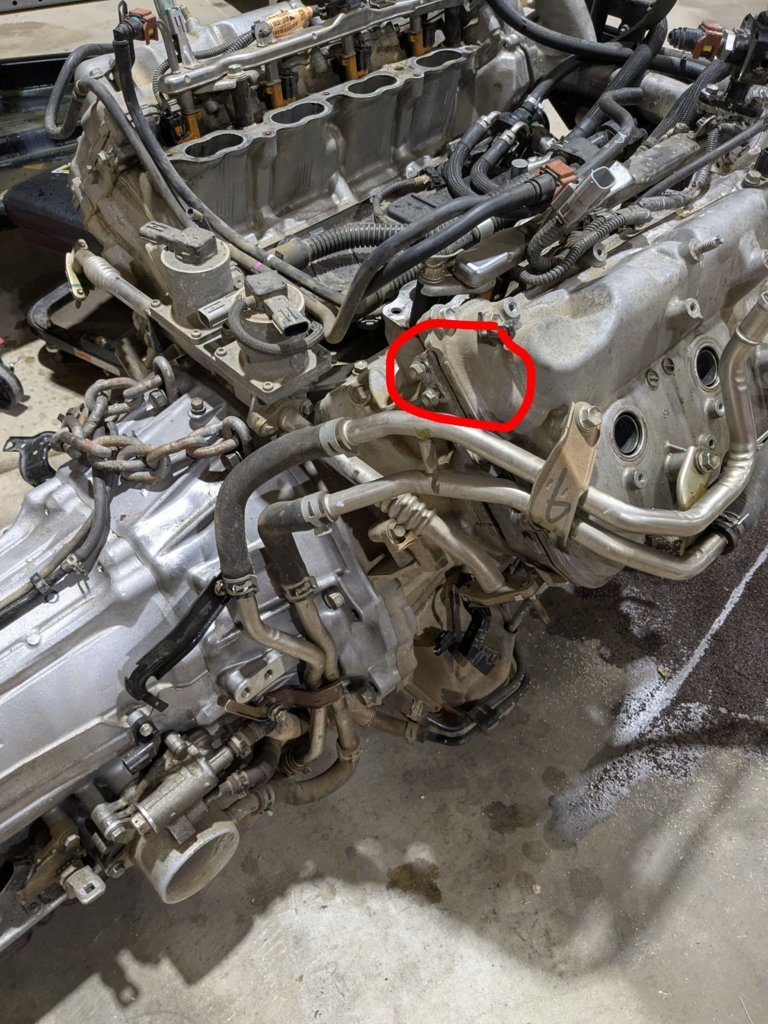

    Adding a ground I don't think will help, it sounds like the issue might be that harness is not grounded---not the valve cover lacking a ground.

    Not really, find the harness wires (they're probably floating somewhere) and hook them up. I've only been half paying attention to this thread, but if I followed what @mustang67408 was saying, it's these two ground points. I remember them from Reys engine since there's about a thousand wires that tie into two ground tabs. If these are not connected on your head that's probably a lot if not all the issues.
