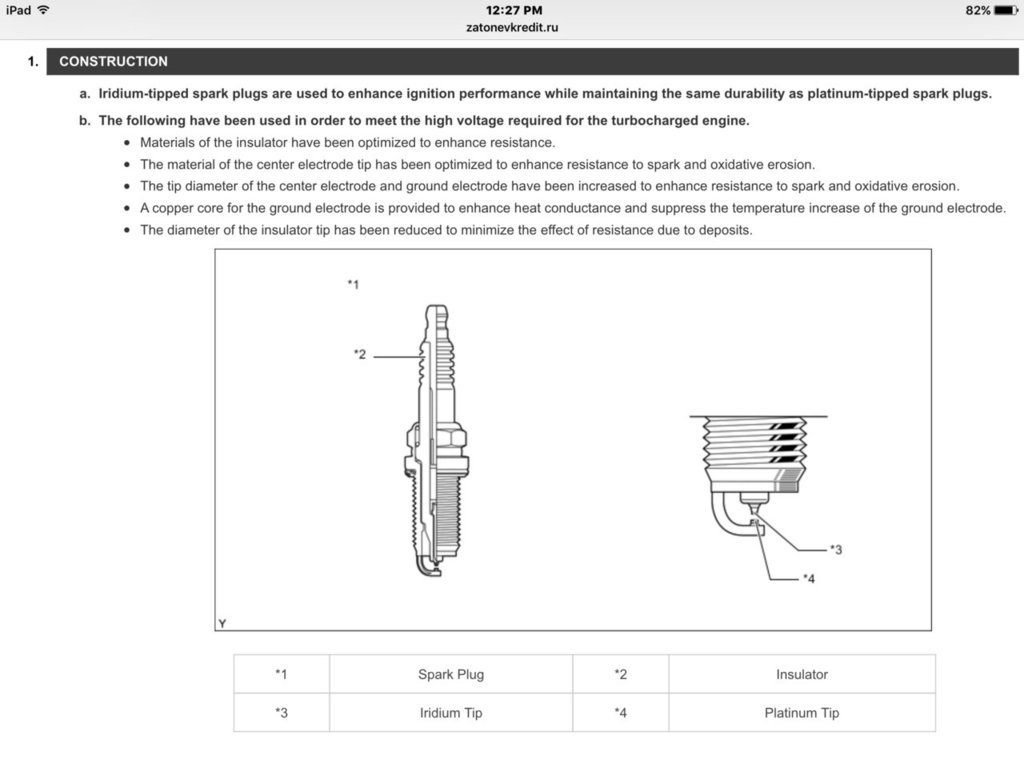

    Have to mention the DILFR7K9G plug (same heat range as the 22). Toyota’s choice for boosted engines.

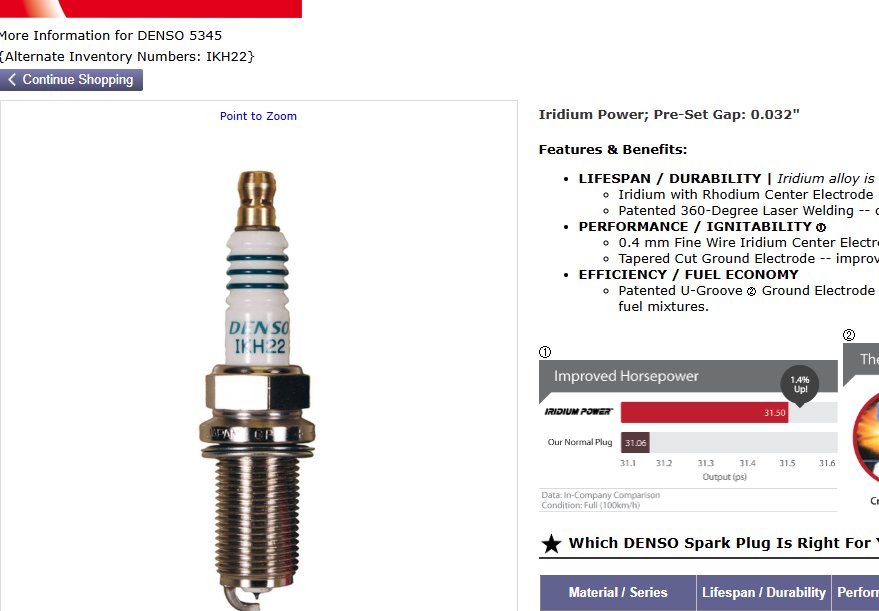

    Rockauto has Denso 5345's for $6 and some change. It seems like thats the same as the IKH22's? Not sure because the Whipple states in RED to use "IKH22"

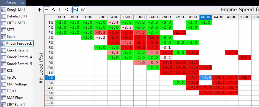

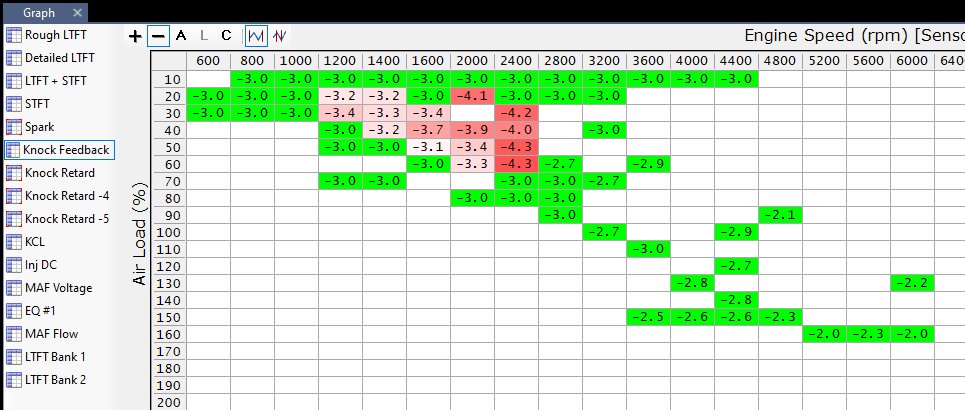

    Update on the guy a few weeks ago who had crazy knock feedback. To reiterate, gnarly knock feedback, he puts in seafoam and that seems to stop (or reduce) some noise he was hearing (timing chain perhaps?) and that then stopped the knock retard. Get an email today, he says the noise has come back and so has the knock retard!
    Same exact tune and setup, one week ago:
    Absolutely wild, but also cool and very good data because we're seeing a direct relationship between (excessive) mechanical noise and knock feedback. I am confused as to why seafoam would fix the issue, and if it did why that wouldn't be a pseudo-permanent fix, you would think if it broke gunk free or freed up the motion of parts that it would be a one and done type deal.

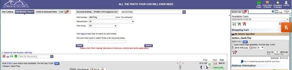

    More than double the price of IKH22, is it that good?

    Timing guide?

    That or the tensioner is my guess, I doubt it jumped timing but he seemed to think the sound was coming from the timing area. But why seafoam would change that at all and then get worse I don't understand.

    To piggy back on what Rey said; timing guide tensioner crapping out or bleeding off, or sticking from some gunk?

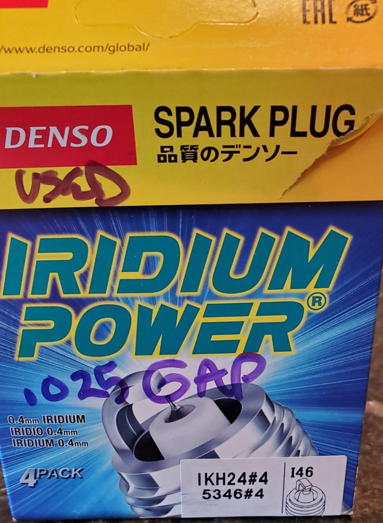

    Rock auto goes by the part number. My ikh24 are just a step colder. Just that rock auto shipping can be more $.

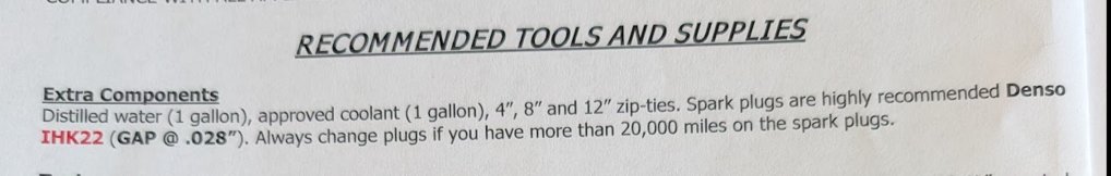

    Every time i'm searching for Denso IHK22 it comes up with Desno 5345, but it looks like the 5345 are IKH22, not IHK22. I'm assuming that the IHK's are a step colder?
    Rockauto only has the IKH22's it looks like.....anyone have a link to the correct ones?

    IHK has got to be an typo transposing the H and the K. I searched IHK and all the results came up IKH. Temp ranges of spark plugs are indicated by numerals, in this conversation 24 is one heat range colder than 22.

    They are a more durable and likely better performing plug due to several features. Is the extra price worth it? Debatable.

    Ouch. Wonder if any increase in life.
    It's a typo by Whipple.

    That's with a volume discount for buying more than 4!

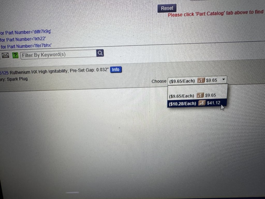

    The SC Tacoma guys run this VW/Audi plug. It’s another step past the DILFR7K9G.
    NGK Ruthenium LFER7BHX

    e30cabrio
    Oct 20, 2017
    #10410
    6,530
    West Valley, Phoenix, Az.
    Boosted 2013 Sequoia TRD FAUX
    Volume increase!! Never saw that before!
