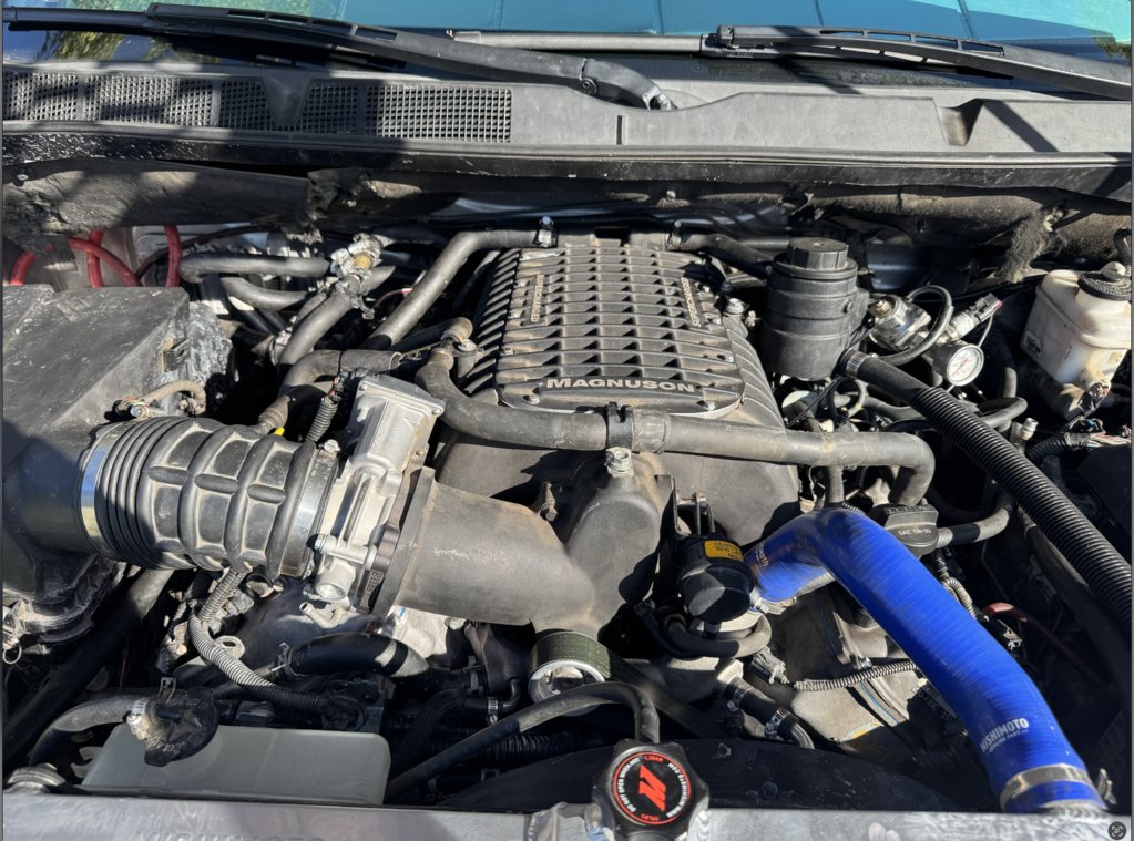

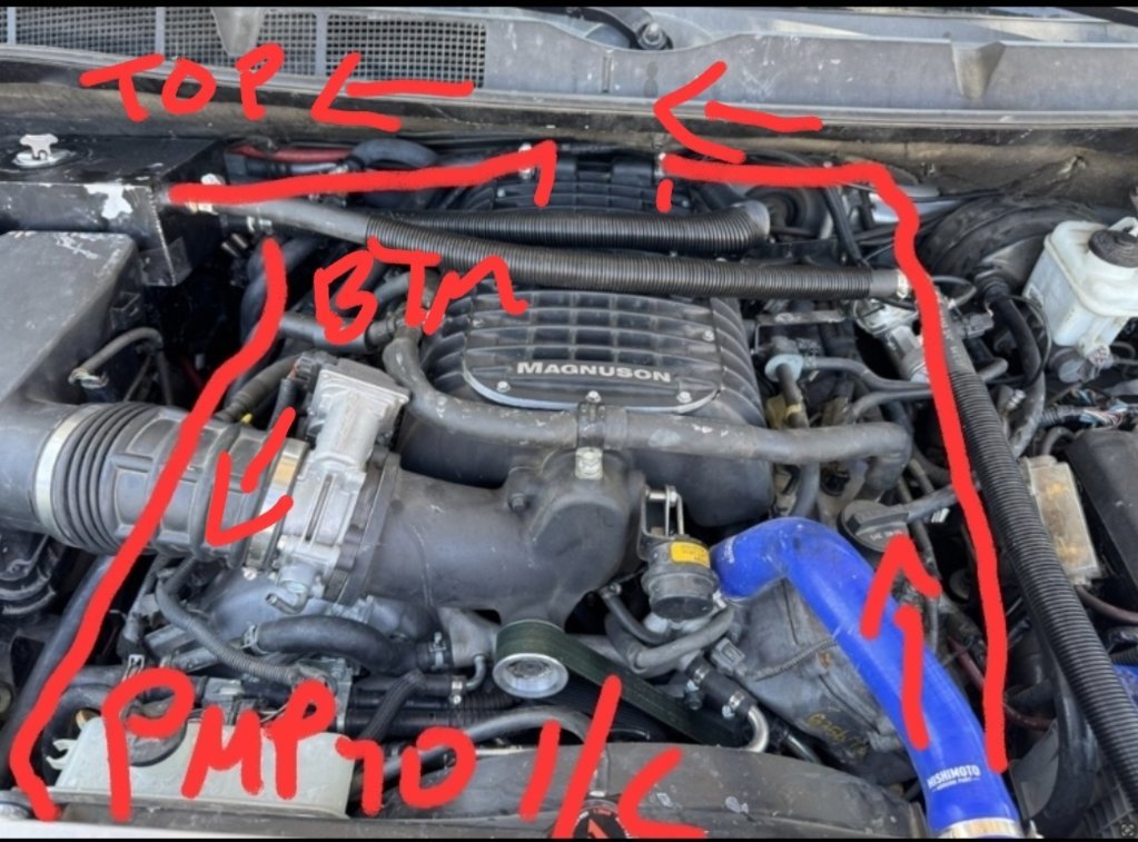

    This is before I reverted to the Magnuson reservoir.

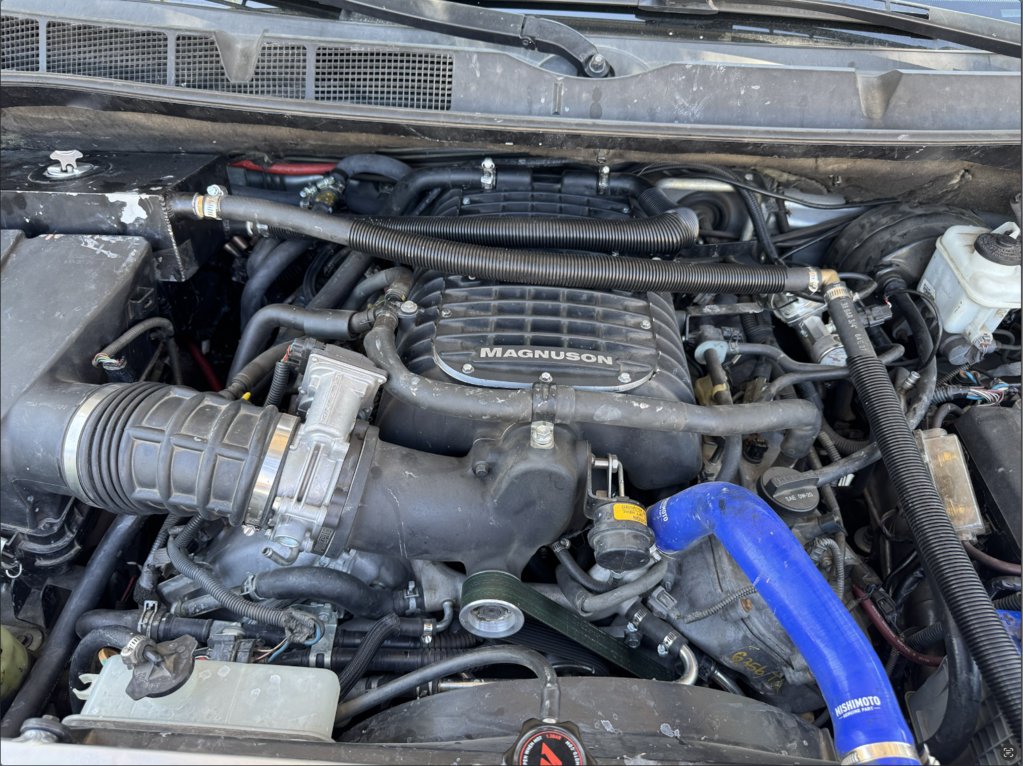

    This is now.

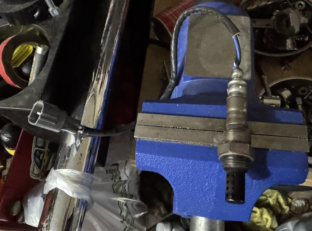

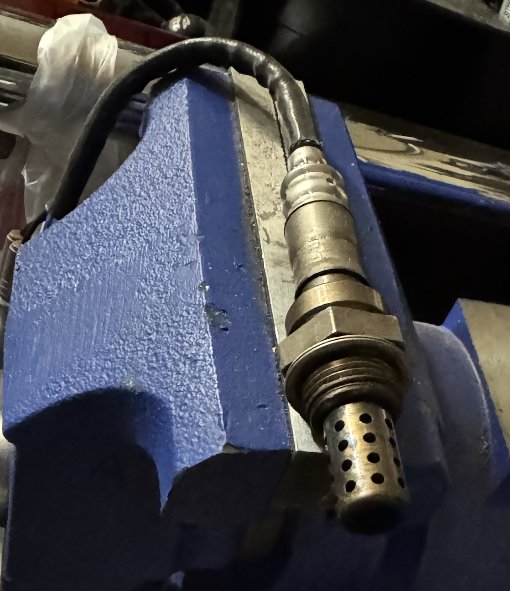

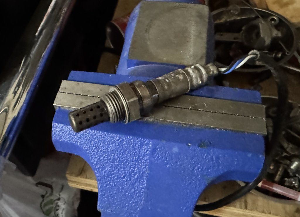

    Downstream O2's have less than 2k on them, were throwing heater 37 & 57 errors. Do you guys think cleaning them helped them? (new ones are in)

    I'm just the peanut gallery but if I could suggest a re-route of your setup.
    Bottom port from tank to pump. Pump to I/C, I/C to SC i/c brick out to top port of tank.
    My O2's needed a thorough cleaning after they were covered in oil. But they only survived another year before replacing.

    With the large tank is how the shop gave it back, I have it the way you suggest now (I think)

    Cool. And for your new tank. You want to have bottom port to pump and return on top. Just to keep system from getting airborne and longevity.
