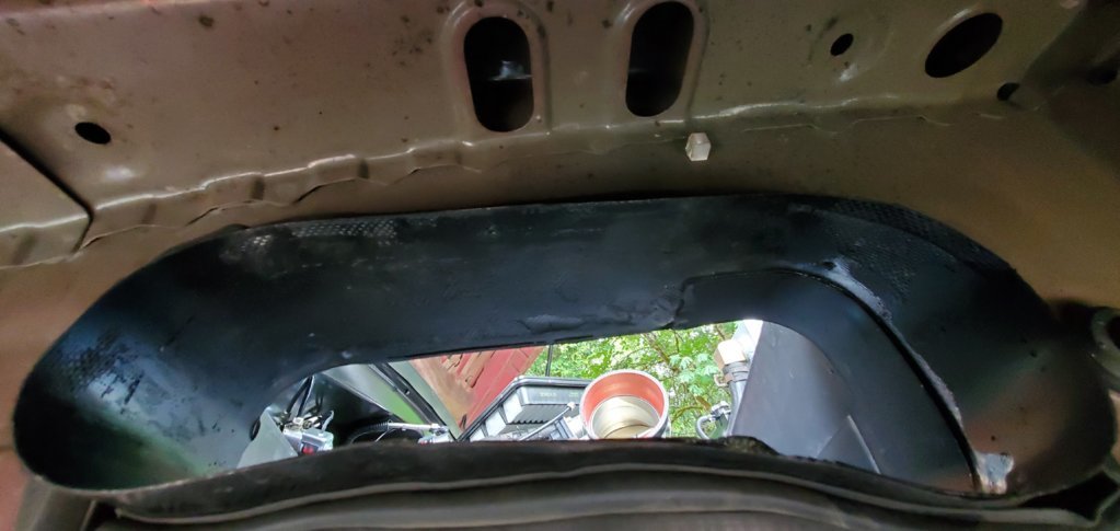

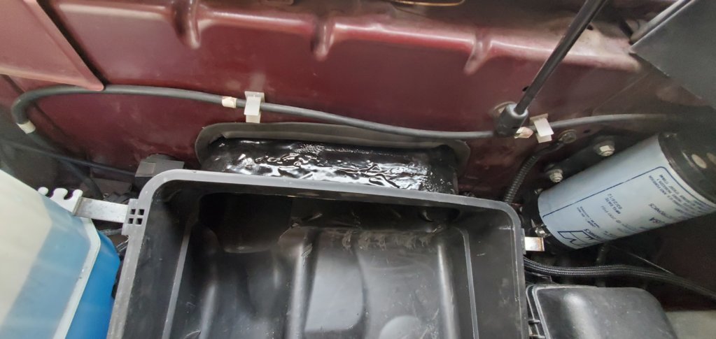

    Got most of it done, will get a screen/louver for opening. Easy enoughvto remove and trim the end. Gotta get some gravel and bark mulch so need to take the truck out.

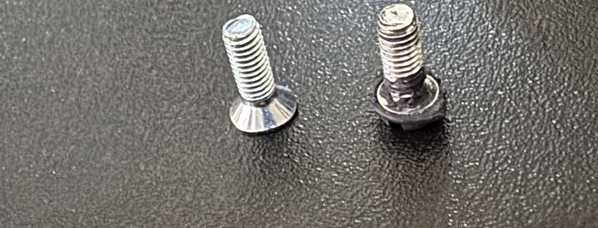

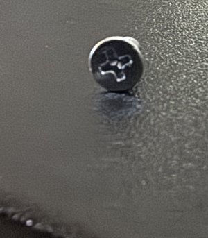

    I had these screws slightly thicker that worked perfectly.

    So much air!! Make sure those louvers are rigid! The ecoboost raptors suck in so much air after a tune, the intake inlet bends and deforms to almost choke it off! Their fix is CF inlets for those Cobb tunes now that don't deform

    I could have just made a rectangle box out of aluminum and squared up the fender and lower air box. I had some fiberglass tape and resin left over from a drift boat project. Will reinforce the opening.

    Oh, dont get me wrong, it looks badass and functional! I like tis route more than the squared up version, just thinking outloud, you'll likely be fine until you're at 20psi :bananadance:
