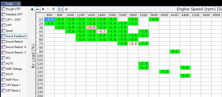

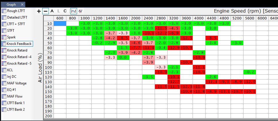

    Some very curious results from another customer, I had mentioned this guy a few weeks ago about what could be causing the knock sensors to register incorrectly. This was with a stock Magnuson tune:
    And a tune from myself looked the same if not worse. We've been trying to solve the issue. Last week he put Lucas Oil type seafoam through the engine and gas tank, and same exact tune now looks like this:
    He said the engine seemed to have less ticking noise, but by the end of the gas tank was coming back so would grab another log. He was planning on replacing the timing chain tensioners and guides since they sounded sloppy, and then also the knock sensors and harness. But he hasn't done any of that yet, just put cleaner through the engine and gas tank and that seemed to remove all the weird knock events he was seeing.

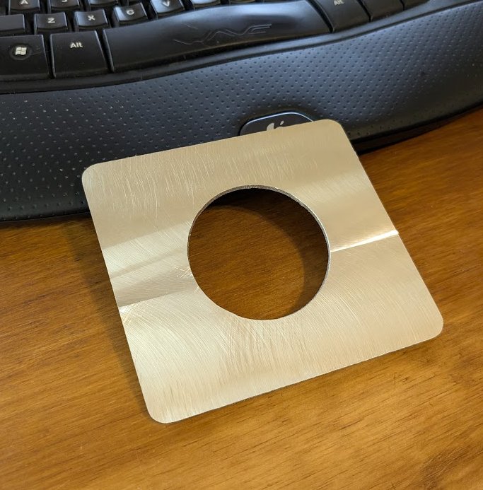

    Center console gauge mount for a 07-13 truck I just did and tried using the flycutter for the surface finish and it turned out awesome looking!
    I need to cut out more of the 14-21 center console mounts and send to a few people on here for some critique on how to make them better, but that's on the backburner since it's a lot more complicated than a flat plate.

    Looks great! My black acrylic one is getting scratched up. Will have to grab one. Maybe combine ship with little 1900 pulley when you get it.

    Badass! That looks like a legit piece! Nothing is better than form AND function! When are you swapping yours out, now?!
