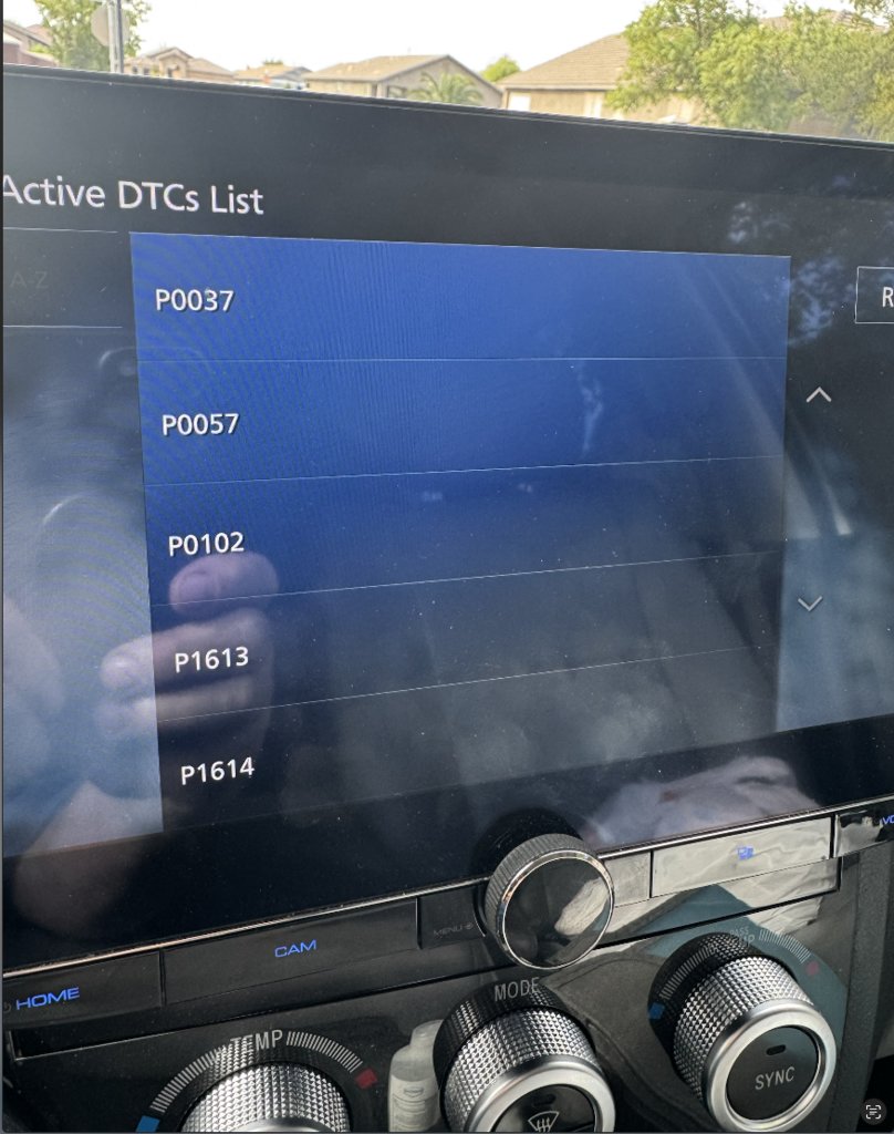

    After sitting in the Panda "express" drive through for 25 minutes IAT was reporting 150 (114 ambient) highest I have ever seen in the Sequoia, I got these DTCs
    I flushed the coolant 6x more (now at 10) mostly coolant & water wetter came out but there was some oil. I also restored the original Magnuson reservoir.
    All the codes except the damn secondary air clear, it comes back immediately & if I clear it when the truck is running the motor dies. It's in super limp mode while the code is there
    Can HP Tuner tune it out? If so can anyone tell me how as sniv is out of town.
    If not can I get the Hewitt kit & just do the wiring harness part? I really don't want to mess with the blockoff.
    I just can't get a break OH, and to prove that, I got a Federal Jury summons today. KMN

    Until sniv returns I can disable codes if you want. Usually limp mode is not enabled on the tune. How are air pump connections, passenger fender? Check the power connectio s by dipstick and drivers connection by fuse block.
    I did a test when my I/C pump was disabled at 88deg F. I ran 2 WOT runs and had knock retard in the 5's and 2 events in 6's which was not present with normal lower temps. Also happened around 3500-4000rpm. Wonder how you guys in the heat deal with it?

    Thanks, I started a conversation

    I found this thread on HP Forum, I do not find the values it refers to, maybe it's 2007 only? I did find them in diags but the codes are numbered differently. I made a file unchecking the diag boxes in these pictures, no more air codes, but 101 is now permanent, seems my turbokts MAFs don't like me. I'm going to throw the OEM MAF in & see what happens after it cools down some, it's 114 & IATS reported to be at 161 when idling.
    https://forum.hptuners.com/showthread.php?82531-Tundra-SAI
