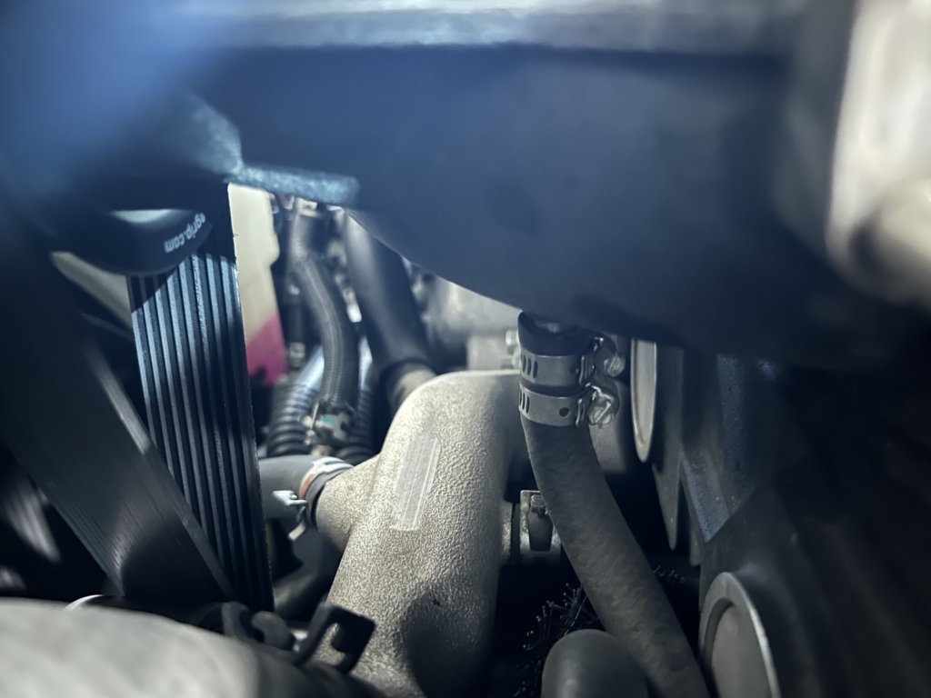

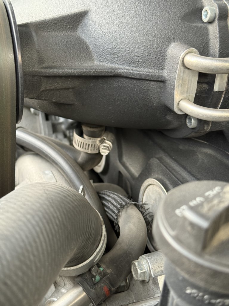

    I’m talking about this guy here by the crossover pipe. That reminds me, I still have that intake honeycomb before my MAF as well, and that was actually what resolved my P0101 codes paired with a new tune. Maybe your honeycomb shifted in the pipe and is messing up your MAF? Mine was a tight fit and I added a couple rivets.

    The double clamped hose underneath the snout (looking through the install manual the others are coolant)? I'll take a look at it when I get the truck back next week. What symptoms did you have and how did you detect the issue?
    My honeycomb is straight in and not moving. It was riveted in by MRP when they built my custom MAF intake tube. It is also at the 3.5" from the MAF which meets their recommendation for distance from the MAF. The fins aren't damaged either.
    Did you retune when you installed the honeycomb or was it running like shit and the honeycomb fixed it?
    I asked MRP about the screen, they basically said they have customers who install them on OEM applications without retuning and they work fine. I doubt its causing any issue just eliminating it as a potential cause. Mine was in before retuning.

    When I had my 101 code, right after install
    it was that connection under the snout
    it looked tight but it wasn’t
    only got the code in boost situations
    I put a mondo pipe band on it. All is well

    Well shit! This is probably my culprit.
    Is it 10d in the install manual?
