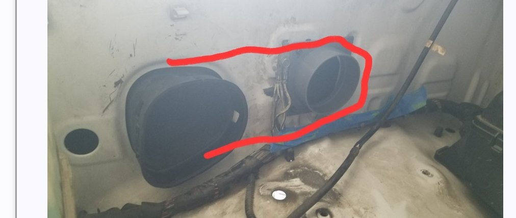

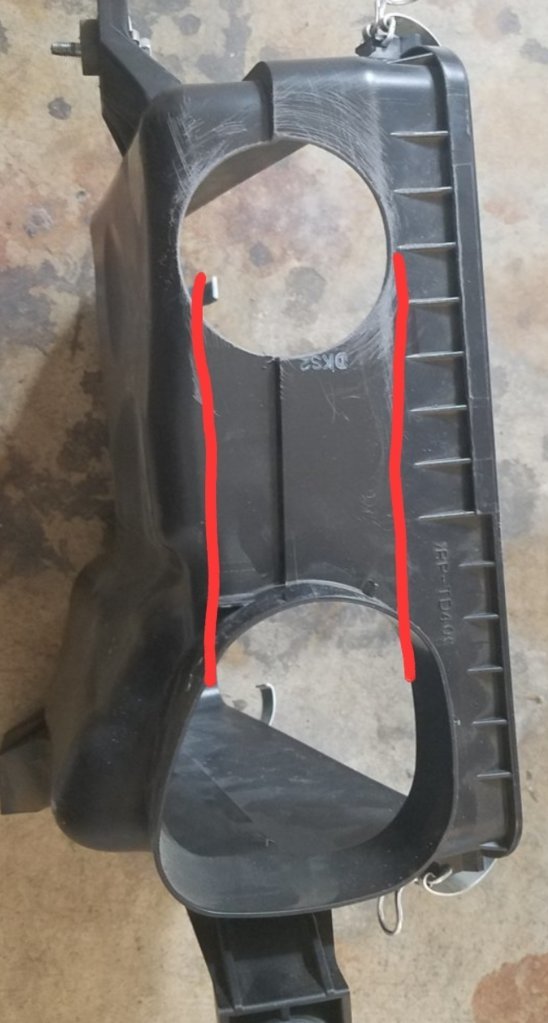

    Opened up the side of the airbox to combine the air accelerator and SABM. I didnt get to finish as I got company coming. Will use some roof flashing as a mold to fiberglass a section into the fender well. The flashing contours to the accelerator cutout well.
    Anyways I ran to the store and picked up a full psi of boost. Hit 15 psi and it was pulling really well.
    I grabbed some pics from the SABM mod thread.

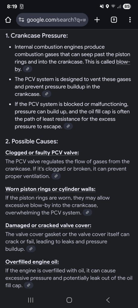

    Possible causes...
    Wynnded, Saltyhero13 and Mdl like this.
