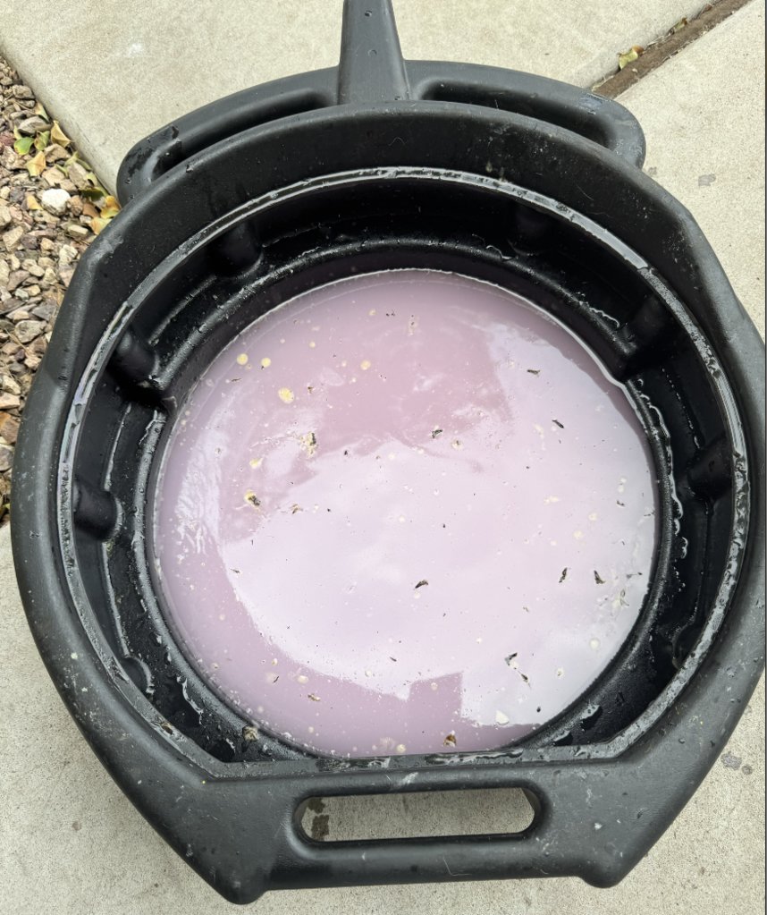

    3rd drain & fill, hopefully all the oil is out.

    That is so strange! I'm still scratching my noggin how oil got in there. Almost like someone poured oil in there?

    Could possibly be part of what took them so long. Someone has an oh shit moment when they realize what they did.

    It can happen. Especially when a shop that may not deal with aftermarket parts/tanks/wiring. I'm sure some would scratch their heads seeing some of our setups.

    Maybe they drained the coolant into a contaminated container and then refilled from the same...

    I'd be tempted to fill with water and a bottle of radiator flush chem, then drain/flush some more to make sure any oil is broken down and out.

    I did, this was the flush after that.
    Edit
    Apparently the frozen intercooler holds a lot of coolant. It was still coming out pink after that drain with just wasted distilled water.

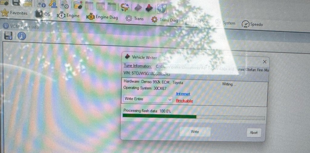

    Anyone seen HPT crash at 100% just before the turn off 10 seconds, hit ok" message?
    sniv's latest tune won't write :( I created a case with HPT, I'm sure they'll respond this week. :p

    Only when I have a bad internet connection. I've had luck running an ethernet Lan cable and it would write after the processing.

    Although wifi & ethernet were giving over 100 down & 50 up it worked on the cable, thanks!

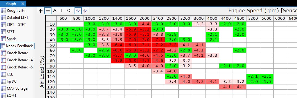

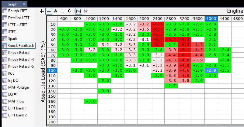

    Is it possible to get a wrench on the knock sensors with the 1900 on? sniv says I have a ton of knock retarding my timing. I'd like to see if any are loose.

    Mdl Hey there...
    Jun 14, 2023
    #98638
    3,612
    PNW, WA
    2007 TRD SC'd
    JBA Longtubes, Snivs 2.0 SC pulley, ASP crank overdrive pulley 6.71 in, DD Full 3inch dual exhaust, IPT valve body, Airbox mod, 4.5inch intake, Denso 750, 450 Walbro, W/M injection, GM 95mm TB, SABM, Camburg UCA, Icon shocks, Speedmaster LSD, Motive 5.29 Gears, Mickey Thompson Baja Legend EXP 35's, Solid Offroad engine and transmission mounts, DIY Traction Bars, Tuning by Snivspeedshop.com
    It's pretty tight. I can reach 2 since deleting the aip tunes. If you need any I have a good set from an engine with 65k on them for diagnosing.

    Thanks. All 4 were OEM new in December.
    There was no knock issue on the old motor. I'm hoping one is lose.
    I just searched images of it, thinking it's not possible.
    I'd really like to know why I cannot get a break.

    It's my favorite vehicle, but I don't "need" it if it is loose sensors; the shop I just paid 5k to install the motor will be dealing with it.
    I really don't want to bring it back there, though.
    Edit, how do we tell what the cause of the knock retard is?
    Here are the graphs, less red is after timing was pulled, sniv can better express what he did.
