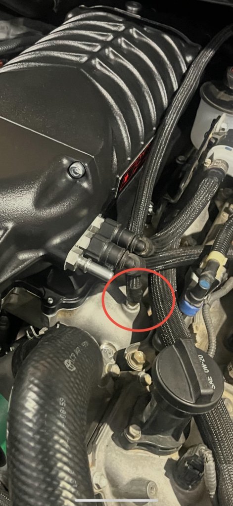

    No, I didn't see that one, thought it was just a hose dangling there...my bad. I thought you were referring to the one up top. That one will work for boost reference.

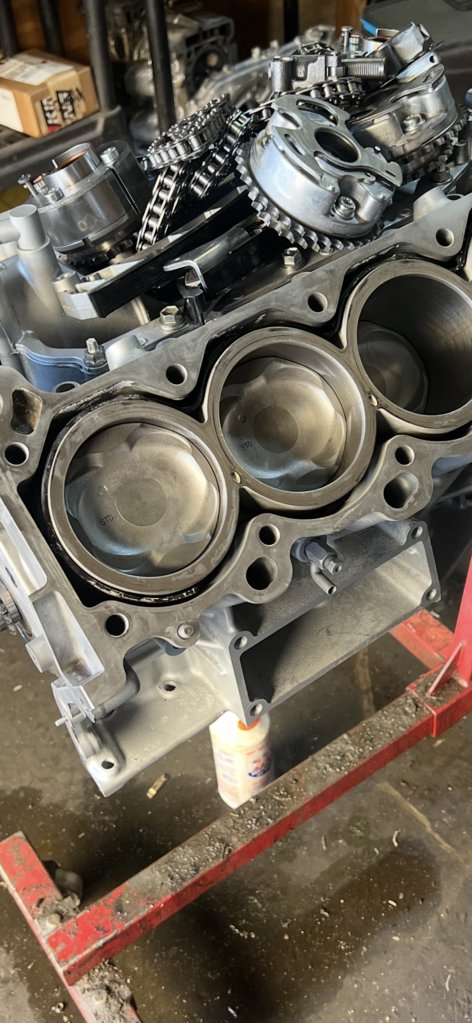

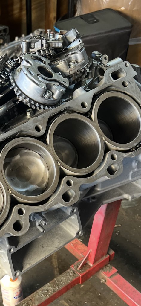

    The forged pistons will take a lot more abuse, so the jackets are probably not much of a concern. The stock cast pistons are simply too brittle to take the heat in the longer term. It will be nice if we can find or gather up some data on what trimming them for improved flow will do.

    Not sure if that one photo shows an as molded or a trimmed version is talked about, but hopefully it is a helpful example as this gets explored.

    Be a good question for xat. Show some destroyed piston pics.

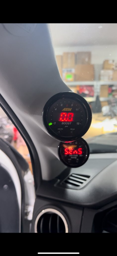

    Some gauges use a map sensor mounted to firewall then send wires to gauge. I have an older AEM with said hose through firewall. I just usually drill larger holes with grommets if needed. Too much hassel trying to send it through existing wire runs.

    Looks as molded.

    Looks like mine went in.

    Up until this morning, I too would have taken them as they came from Toyota and put them back in.

    Well yea lol but I was talking about the manifold spot. Driver side has less in the way.

    I know it's early in the process, but to be clear, you are thinking this is a factory internals issue only, with a belief that forged upgrades and larger/proper ring gap for intended use case negates the concern?
    I'm going to inquire with XAT about it and just want to make sure the theory I'm presenting is correct as I attempt to get confirmation they have not seen the issues Rey did with any of their builds.

    I think my use case of damage is from how hard I was running during a dune day in thick wet dune sand with multiple hrs of boost hard runs over large whoops and jumps etc. I think this day played a huge roll in the damage. Then eventually later everything as we see failed after my abuse on the way to Vegas and during my runs in Vegas
    Even though we say no high oil/coolant temps doesn’t mean cylinder pressure and temps weren’t hot. I think I saw a high 226 pan temp at the worst time. This was the day we smoked the trans also.

    Yes. He actually was the only one I ever saw mention these water jackets before also, but I doubt I’ll ever find that specific comment he made on a post again.

    I've only seen or heard of one out of the many built forged 3urfe have issues. It was do to improper break in where a few of the rings didn't seat well. It had a little excessive oil consumption.
    I'd have full confidence in your build!

    Only is a little strong here IMO… I’m a never say never type of guy. Detonation will pop even the best forged pistons. The hypothesis is that this is contributing to heat on the intake side of the piston and that contributes to the rings needing a larger gap and possibly detonation. The forged pistons and ring gaps in your XAT engine will go a long way towards dealing with it. As @Mdl says, have confidence in it.

    Most 5.7 failures we hear about are due to racing, and Reys circumstance was doing about the same to the engine or worse. For a "normal" person I would not be at all worried. Even if you lean into the boost a lot, I think you'd be very hard pressed to push the engine to its limit on public roads (unless you're just at WOT, then slam brakes, WOT, on repeat). Get a good tune and lots of fueling and don't think twice about it. My truck has 300k+ on it with 90k+ boosted and I have zero worry using my truck again WOT to 100+mph.
    Reys piston seems (hopefully) to be a fluke and result of getting absolutely romped on. And we've seen other engines fail, but similar situation like holding 150mph for extended periods and the like. A normal street supercharger wont normally see that so I wouldn't be worried.

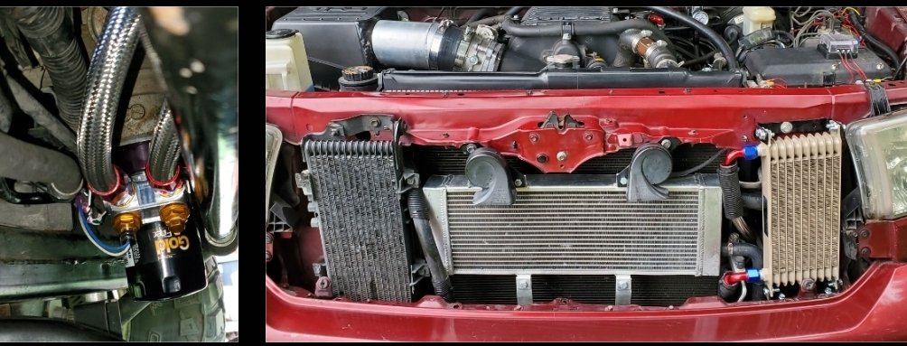

    Do you happen to know what size the adapter is connecting the thermo plate to the Baxter unit, I have a forged Motorsports oil cooler(20x1.5 came in the kit)on my commuter car I'm not using. Thinking the hoses may even reach as well.

    I believe the Baxter kit ts601bk with a 3/4-16. Most sandwchich plates come with both 3/4-16 and m20-1.5. Using a wix 51516 filter with 3/4.
