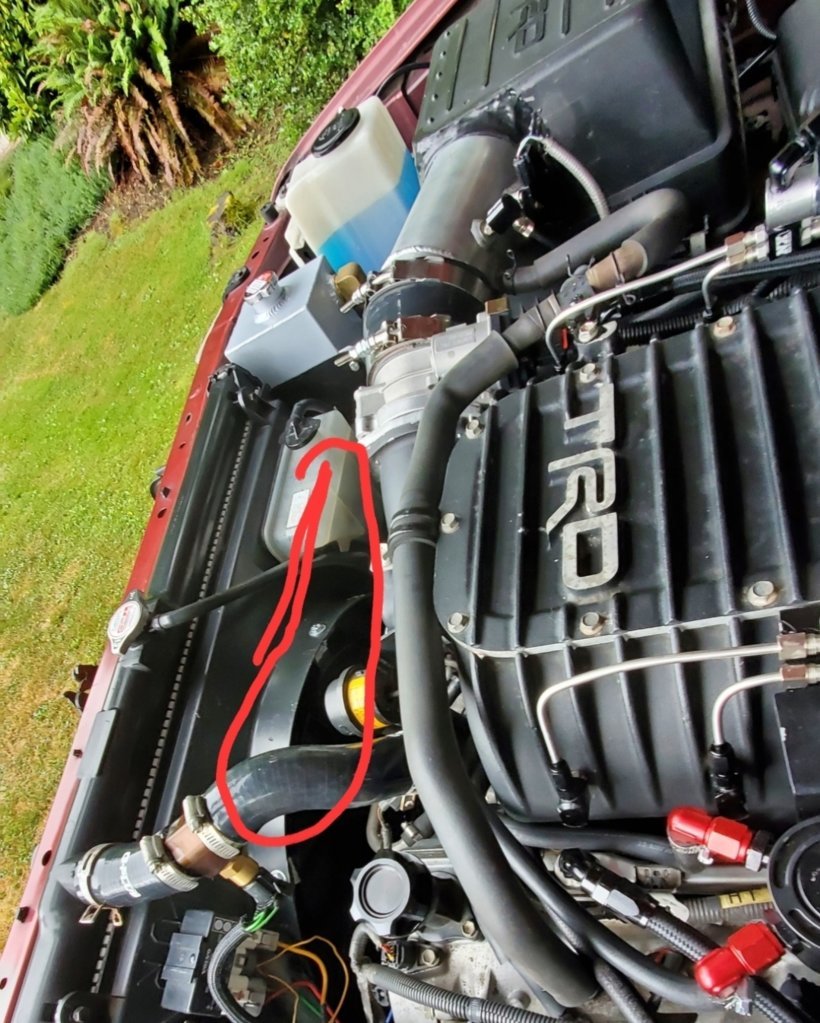

    Thanks, hoping it's worth the effort...

    Not yet. I'm waiting for the snow washer bung to show up and relocate my W/M pump. I'll try and mock it up later on.

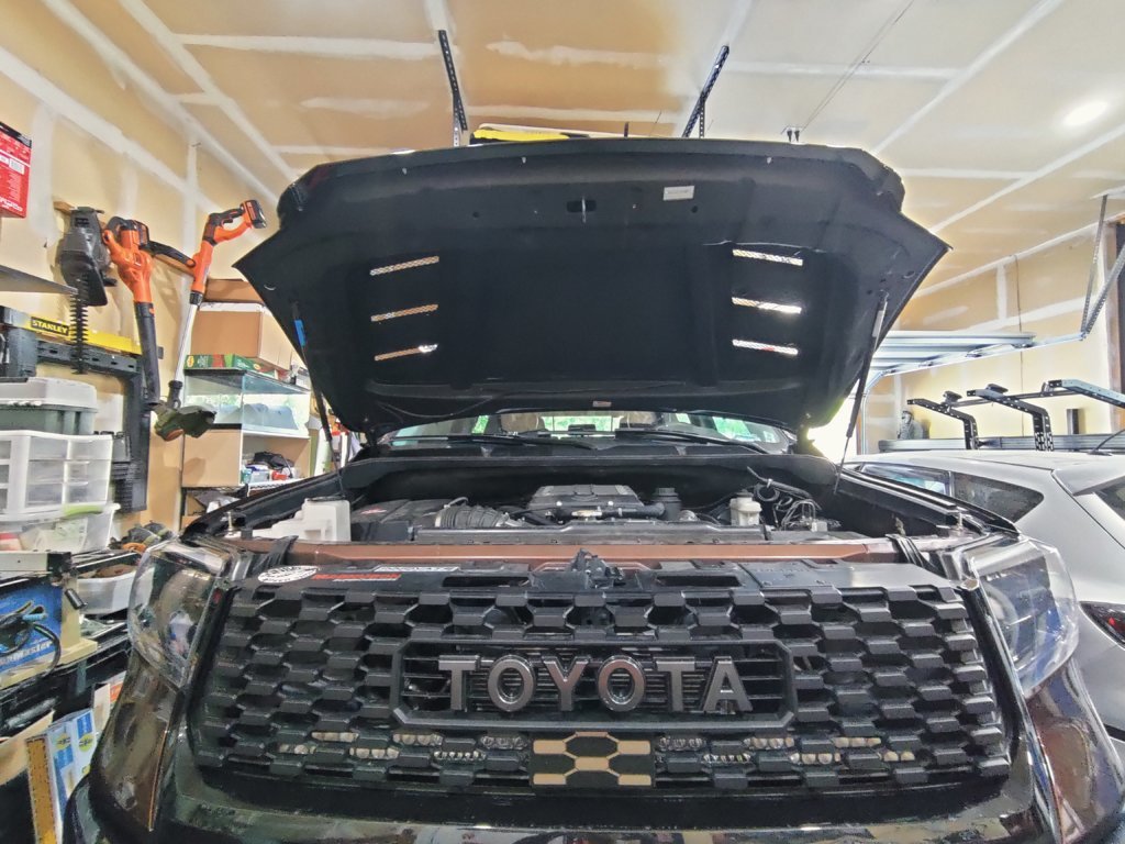

    With the CF hood I have no worries about water or snow with where the vents sit.

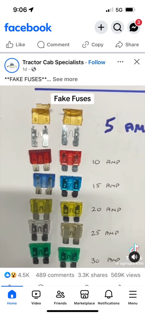

    Watch out for fake fuses. Rather scary actually.
    Also @armyoffoo you may consider upping the size of the fuse. If that fan draws 28 full load amps you should have some extra headroom for starting inrush current. You realistically probably want a 35 or 40 amp fuse.

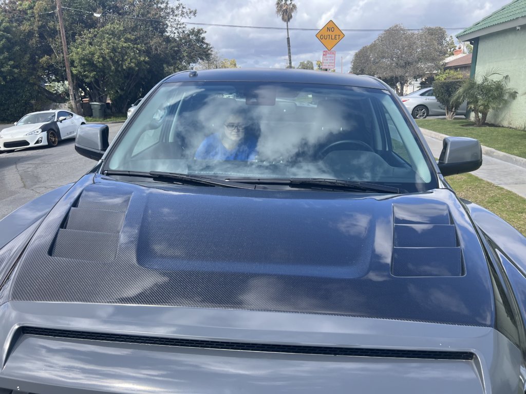

    Could you snap a photo of where the water falls? My question is self-serving due to turbo mounting location. It's the biggest reason I haven't just submitted to the fact it's the right solution for me.

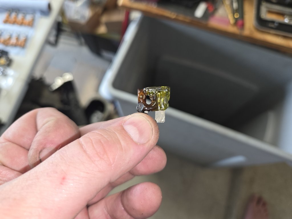

    I had my front light bar blow a 5 amp fuse last night. One leg on the fuse was so loose I could pull it out. Got new spares at NAPA.
    Silver17[QUOTED] likes this.

    I'll fab up a rain guard where it'll divert rain to front passenger side of radiator shroud. I have my Volvo e-fan relay mounted on my shroud but is clear of the opening. In rain and off roading water gets up there anyways.

    On the 2.5 on up with the bepressed front hood is a decent place. I just pulled a photo from the turbo thread where @Jego was deciding what direction he'll go with heat extraction.

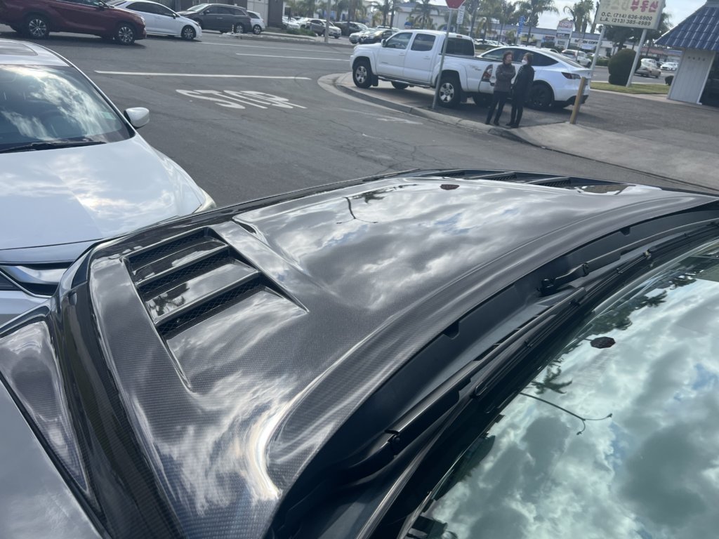

    Yeah, I was curious about the CF hood, too. The DIYs we can place and mod as needed, but I'm still curious about the prefabricated solutions. I dig some of those designs but it's a big gamble since I'd be looking for paint matched, too. Hate to learn it dumps water directly on my turbo, which could be problematic from a thermal shock perspective, or not at all? IDK, I'm just concerned about dumping cold shit directly onto my hot shit.

    Just to update: I washed my truck and sprayed water up/down/above the hood. Water went right on front pulley and fan shroud as I thought it would.
