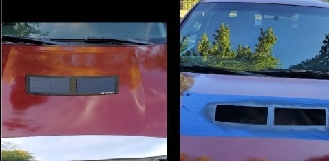

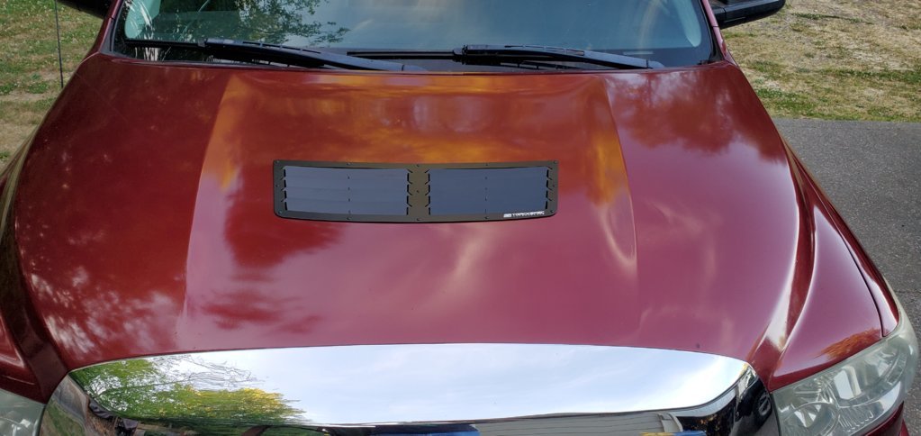

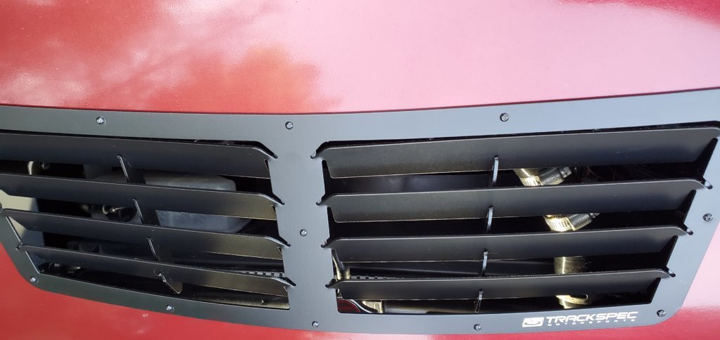

    Well I cut the hood. Got the heat extraction louvers installed. It was a pain to get a straight line on this curvy hood. It is a smaller one but it fits exactly over the area I wanted. Will fab up a rain guard for winter.

    Looks great!

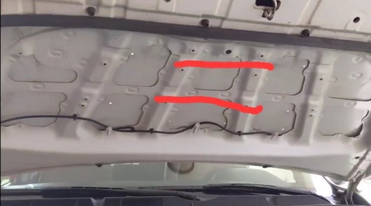

    Alright, talk dirty to me. Did you lose the heat/sound material underneath or just cut it? How does this line up with undehood components? In my head this would pour water on the belt area, no? And do you have any wider shots to better appreciate aesthetics? I like it, just trying to think through it. Solid work taking the plunge!
    Jego, mustang67408, e30cabrio and 3 others like this.

    Being 2nd owner and a 2007 I didn't have any insulation but it would be cut/removed. For a 2nd Gen there will be 3 supports to cut for the forward section and only 2 on later models. Rain water will get in but this size keeps it away from the battery and fuse box. It will be over the fan shroud area. I'm going to make a rain guard that will divert the water forward to the shroud area
    I went with trackspec to have the center support but it relies on the sunroof principle where the frame strengthens the area its in. There are several types of louvers from Race Louvers, Trackspec, Versus etc. There are bigger vents too and side vents. @ARES35 has a louvered/vented hood on for a little bit now and most aren't concerned with the rain/water. I'll try and get a better pic angle.

    Thanks for those photos! Fully getting it now. That would be really subtle color.marched, too, without needing hood pins. Great job!

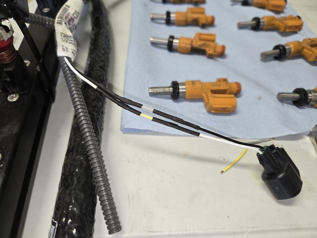

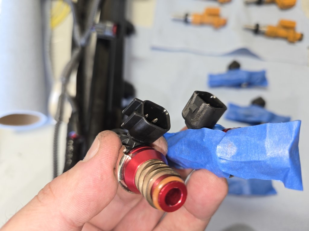

    For anyone interested in these injectors, I had to modify the plugs and part of the injector to get them installed...so not plug and play. I also had to extend my injector harness 1 1/4 inches so it would reach the injectors for cylinders 1 & 2.
    Rain came pouring down again when I was reconnecting my fuel lines, so I haven't tested for leaks yet. I still have a list of stuff to do before I'm up and running on the Haltech...
    Modified plug on right, unmodified plug on left
    Modified injector on right, unmodified injector on left
    Extended harness (Cylinder 1 & 2)
