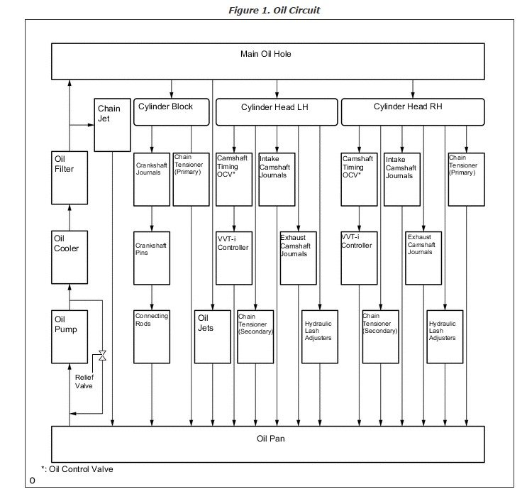

    The crank looks normal to me, manufacturing discoloration..
    My first thought was squirter plugged. We've had an old supra where one of the squirters fell out and it torched the piston from the bottom side..
    Overheating and very hot oil burned the piston? But why not the others?
    I assume all the Dots on the top of the piston were facing forward.. I've seen techs put them in backwards and it doesn't end well usually ..
    Definitely got hot, all the scratches on the cylinder wall... not a common issue

    Built motor lower compression more boost nothing crazy, address the elephant in the room on why this happened. If it was oil squirter plugged how do we prevent? Add an oil cooler as mentioned.
  9. Jul 6, 2025 at 8:54 PM
    armyoffoo
    armyoffoo Member
    Jun 4, 2018
    #15876
    1,439
    Cypress, TX
    2018 Black TRD Sport CrewMax
    Supercharged with all the trimmings
    No way the oil squirter caused that, oil doesn't have that kind of heat. How would it get plugged? Anything that is big enough to clog the oil squirter would cause bearing damage. That's from running too lean, or severe detonation, or both.

    Oil comes from the filter to the squirter (oil jet), so shouldn't be any warmer than what's in the pan.

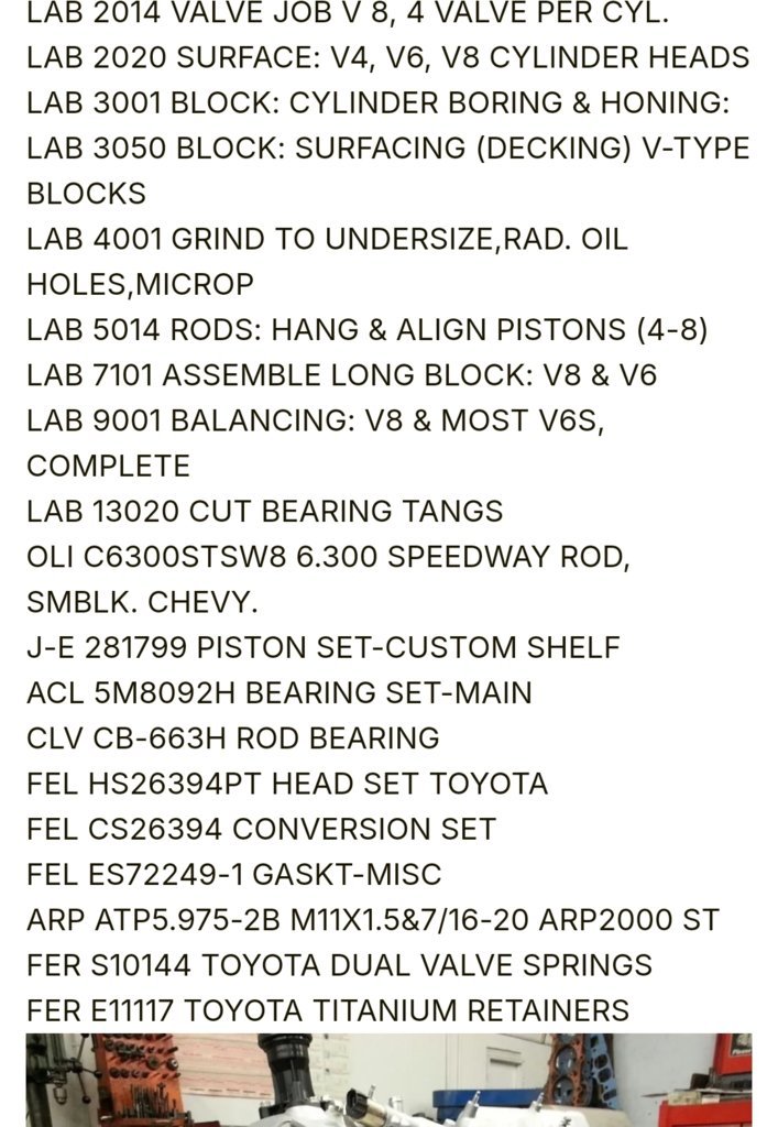

    So I'm beginning to do some digging into the piston options. Interesting find is no one offers an off the shelf piston for 9:1-9:5 to 1. Only 10:1 JE is the only option for that as a custom piston starting at $2500.
