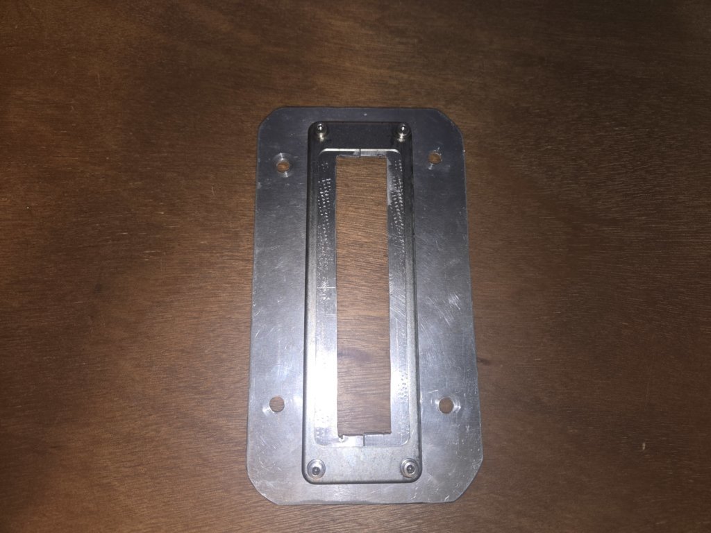

    This Harrop is still available if anyone wants me to look...good price-ish:

    A) how is this similar?
    B) what is it/ why am I thinking Breaking Bad meth lab?

    Haha, man, "trying times" make great deals for those whom are patient! Imagine what you could make with a $130k machine at 70% off! Also, boost!
    Honestly not sure what's going on with that CNC...perhaps he works there...also, perhaps it's a scam...not sure, but I'm educated on both items and have lived in this valley for 30 years...I could root.it out if interested...

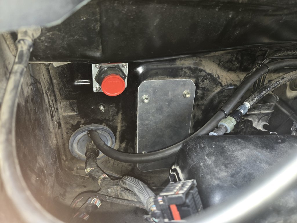

    Boomslang firewall mount completed, waiting on the rain to stop then I'll mount it, figure out how to mount/secure the stock ECU under the dash and then begin wiring accelerator pedal, throttle body and sensors...this weather sucks but at least it's not 110+
    It's not pretty, but it's good enough for who it's for. Original M6 bolts mount it to the firewall, M4 bolts mount the sandwich plate to the firewall adapter. I also re-pinned the injector harnesses with the ID 1050x plugs, so they are ready to install.

    @armyoffoo looking good! The wiring would drive me crazy and take 3x's as long. I'd be triple checking and re-checking.

    What's the giant red button?!?! I just wanna slap it lol

    It's a cover for the bulkhead wiring pass-through.

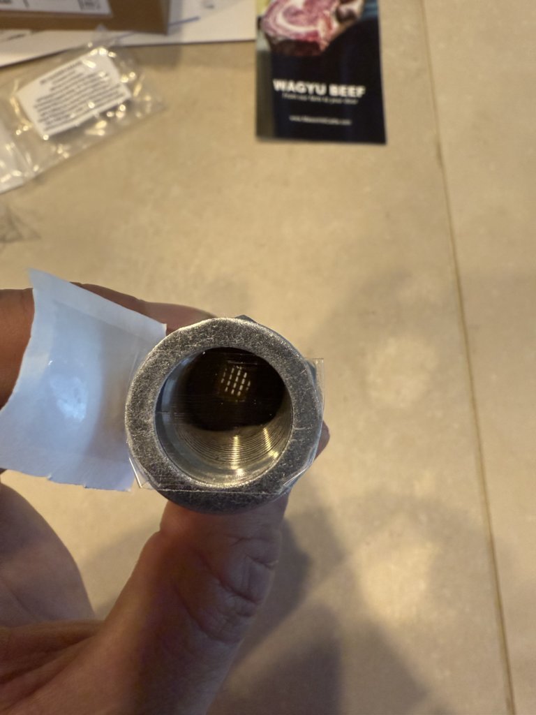

    Defaulers arrived we’ll see how they work.

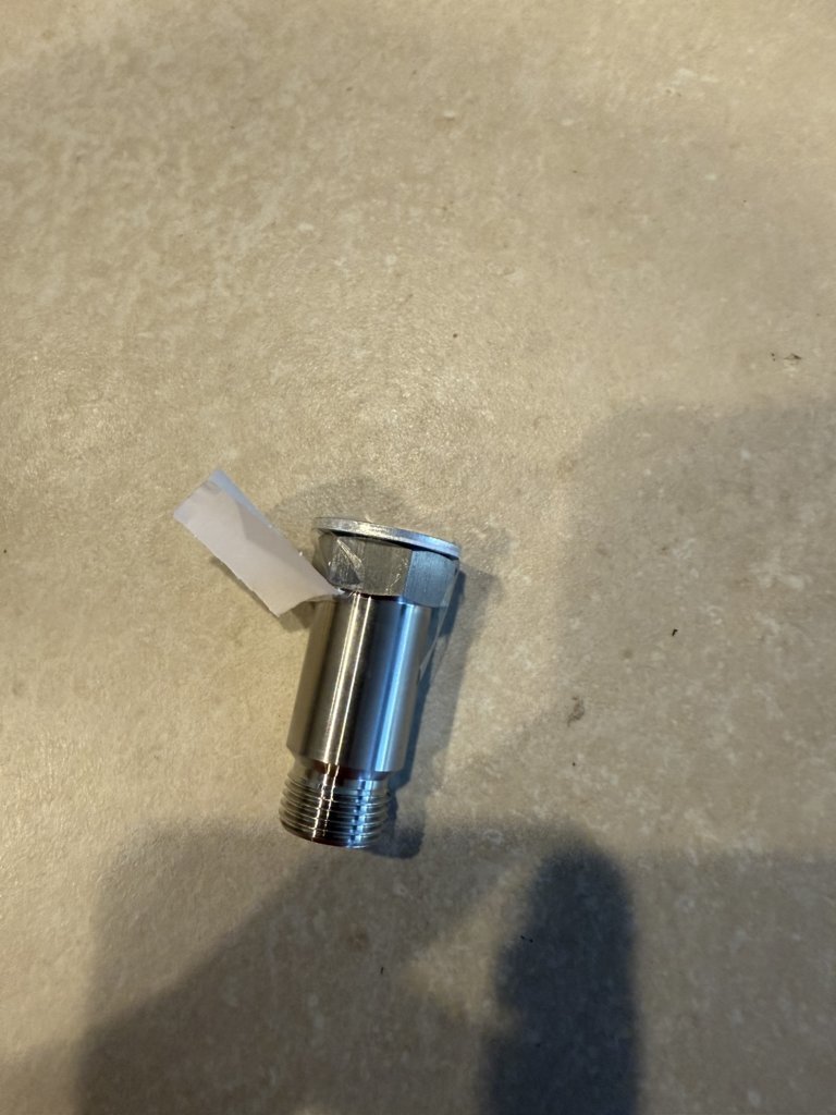

    Mmm...steak for dinner. I used the Vibrant ones before with good results for p0420's from LT headers.
