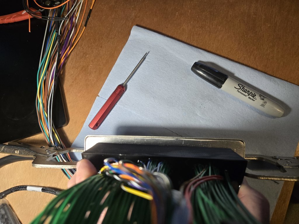

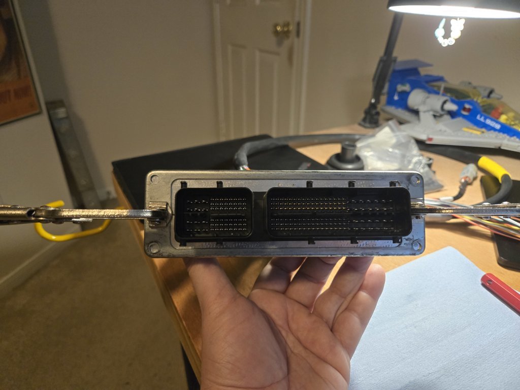

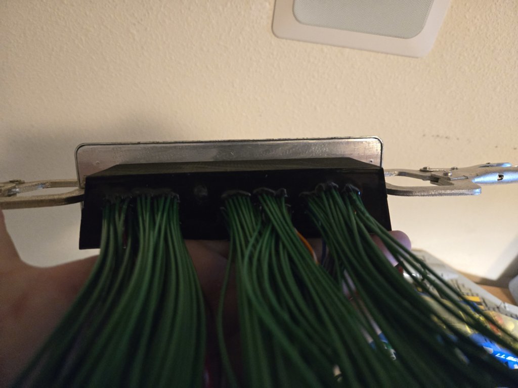

    I finished the sandwich plate for the Boomslang firewall mount, this was more difficult than I thought. I changed my mind on using the stock ECU mount as the Boomslang adapter is basically a trapezoid and would have required a lot more work to get it to fit. I am making another aluminum plate that will mount to the firewall in the stock ECU location with nutserts that this piece will mount to. I still have a hand full of signal ground and +5v reference wires to work into the loom, waiting on the wire shipment and some pins to show up before I can fit to the truck and then cut the wires to length and terminate.

    Looking good! How do the nutserts hold up? I have a few items I wanted to set into the fender but was thinking of vibration etc. But then again they are used throughout the auto industry...

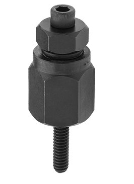

    I use this tool from McMaster with steel ones :D small impact with an open end wrench and I can chew through 100x in 45 minutes with minimal effort.

    I’ve got the second one and it’s great.
