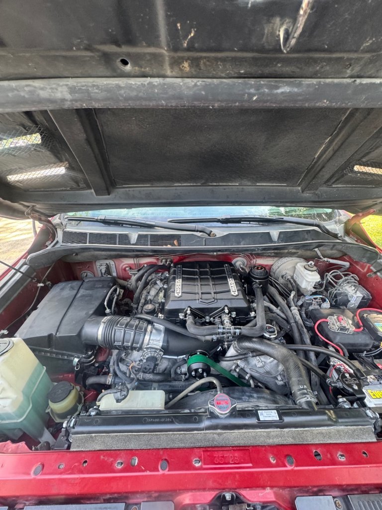

    Got everything back on this morning!
    Once again got to thank @Mcbelen (Maynard) at MCBAutotech. Dude is A+, he mainly did the uninstall and reinstall, I just helped lol.
    Drove around for a bit and she’s ready for the road again :burnrubber:

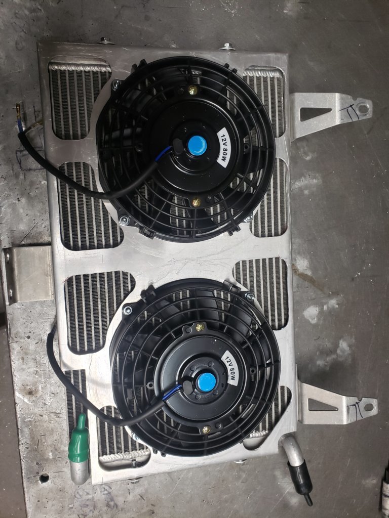

    Fan shroud is almost complete, off to the powder coating shop tonight.

    Looks pretty but there’s giant holes in the shroud?!

    without the holes it will block air flow at speed. The guy who fab'd this up for me has done this before and says it works. I was skeptical, but we will see.

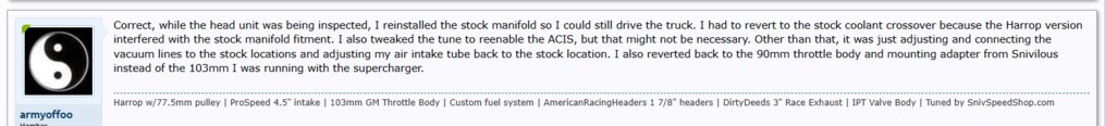

    Slap your stock intake back on and drive it NA, it's not that much work, keep the same intake, injectors and plugs as-is and you can use the same tune...

    I wouldn't block of the holes as it's your intercooler in front of your condenser and radiator. You want flow in slow stop/go traffic.
