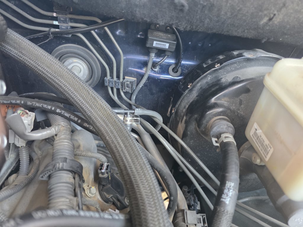

    Hows the Air Fuel gauge connected?
    I guess the better question would be where does it connect?

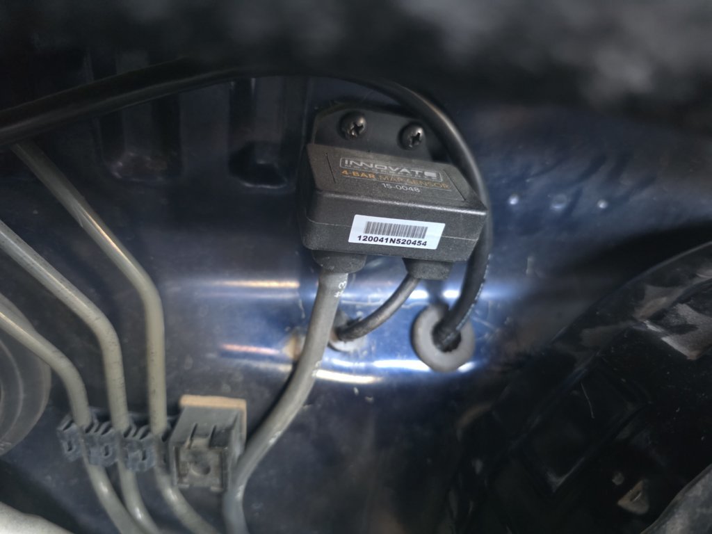

    There's a map sensor, which I mounted to the left of the brake booster. Then ran the wires into the cab.
    The vacuum line is "T'd" into the line to the fuel pressure regulator for boost reference.

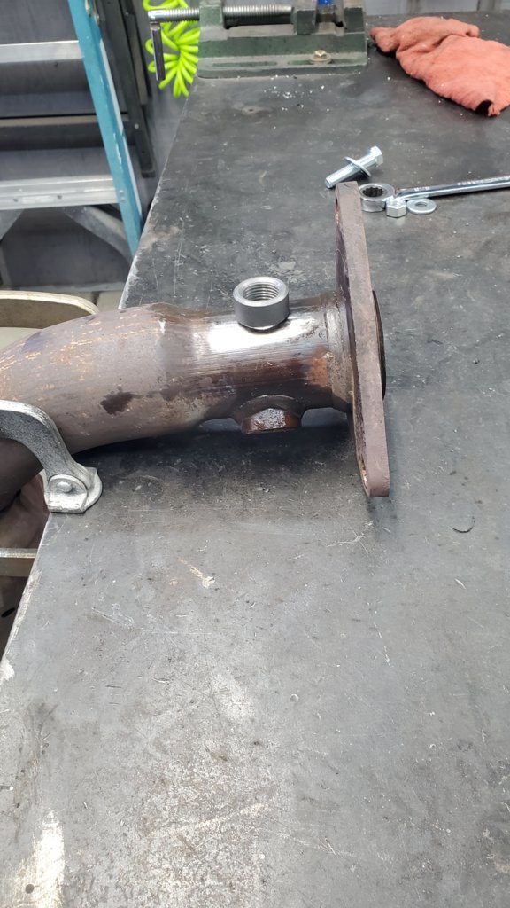

    Bosch 4.9 O2 sensor welded to the exhaust downpipe.

    So i'm going to have to weld a sensor port/mount to the downpipe?
    I do have that ability here in the garage.

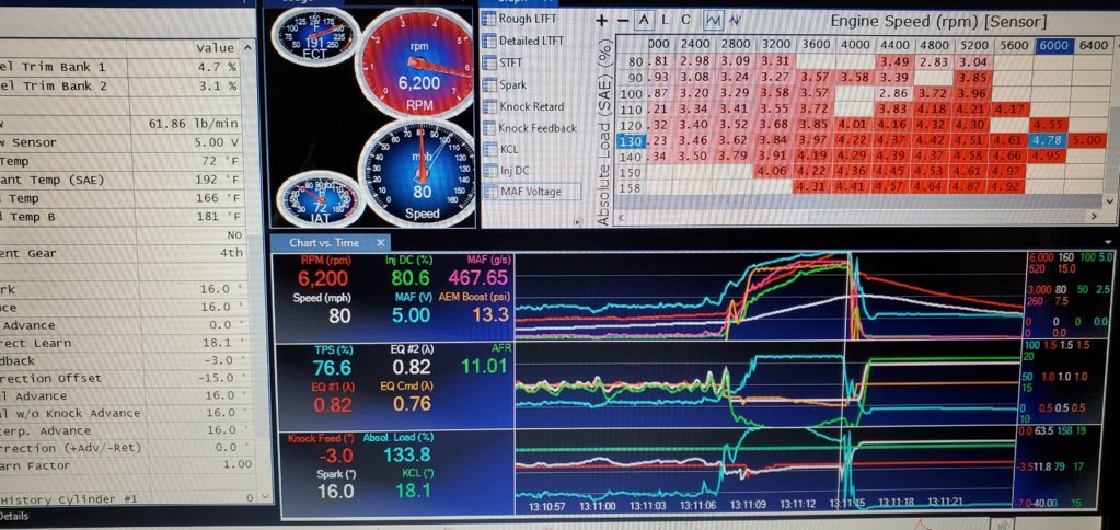

    Thanks @snivilous for pointing out my MAF and others were in absolute load instead of air load. Will do some log runs later to see if it changes the MAF..IDC/ KCL. etc before changing it up.

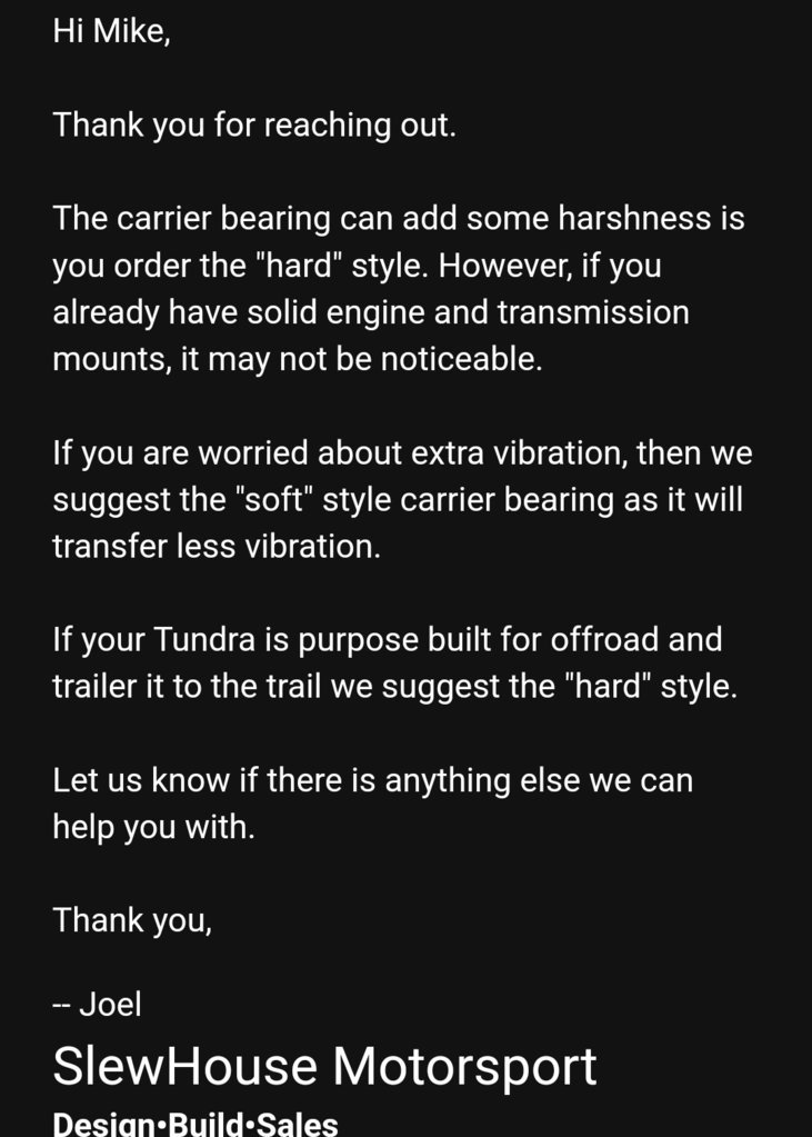

    Just an FYI for those looking at the Mitch Made billet carrier bearing at Slew House. Concerning solid or soft mounts combined with solid engine/trans mounts. I ordered the soft one and will get it on when it arrives. Thanks @reywcms for posting about it.

    @snivilous Thanks for pointing out on my logging was in absolute load instead of airload. Might have added timing where it's not needed.
    My MAF Max's out at 6400rpm but injector duty cycle was at 89%. All others are good and timing stays as it is.
