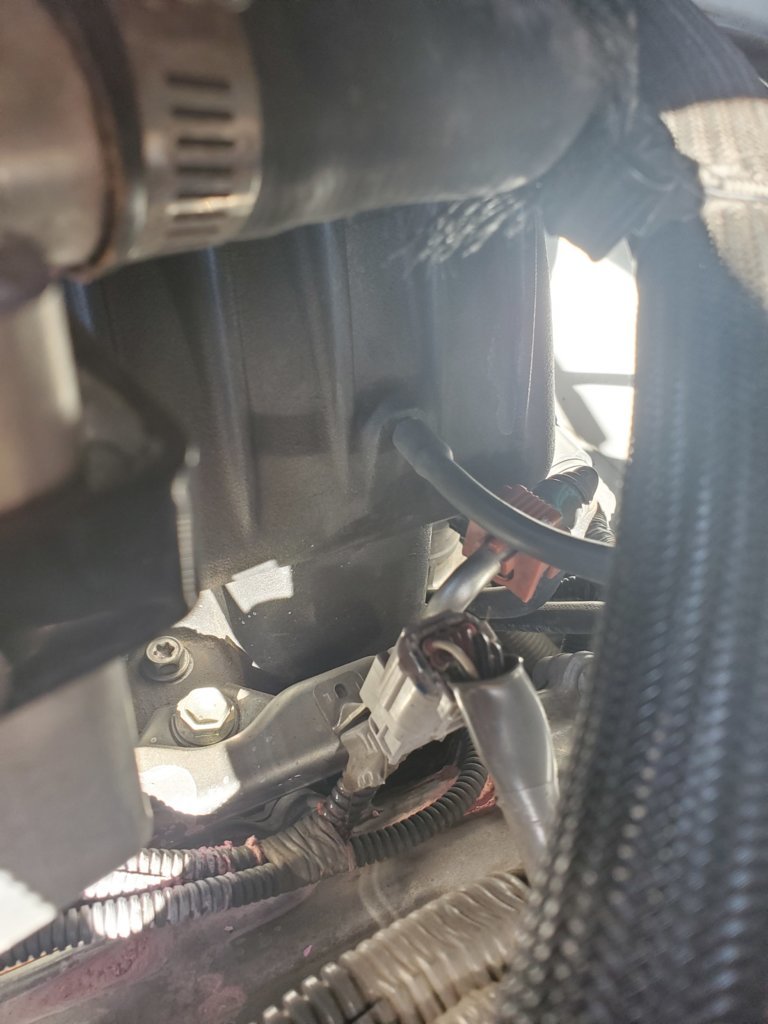

    I bet you’re not even getting in to boost because of the bypass valve. I need like 45-50% (40 degrees of throttle angle) throttle to get any boost at all. Try tow/haul mode and don’t be a ladyboy.

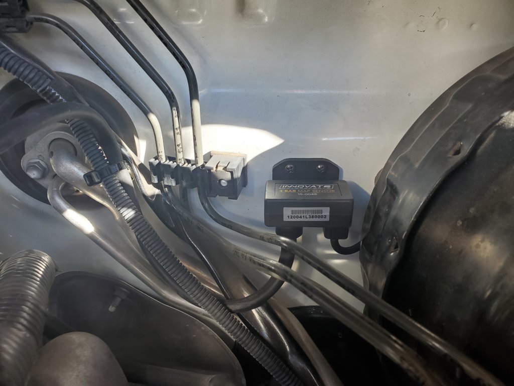

    Short hose run from the back corner of the blower to the map sensor. I mounted my map sensor to the left of the brake booster.

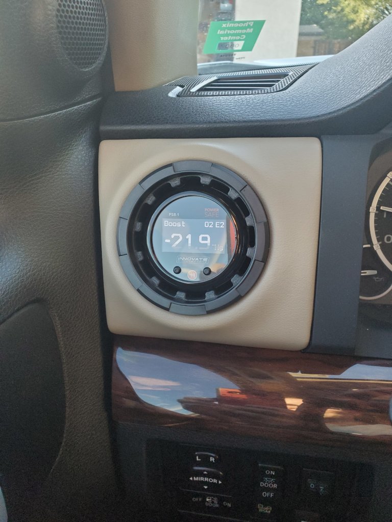

    So what are y'all using the second gauge mount for on the pillar mount?
    Obviously one is going to be for boost.
    Air Fuel mixture?

    Current : Magnuson S/C 5.7 FFV, Tundra CM, SNIV tuned w/HP Tuner, SG-1 Wide band AF w/gauge, TRD cat back, slotted and drilled rotors, stainless brake lines, TRD pads front and rear, front OEM Sport sway bar, rear TRD sway bar, 38 gallon OEM fuel tank, Tesla screen, ham radio, 2.5 Icons w/ res front and rear. X2 battery w/Voltage Booster Pro 2014 OEM wheels. https://drive.proton.me/urls/Y8739Z14BG#HCVT8AowG9fl ---------------------------------------------------- Previous: 2002 Tundra AC 2wd... Converted to OEM 4wd , S/C 4.7, TRD exhaust. 35's w/4:88's, too many other mods to list. https://drive.proton.me/urls/SWEWY4AFMC#eC7zX57Ex6pI ---------------------------------------------------- Other: 1967 mustang , Blown 408, 671Mike Kuhl 12.5% overdriven, 300shot NOs 5 speed TKO600, 4:11's Ford 9", Detroit Locker (real) Evans Coolant, Twin 12" Spahl fans https://drive.proton.me/urls/ABBVY3TQ3M#OT9LceyNwbTy ---------------------------------------------------- 2015 4runner TRD drop in filter Prinsu 1/2 roof rack, Nfab side steps, TRD FJ lift kit. ---------------------------------------------------- 2007 Prius 45mpg+ ... It's the only way to afford fuel for these Beasts!
    My second one is for air bag pressures

    I went with a single gauge. The Innovate PSB-1 will monitor both AFR and boost on one display.

    Boost and AFR.

    I have 2 multigauges, left is left bank AFR, Peak Boost & boost 2x because I didn't need to add another ethenol or fuel temp/pressure sensor. Right is right bank afr, ethanol content, fuel pressure & fuel temperature.
