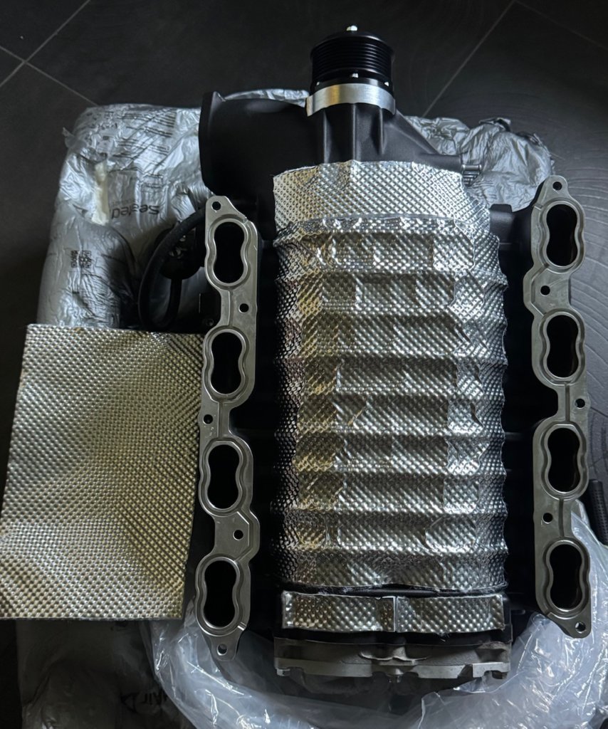

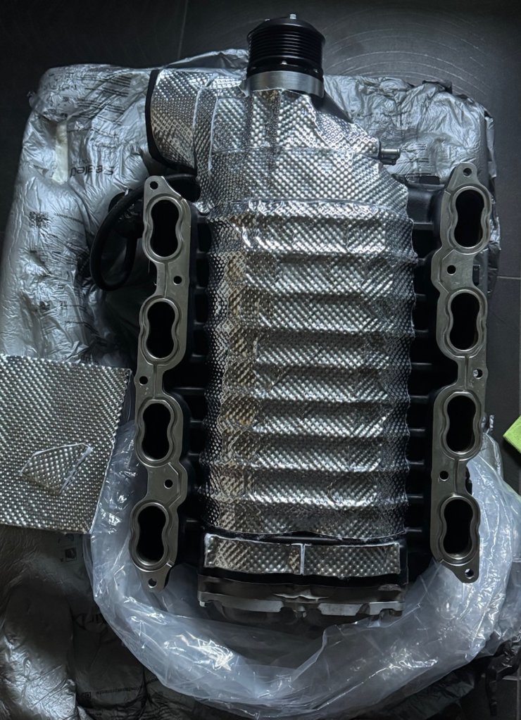

    Fiinterchillers thermal blanket is on the belly. Should I add a piece on the snout too or is this okay?

    I would and the inlet area

    I did it on the tvs 1900.

    Good your using the red stuff instead of premix. Supposed to have better cooling properties.

    thank yall!

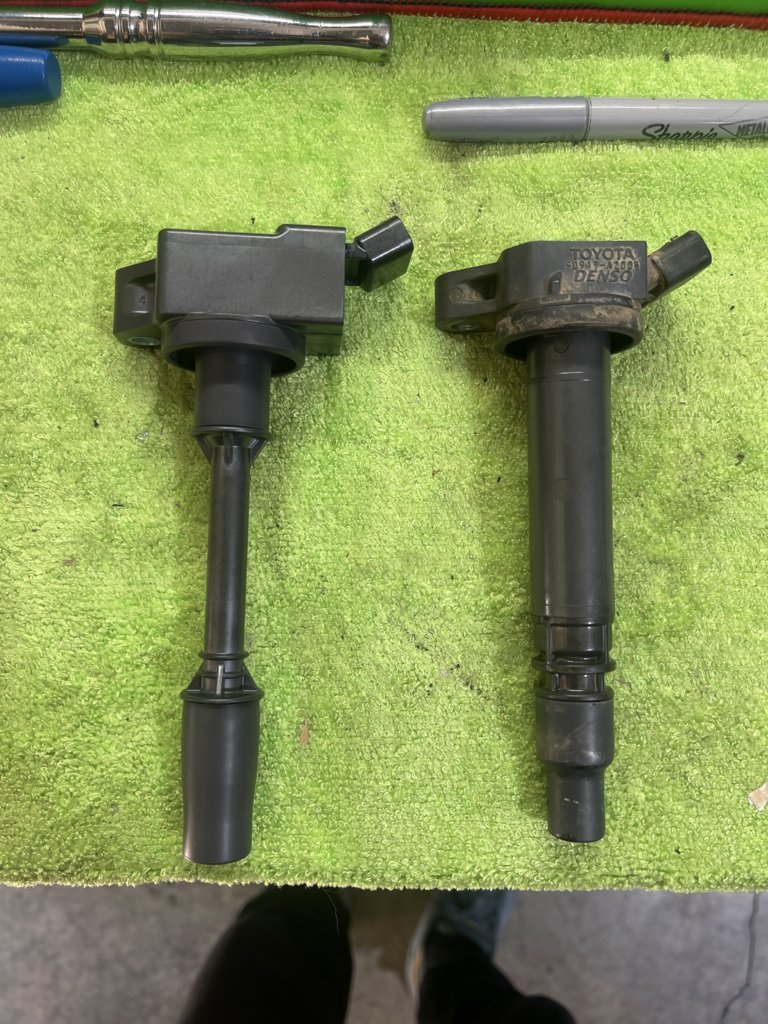

    Decided to put new plugs in even though I changed them last year which were gapped at .025 using Denso IkH24's. The new plugs I gapped to .033 to see how they respond to the increased power from the Lexus 8AR-FTS coils. Almost finished gotta put new red antifreeze in and check for leaks...
