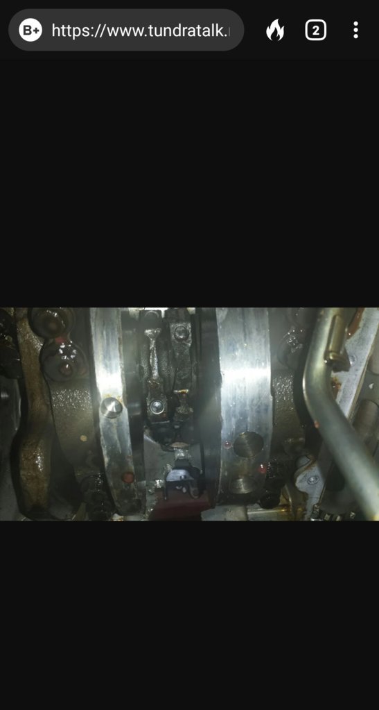

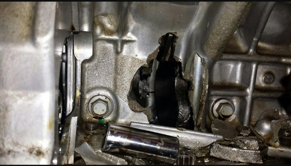

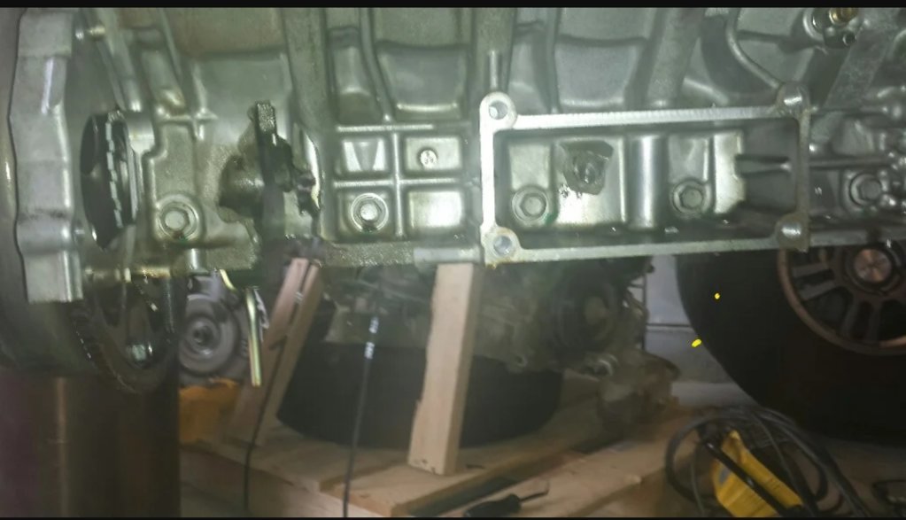

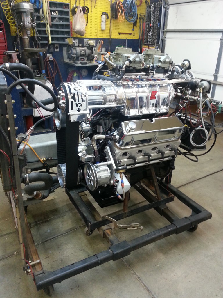

    Found these pics of my engine letting go at WOT. Sorry if it hits a nerve but can happen.
    Of course shitty tune from bullydog and lean.
    Rods letting go...think it was 3,5,7 and 8, 4. Burned through the head at 8.
    Think it hit 11.3 psi and ran out of fuel hit 12afr.
    I'm currently on 14psi and 10.5-11.2 afr.

    I feel bad for pistons 1, 2, and 6 - you didn't let them join the party? Or did they just ignore everything else exploding around them?

    They were just singing along unbebost to what the others were up to.

    Huh interesting about the going lean at 11ish psi. I have mine at 11.8-12.3afr at 11-12psi for 2+ years now.

    That’s lean even by my standards. I’ve run my turbo anywhere between 10-12 AFR and there’s a noticeable loss of power in the 10’s and 12’s but mid to low 11’s seems to be where it is really happy.

    BullyDog for the win, their shitty tune caused the failure in my Tacoma. I got off easier than you though, only ring land failure and scratched up cylinder wall that the machine shop was able to hone out.

    11.8-12.0 is pretty standard in boosted applications with proper ring gaps. The issues to me is not lean the issue is excessive heat and breaking the ring lands hence why we run on the richer side to combat the heat swelling to preserve the rings/ring lands. Long pulls compound the issue obviously.

    I'm not sure why but a week after mine went ViktorG's engine blew. He was on BD back then. Bad tunes with excessive heat and most likely running out if fuel.

    100% this, I think long pulls (or repeated) is the biggest issue. As I recall @Abell207 isn't towing or doing long pulls so when he wanted to put the truck more into kill mode I was fine with that. On my personal truck I wouldn't want to do that, even without towing, there's lots of long grades where I live---hell yesterday the truck was seeing boost for minutes on end in 100+ degree heat climbing the 4000ft to get home from dinner. I wouldn't want it to be in the high 11s doing that.
    With that said, I try to target right at 11.0 these days. My truck has been setup like that for a long time now and it seems fine even towing up the grade so am confident other people's trucks will be fine.
    I think your use case dictates what AFR is safe, towing or bashing through sand at WOT is a lot different than racing for one or two stop lights at a time. A drag racer has different priorities than an endurance racer, same thing essentially here.

    100%- also dependent on use case. 11.0 is for sure a great median for safety and power. As we know anything below like 10.5-10.0 is like driving through a brick wall it felt like lol.
