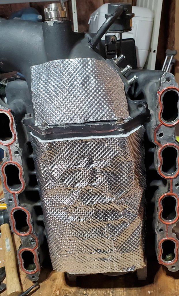

    Making progress. Bearings were toast and coupler had slop compared to new.
    Screenshot_20250618_131629.jpg 20250618_113127.jpg Screenshot_20250618_131656.jpg
