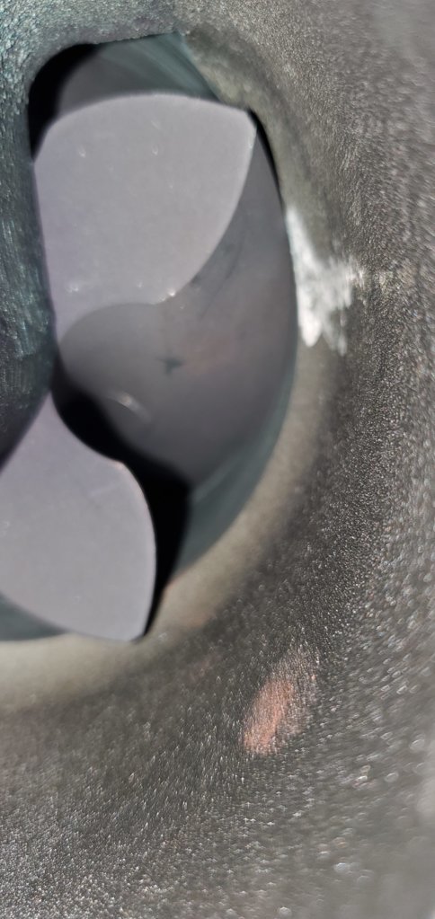

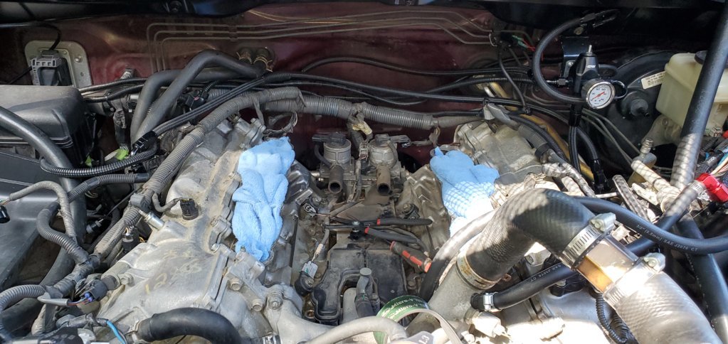

    Not too bad for ingesting crap during a engine grenade at 6k rpm(2015) and a year of spraying W/M 30/70 mix. Most likely the coupler but will swap out bearings in the snout. Going to pull the switching valves and just leave the tops back there. I have it bypassed but still needs voltage as I don't have the Hewitt kit. Now I gotta bring the GSD to the vet. Always something!
