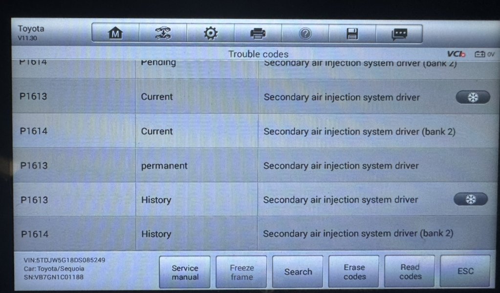

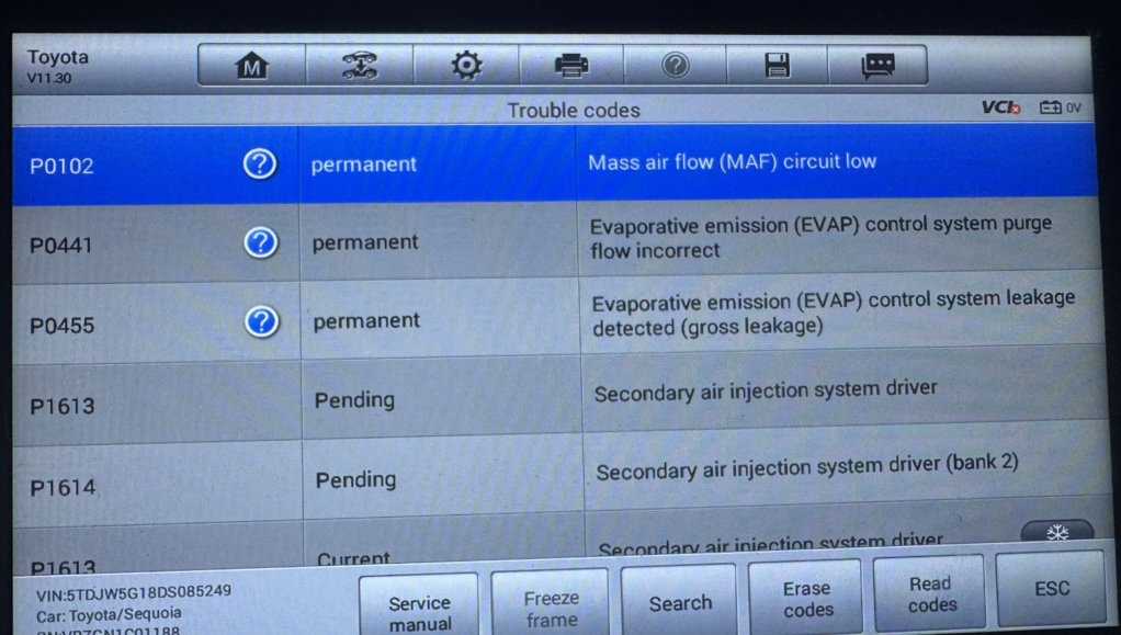

    Sequoia was towed to Firestone last night, I had anxiety with the mobile deal. Now I get to worry all day that there are other issues, I have a slew of weird codes I never had before, hoping from coolant in the intake/not starting on last crank.
    Evap has been there for years, the MAF failed and was replaced (I sent the failed MAF to TurboKits for diagnosis) I have never seen the air crap & the entire system is from the 70k donor motor/I had never had any of those codes before.

    Those air pumps are high current, 50Amp if memory serves, maybe the fuse blew while cranking? Would be a crazy coincidence for them to go at the same time as the starter...although they are known to fail regularly.

    I’m hoping there is no engine damage and the starter is as far as it goes.
    I’ll deal with the rest, hopefully once it runs properly they’ll clear. If not I’ll check the fuses but I did check every fuse hoping one of them was the starter issue.

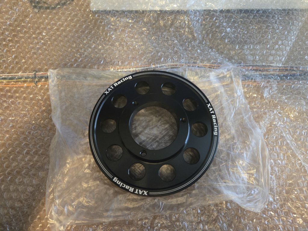

    That devil is back on my shoulder, telling me to do bad things...think it would be safe-ish with the 85mm SC pulley and the 7" crank pulley? I know the 77.5mm SC pulley and this would probably seal the deal on the stock drivetrain...
    XAT couldn't give me boost numbers as they vary per application, but they said that the 7" crank overdrives by 20%

    If my math is right, running this with the 85mm SC pulley would be the equivalent of a stock crank pulley and somewhere between the 65mm and 70mm SC pulley...

    Is the XAT balanced to their crank pulley? I'm sure it is. PROSpeed's 7 inch too, $399? ASP will take my good (somewhat new) crank pulley and machine a balanced billet 7 inch for $350.
    That will give me a 4.25% increase over the 6.71 I have. Still gotta see what boost psi that will put me at. Currently 13.5-14psi.

    It's made specifically for their XAT/ATI damper, bolts up to the hub that the damper uses.

    They just called, said the connector also fried, 90980-11400, local dealer has it for 8 bucks, they are charging 50 installed. Starter bench tests dead.
