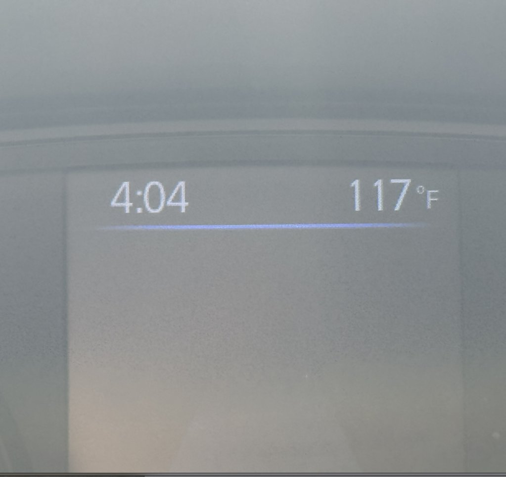

    Starter came early, went to the dealer & picked it up, came home to the O rings delivered, where does the Vitron Fluroelastomer 0-Ring cord go? Nothing like that came out. Wherever it goes I assume I cut it to size?
    On the way to get the starter:
    404 comfort not found.
    Does this look good?

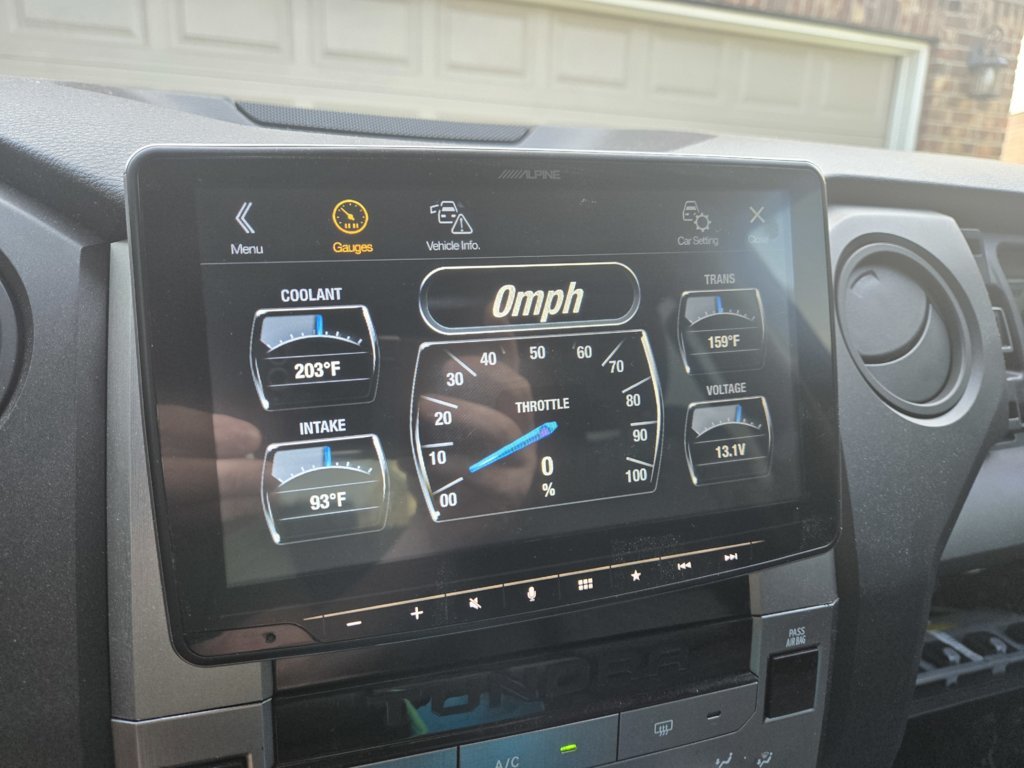

    Interchiller update:
    Things to Note:
    This is with cabin AC still in the loop, I haven't wired up the solenoid to block cabin EVAP and dedicate the AC system to the Interchiller.
    This is after dropping my daughter off at summer camp, so a casual drive there, ~15 minutes idling, and a fun drive back home at a faster pace.
    I still have a hot air intake, as the intake tube and filter are open to engine bay heat and not closed off
    IAT sensor is post supercharger intercooler bricks
    Ambient temp is 80* F
    Normally, with the heat exchanger, this would be at least +25* F over ambient temp
    At startup, I see the IAT 6-8* BELOW the ambient temp
