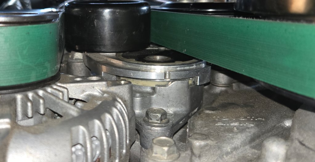

  3. Jun 11, 2025 at 4:18 PM
    e30cabrio
    Oct 20, 2017
    #10410
    6,253
    West Valley, Phoenix, Az.
    Boosted 2013 Sequoia TRD FAUX
    The new ones are coming from Jon B tomorrow, the old ones were in there super tight, I had to use a pick to get them out & it looks like there was something in there I cleaned out. I assume the new ones will be tough to get in properly.
    That bolt fits properly, I'm wondering why one wasn't there to begin with. I'm assuming that is why it leaked.
    Thanks
    Wynnded likes this.

  6. Jun 11, 2025 at 4:34 PM
    Silver17
    Oct 3, 2021
    #68847
    3,652
    Eastern PA
    2017 TRD 4x4 Harrop SC
    Looks like there should be a bolt there. Also, for the O-rings I’d maybe just use a dab of non petroleum based grease to keep them in place on assembly.

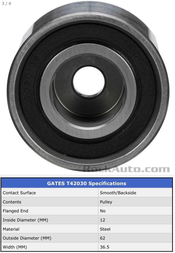

  16. Jun 11, 2025 at 6:23 PM
    armyoffoo
    armyoffoo Member
    Jun 4, 2018
    #15876
    1,395
    Cypress, TX
    2018 Black TRD Sport CrewMax
    Supercharged with all the trimmings
    I installed the Harrop tensioner I bought from ViktorG, belt still slips, but not as bad. @Jowett , do you happen to know of a larger idler pulley that will work with our engine?
    ARES35, Mdl and HulkSmurf14 like this.
  17. Jun 11, 2025 at 6:27 PM
    snivilous
    snivilous [OP] snivspeedshop.com
    Apr 16, 2019
    #29192
    4,840
    SW UT
    300k+ Supercharged 2008
    Pull the idler and go to a parts store and they should be able to find matches. They all use common size bearings, so it's really a matter of making sure the pulley offset is correct. On my LSA I was able to find a handful of pulleys and even trimmed the backside on some to clear, and then I could adjust two idlers to get the tension dialed in. Likewise good chance on the tensioner you can swap that pulley out.
    Abell207, ARES35, Silver17 and 2 others like this.

  19. Jun 11, 2025 at 6:28 PM
    armyoffoo
    armyoffoo Member
    Jun 4, 2018
    #15876
    1,395
    Cypress, TX
    Good idea, when my wife gets back in town I'll be able to use her ride and see what I can find. Thanks!
  20. Jun 11, 2025 at 6:45 PM
    Silver17
    Oct 3, 2021
    #68847
    3,652
    Eastern PA
    I hope ya find something that works! If only they made a size belt in between those two. I was just trying to research for you in that regard. Seems to be a more difficult hurdle than I’d have guessed using the 1” AES spacers and matching a belt. If only they made a 1/2” option.

  22. Jun 11, 2025 at 7:01 PM
    armyoffoo
    armyoffoo Member
    Jun 4, 2018
    #15876
    1,395
    Cypress, TX
    Yeah, I didn't think it would be this difficult to find a belt that works, but there may be a solution with the larger idler or tensioner pulley.
    HulkSmurf14 likes this.

  25. Jun 11, 2025 at 7:04 PM
    armyoffoo
    armyoffoo Member
    Jun 4, 2018
    #15876
    1,395
    Cypress, TX
    Believe me, I've been considering the upper and lower options, but I think that would accelerate my engine build

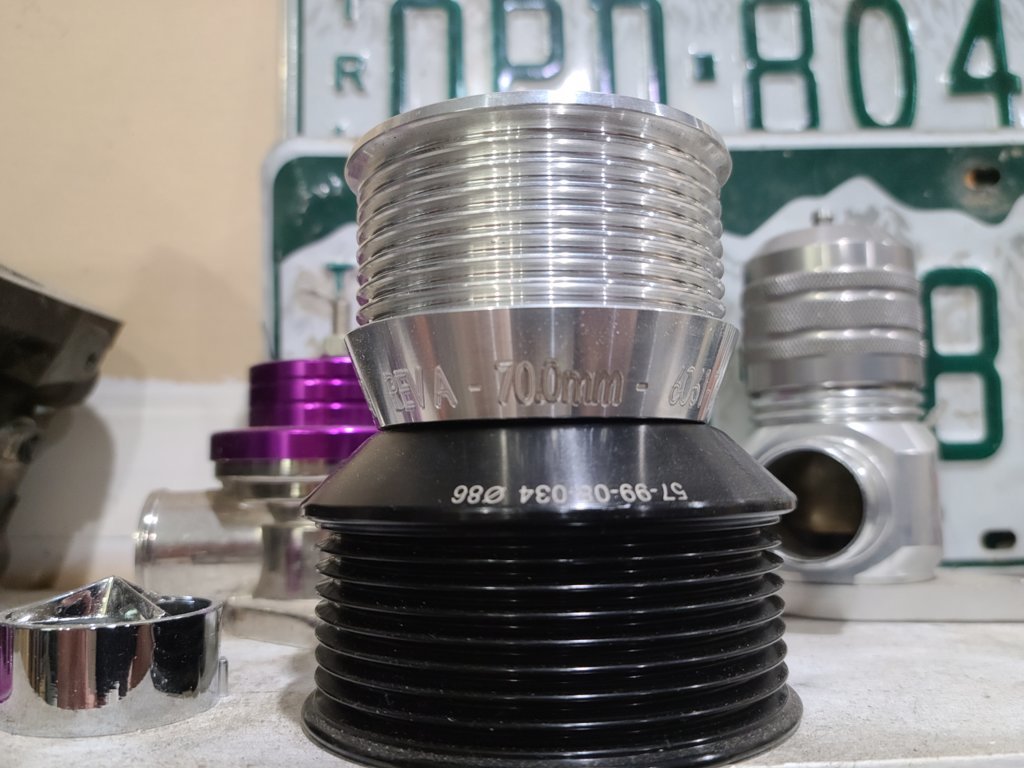

  29. Jun 12, 2025 at 8:38 AM
    ARES35
    ARES35 New member for life
    Aug 8, 2018
    #17920
    1,020
    Mile high
    Blown 2650 17 1794 Tundra 4x4 CM
    2650/750cc/76mm/SPD DP-DD exhaust/HP tuned
    Really been eyeballing the 70mm lately...thought someone was running it on their 2650 but can't seem to remember whom.
    Land Bruiser, Ryuu, Mdl and 2 others like this.
  30. Jun 12, 2025 at 9:00 AM
    Mdl
    Mdl Hey there...
    Jun 14, 2023
    #98638
    3,207
    PNW, WA
    2007 TRD SC'd
    JBA Longtubes, Snivs 2.0 SC pulley, ASP crank overdrive pulley 6.71 in, DD Full 3inch dual exhaust, IPT valve body, Airbox mod, 4.5inch intake, Denso 750, 450 Walbro, W/M injection, GM 95mm TB, SABM, Camburg UCA, Icon shocks, Speedmaster LSD, Motive 5.29 Gears, Mickey Thompson Baja Legend EXP 35's, Solid Offroad engine and transmission mounts, DIY Traction Bars, Tuning by Snivspeedshop.com
    That is odd to have oil in there. You can try flushing it out with hot distilled water?
    Over time the leading edges of the rotors can wear. Also as they don't make contact, in time with each other its good. Could your air filter let in fine particle sand? Any evidence in your filter? Just thinking but is not a big issue as it happens especially in dusty environments. Sometimes the good old Wix paper or stock paper stops dust better than after market ones.
