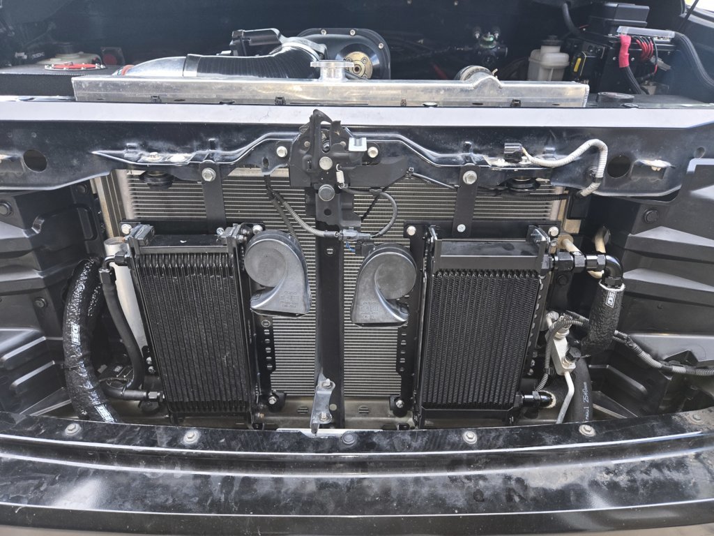

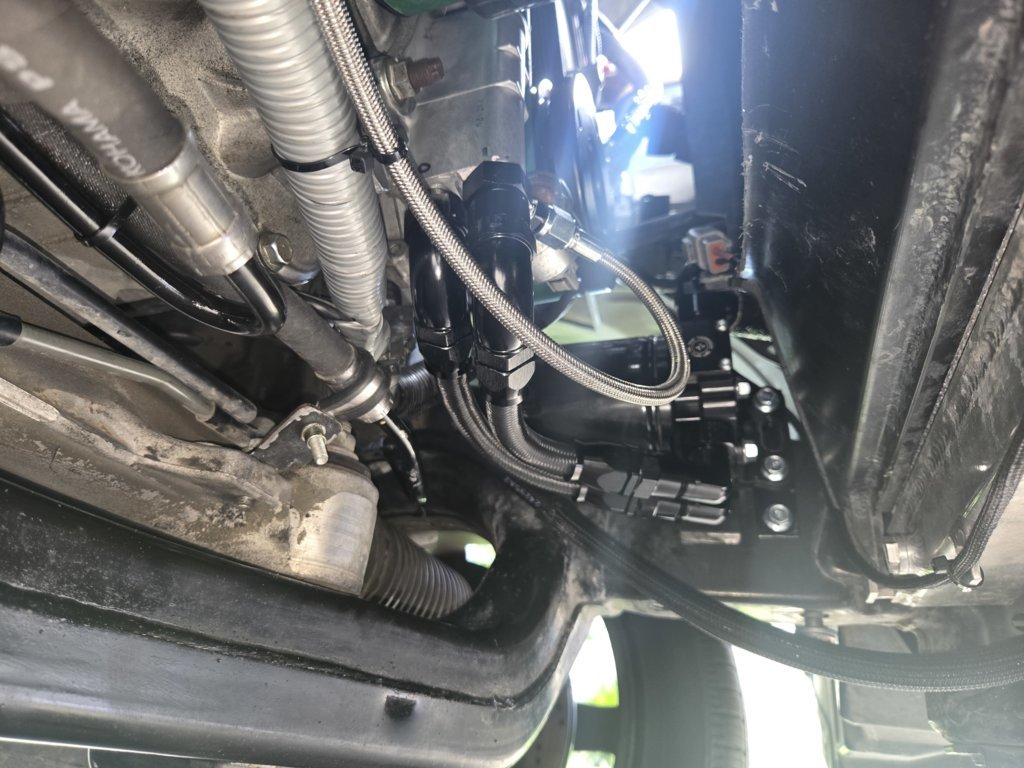

    Finished up my hoses and filled with 9qts oil, details are below:
    Modified GX460 1UR 4.6 V8 oil filter bracket
    Vibrant 10AN PTFE hose - 41.5" - ~7oz capacity
    Earls 419 Oil Cooler - 0.4qt capacity
    Improved Racing Thermostatic Oil Filter Housing (160* open)
    Wix 51085 filter
    Haltech pressure sensor with remote mount line
    engine oil adapter (Vibrant 10AN hose end 90* with 8AN ORB end) out to oil filter housing (Fragola Swivel 10AN 90*) - 7.5"
    oil filter housing (Vibrant 10AN hose end 90*) out to oil cooler bottom port (Vibrant 10AN hose end 45*) - 10.5"
    oil cooler top port (10AN Male to Female Sensor adapter, Vibrant 10AN hose end90*) back to oil filter housing (Vibrant 10AN hose end 45*) - 17.5"
    oil filter housing (Fragola Swivel 10AN 90*) to engine oil adapter (Vibrant 10AN hose end90*, 10AN to 8AN ORB Sensor adapter, Vibrant 10AN hose end 90*) - 6"
    **Extended horn wiring for mounting to cooler bracket, and cut out some bits from the side of my fan shroud to make room for hoses coming through from the oil cooler

    Bravo! Thanks for notating the lengths of hose!

    Clean install!

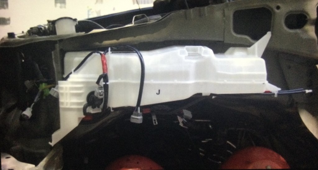

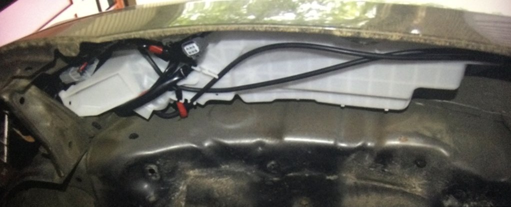

    Those fender pics reminded me….. For those with large supercharger coolant reservoirs, dual batteries, etc, that might need a normal sized windshield washer reservoir, the Land Cruiser 200 rezi will fit behind the fender on the Tundra. Here are the old mock up photos, some small brackets to pick up the mounting points will hold it in place.

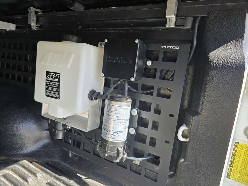

    What's the capacity on that? Might be a good option for a water/meth container...

    Water/methanol storage...

    It’s roughly 1 gallon.

    It also has multiple pump mounting locations and a fluid level sensor.

    Toyota says 4.8 liters or 1.26 gallons. A custom tank for that spot could easily hit 2 gal.

    Is that the passenger or driver side? I’m assuming you have to take the outer fender off to mount it in there?

    I was thinking the same thing. I don't know if that tank is below the intake level, but at least it's lower than the truck bed.

    Drivers side mount. Think it's called the headlamp cleaner jar. Part 85315-60350

    Yes, it mounts drivers side. The 85315-60350 is the bare tank, comes with little else for $117 retail. The 85355-60180 is $129 retail and comes with the level sensor, two washer pumps (front and rear), and the wire harness. It’s a MUCH better value, those washer pumps and sensor are relatively expensive when purchased individually. The filler neck is also required 85301-60060.
    @centex My recollection is that it pushes up into place w/o removing the fender. I pulled the fender to inspect for actual area available and have easy access to the mounting points.
