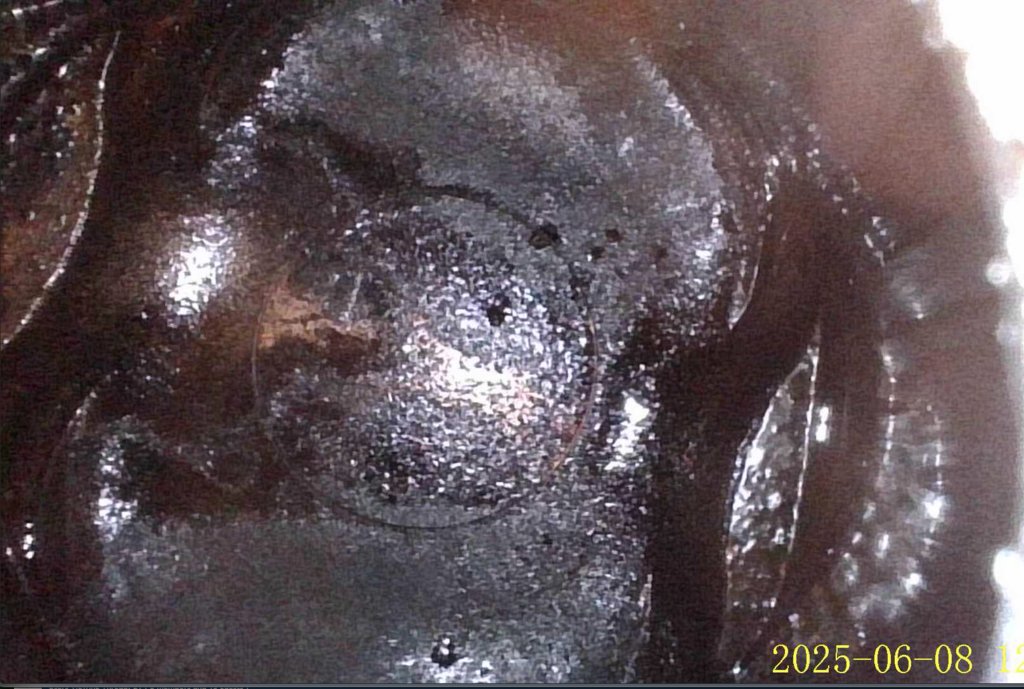

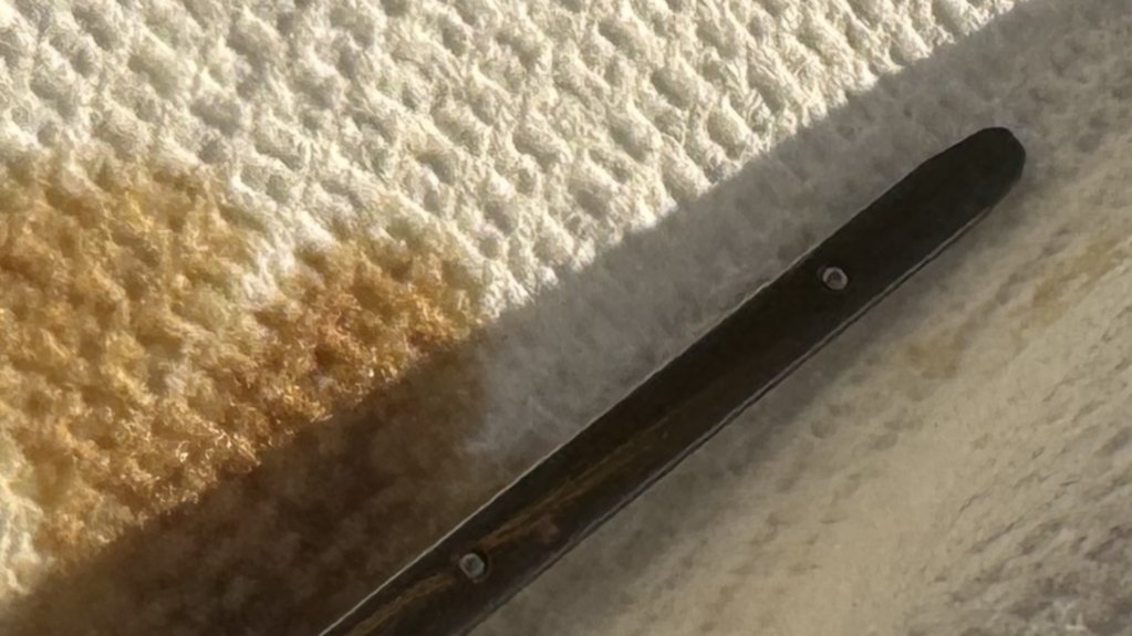

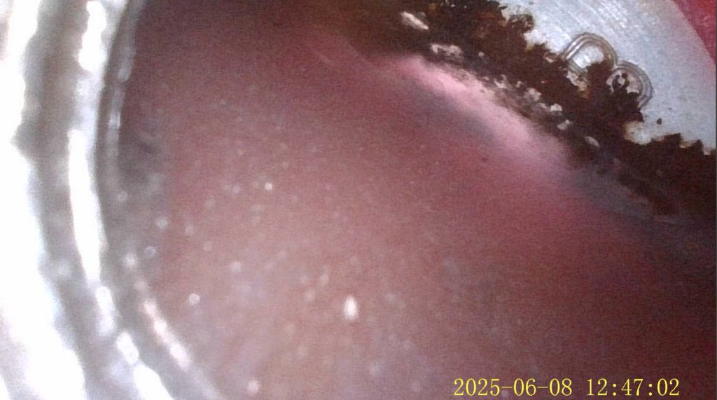

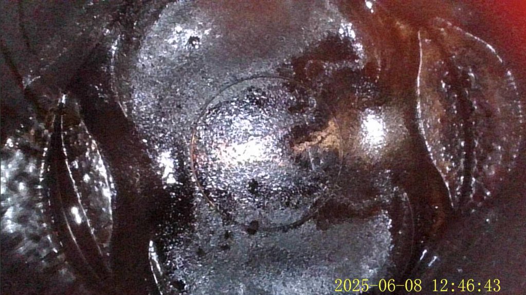

    So that's an affirmative, there was 1/4 of a gallon in 8,7,5 & 3 combined. The starter no longer does anything (I suction pumped 99.9% of the fluid out) Is there a fuse or relay for the starter? Can't find one.
    I'll have to pull the skidplate to try & manually crank the motor to see if it is fucked.
    7, still working on getting that out.

    Holy shit! Remember to pull the plugs when trying to turn it over to maybe help purge the coolant out. May as well do them all I would guess. I'm unlikely to be of any use in troubleshooting the starter...

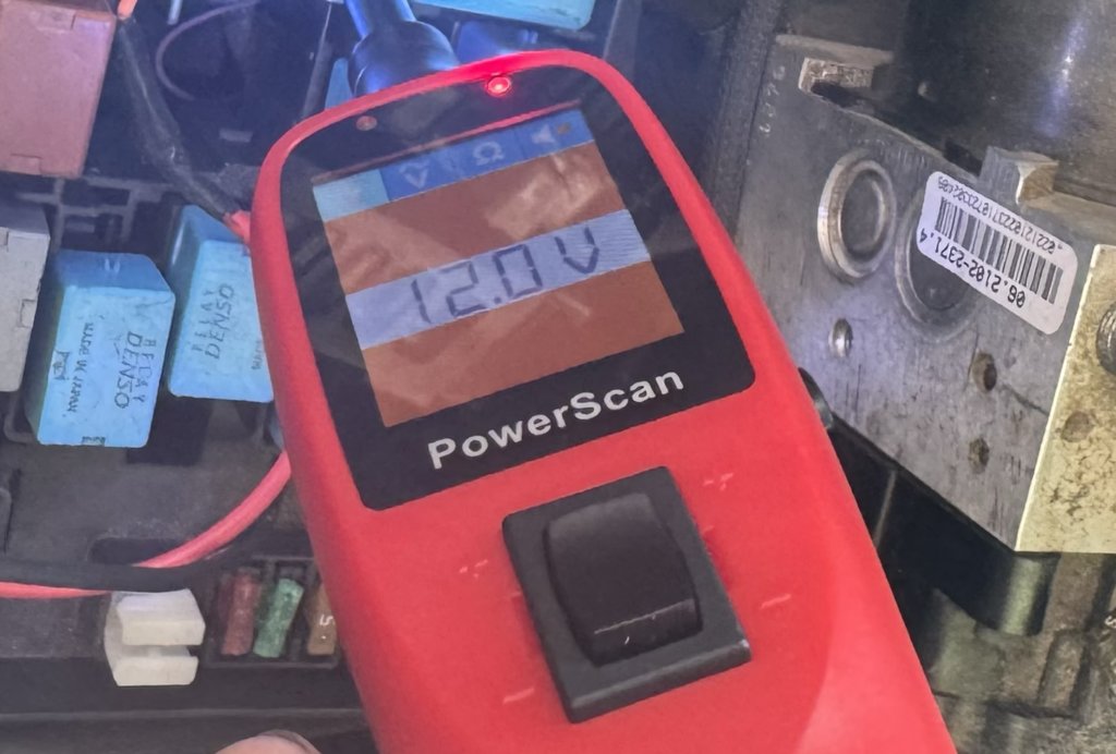

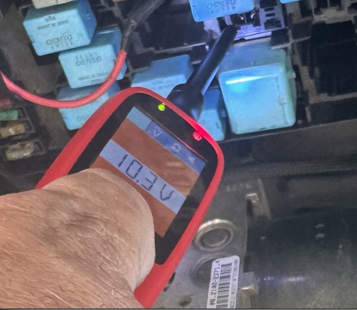

    The battery is behaving oddly, it is a year old quality AGM, it gets 13.9-14.3 volts when running, lives at 12.5+. Right now it has 12.3, ignition off. Ignition on, DRLs on & the SC Pump running it's at 12.
    No starter & no starter when bypassing the relay with a test probe. The odd thing is the voltage drop when trying to start it.

  14. Jun 8, 2025 at 3:36 PM
    centex
    centex New Member
    Nov 27, 2022
    #87464
    2,186
    Solenoid on the starter die?

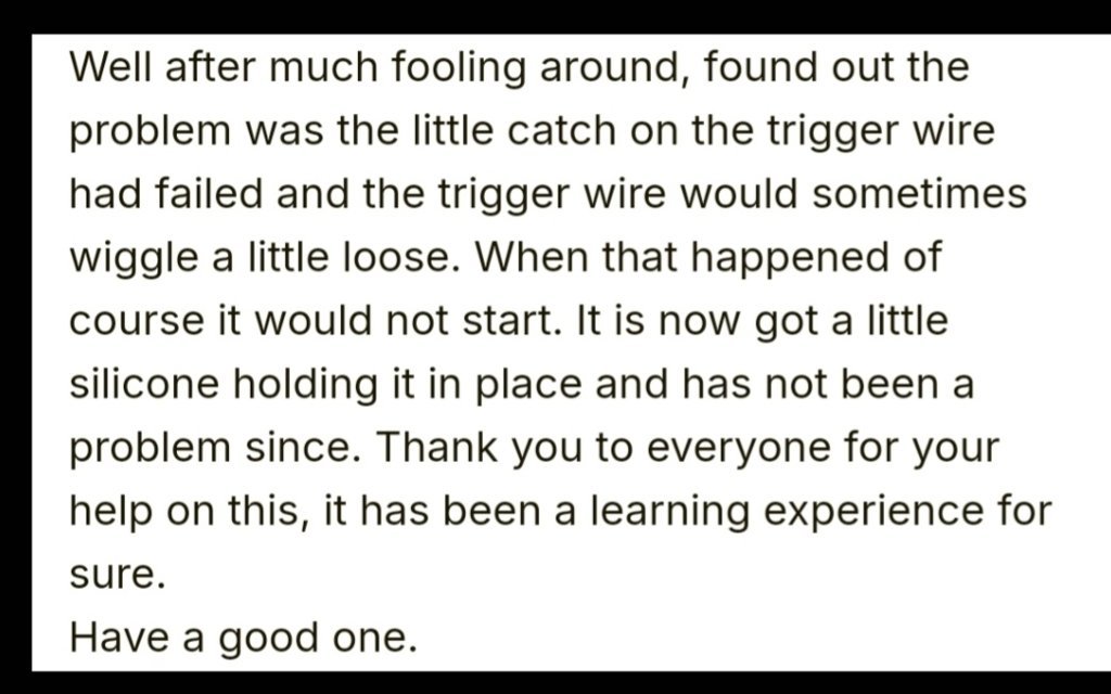

    Not sure if you tried yet. If the trigger wire is not engaged it will go through a start cycle but no crank. It was a difficult find out but cured my no start.
    Found this on tundrasolutions a few months ago that helped. Not sure if it's your issue.

    Thanks. Where is the trigger wire?

    Forward on starter about 11 o'clock. It's has a little tab that sometimes unseats. If you can loosen the heat shield you can jam your hand in there and see if its seated.
    I'm hoping it is something simple and not a serious issue!
