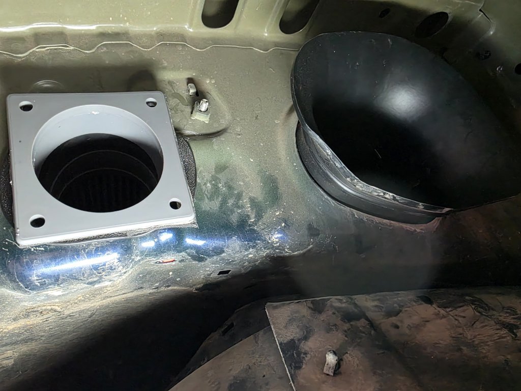

    That's what I have in the bumper, this is under the lid on the SC body.

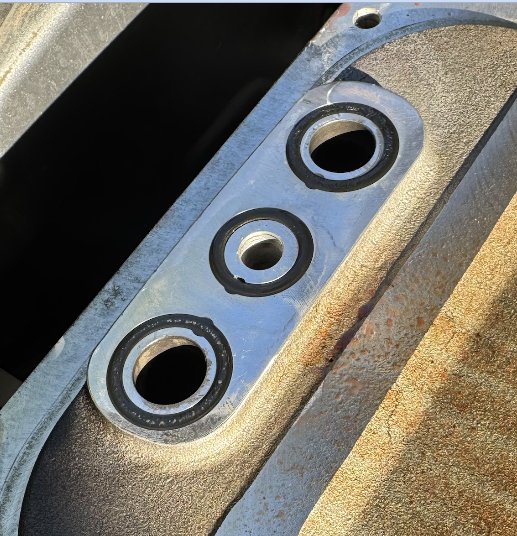

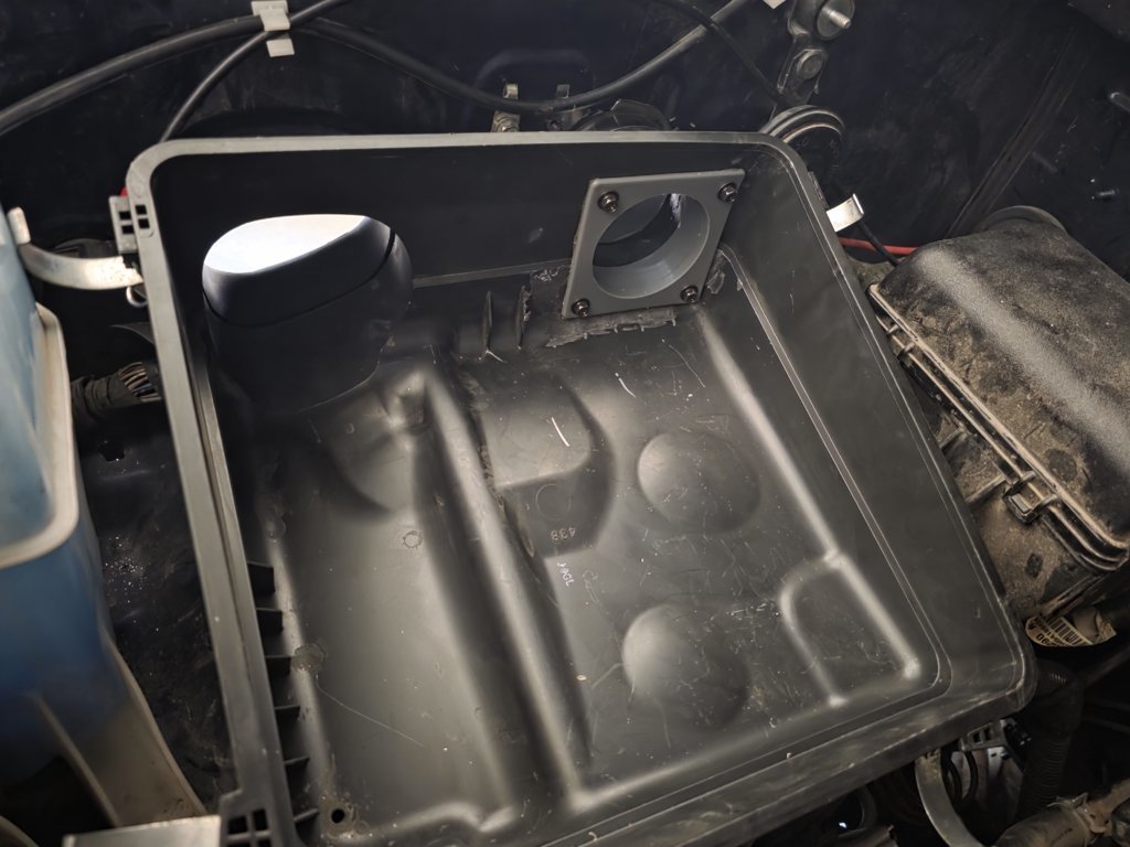

    Here's what I have, it seems like it is the seal between the intercooler and body. Can I use RTV until the new seal comes?
  8. Jun 8, 2025 at 7:37 AM
    HulkSmurf14
    Aug 9, 2019
    #34377
    2,796
    2014 Tundra Limited
    Tastefully enhanced...

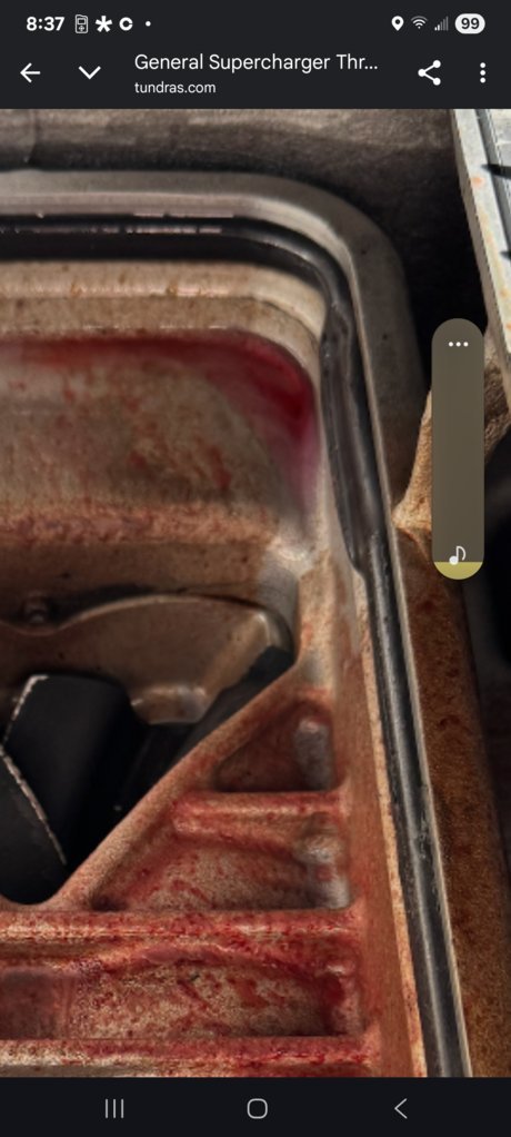

    Whats this recessed area?
    armyoffoo and ARES35 like this.

    I wouldn't see why a small bead of permatex wouldn't work but it's going to be a bitch to remove all small peices once it sets.

    BLOODBATH! J/K...you could use RTV, but I'd be concerned with using too much, and having issues with excess possibly coming off and going through the engine, and you'd likely have difficulty removing the IC in the future if needed. Can't you just drive the BMW until you receive the seal and o rings?

    The recess must be an installation flaw, no idea, I'm going to give it a light dusting of Right Stuff where the depression & leak appears to be & if my Amazon zillion O ring kit has these sizes will put them in. I paid more for shipping to get the seals from JonB than the seals (26/32) so will have them soon.

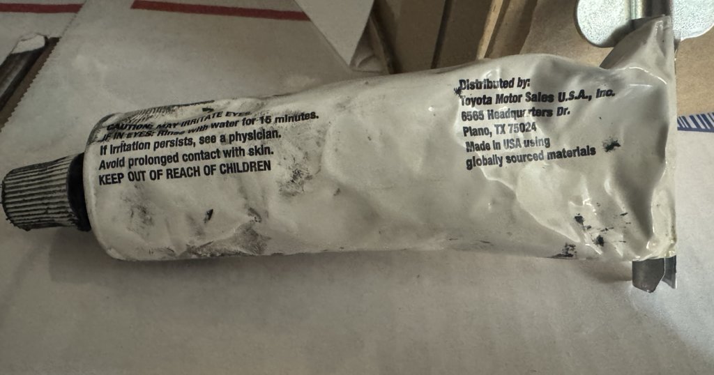

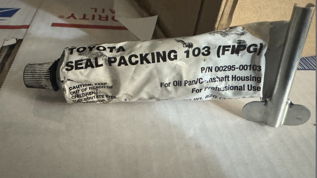

    Could not find the Right Stuff, used Toyota FIPG. Says where it came from but not curing time.
    HulkSmurf14 likes this.
  20. Jun 8, 2025 at 8:34 AM
    armyoffoo
    armyoffoo Member
    Jun 4, 2018
    #15876
    1,474
    Cypress, TX
    2018 Black TRD Sport CrewMax
    Supercharged with all the trimmings
    1-2 hours before starting engine, fully cured in 15-16 hours, good choice going with that!

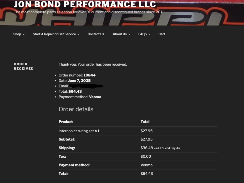

    Definitely going to be chilly again.
    armyoffoo, mustang67408 and Wynnded like this.

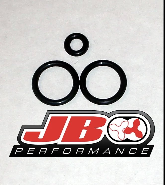

    I replaced them with Amazon knock offs & will replace all of it with the JonB parts when they come, hopefully Wednesday, didn't realize it did not include that big seal.
    Is it me or is the picture just a representation? the smaller O-Ring looks too small.
    HulkSmurf14 and armyoffoo like this.
