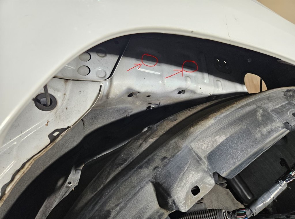

    Maybe, making some holes in the inner fender will allow air to flow to the vent. I will take some measurements to see if that is possible.

    It's definitely possible, I've got a large hole in my passenger side now, I would just need another on the driver's side

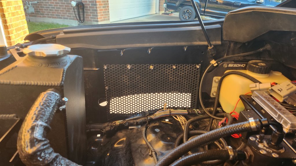

    Did that tank ever get under pressure or? It's a decent design.

    That's the ProSpeed tank, it looks great and fits the spot perfectly, but I had issues with it from day one, so I bought the CXRacing 2.4 gallon tank to replace it. The PS tank has no pressure relief valve either built into the cap or otherwise, and the outlet at the bottom was below the inlet on my heat exchanger so I had issues filling the system. The cap is also left-hand thread and the threads were boogered up, I had to use a file to fix them so the cap would seat fully.

    This is the CXRacing tank I'm using now, the other pic was the best one I had for the fender hole, it's outdated

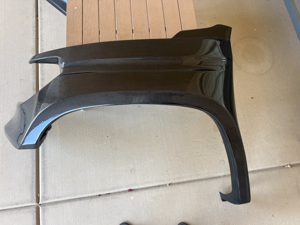

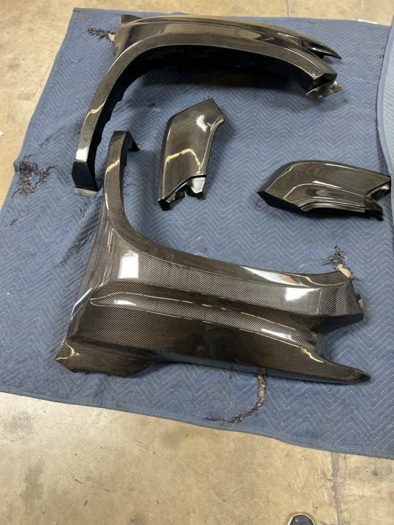

    should pair well with these

    those the fiberwerx fenders? thought they made the piece under the headlight separate?

    New width we did is now one piece. 6” width over the the 4.5”. But yes our old ones shown here in the two piece

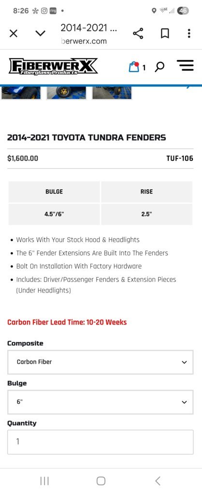

    This sold as a kit?

    nice. looking at their site right now and see the new option. *bookmarked*

    Yes fiberwerx

    God damn 10 to 20 weeks!

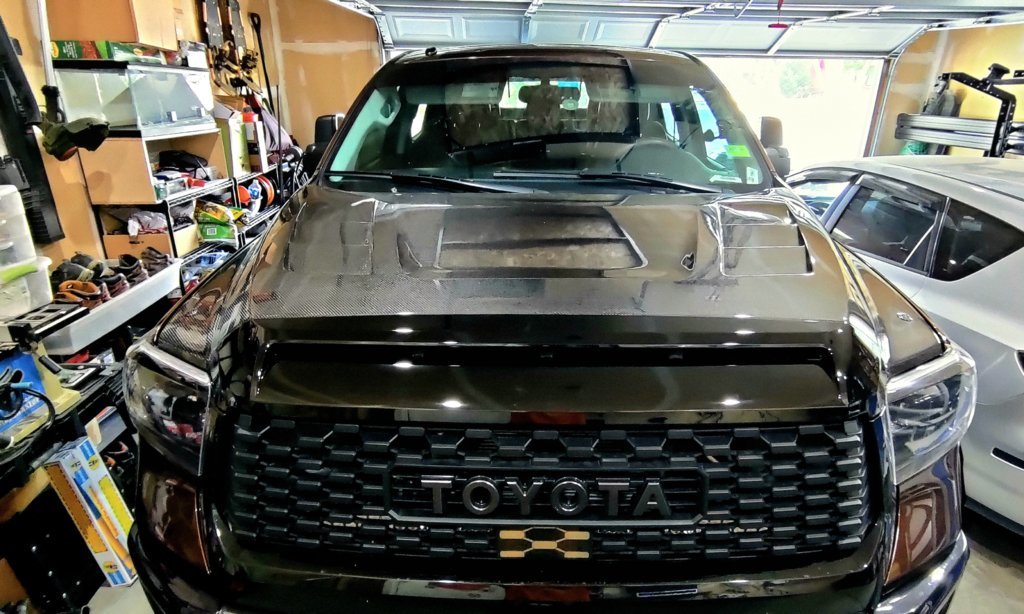

    Nice! How much weight savings are you expecting with the full set + hood?

    Hood will be a big difference. Fenders definitely lighter than oem and a little bit lighter than the current fiberglass.
